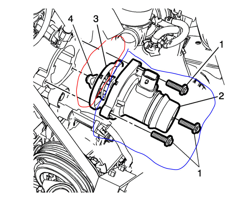

Sometimes when I start it in the morning and sometimes when I drove for over 30 km. I replace the thermostat with genuine part. The code was clear with machine and it still throws the code. When it happens, the car loses power and after a while it get better. I don't know what to do. Please give advice.

The code, 89, isn't listed in the manuals, but I have heard others speak of it related to the thermostat. When the thermostat was replaced, did they also replace the thermostat housing? This thermostat is electronically controlled, and from what I gather, the electronics in the housing go bad.
Take a look at the attached pic. I circled the thermostat in red and the housing in blue. Were both components replaced?
Let me know if you have had the computer scanned with a scan tool. If so, let me know what P code was found.

Yes, both components were replaced. A computer scan was done, but no problem codes were detected.

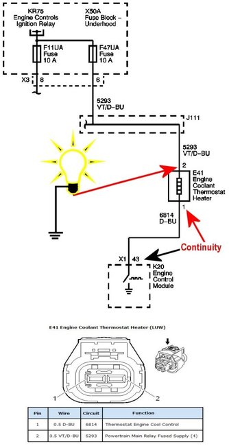

Hi, Ada. Since you only have the 89 code, at this point, I would check the electrical components related to the electronic thermostat items. I am going to provide the directions, but it does require a scan tool that can actuate different components.
_____________________________
DIAGNOSIS:
See pic 1
1. Disconnect the harness connector at the E41 Engine Coolant Thermostat Heater. Ignition ON, verify a test lamp illuminates between the ignition circuit terminal 2 and ground.
- If the test lamp does not illuminate, repair the open or shorted circuit and retest.
- If the test lamp does illuminate, proceed to the next step.
2. Using a capable scan tool command the E41 Engine Coolant Thermostat Heater to 100%. The voltage should transition from 2.5–3.5 volts when commanded to 10% to less than 0.1 volt when commanded to 100%.
- If the circuit voltage does NOT correspond to the specified values and the circuit is ok, replace the K20 Engine Control Module.
- If the circuit voltage does correspond to the specified values, replace the E41 Engine Coolant Thermostat Heater.
I wish I had an easy answer, but replacing the components indicates a different issue. That is where the diagnostics need to come into play.
Let me know if I can help in any way or if you have other questions.
