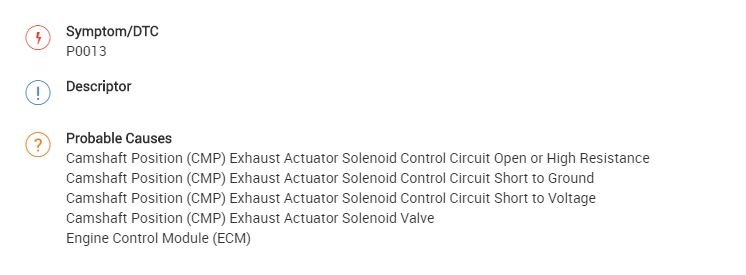

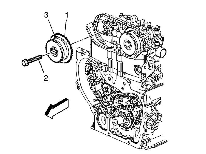

It's Joe again. It's easy to make that mistake. Listen, if it is a P0013, it is related to the exhaust camshaft position sensor. Let me know what the symptoms are (if there are any).
DTC P0013
- Exhaust Camshaft Position Actuator Solenoid Valve Control Circuit
Let us know what you find.
Feb 27, 2020 at 12:25 PM

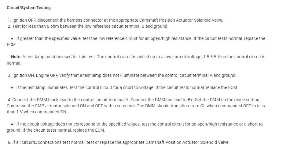

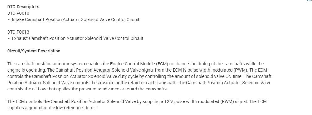

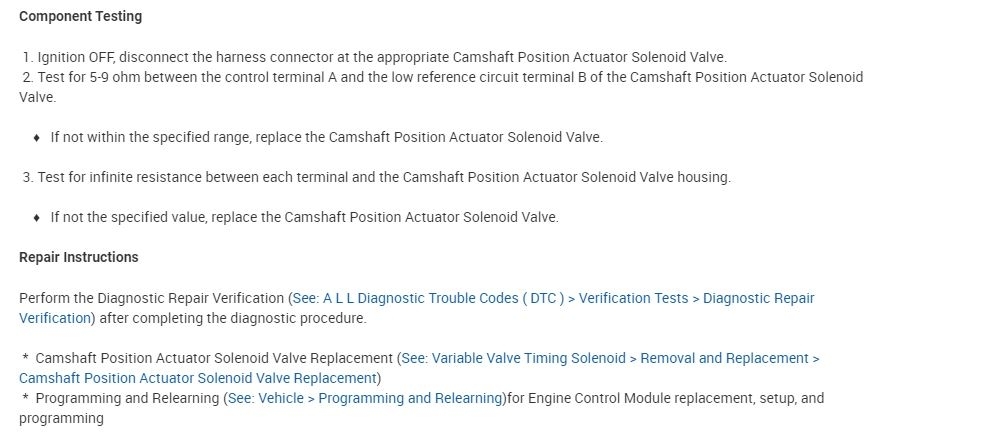

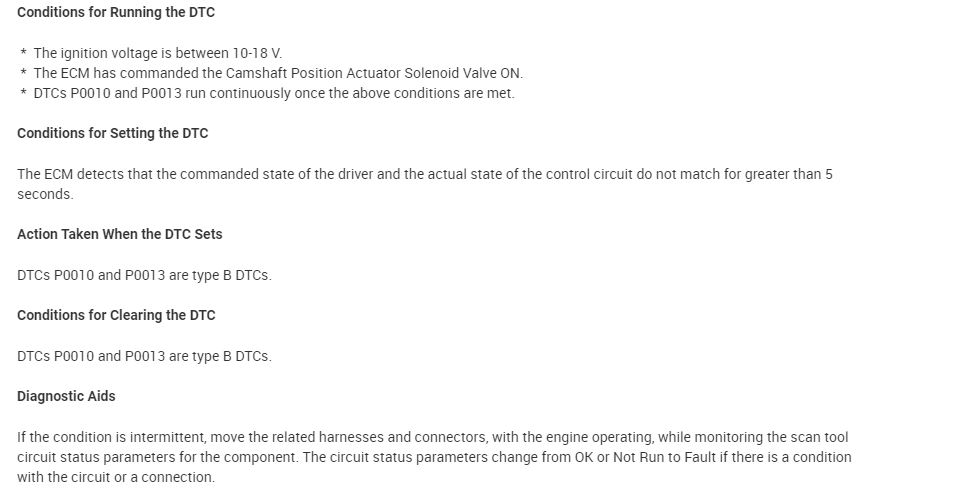

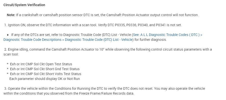

Okay, this code looks to be electrical from the looks of the diagnostics. It could be a connection at the solenoid but needs to be confirmed.
It also could be from a timing chain that is stretched as well.
I attached the description and testing required for the code. It is not an easy code to fix. The failure must be identified before replacing anything.

You need to follow the flow charts I attached. Did you check them?
Feb 28, 2020 at 7:57 AM
