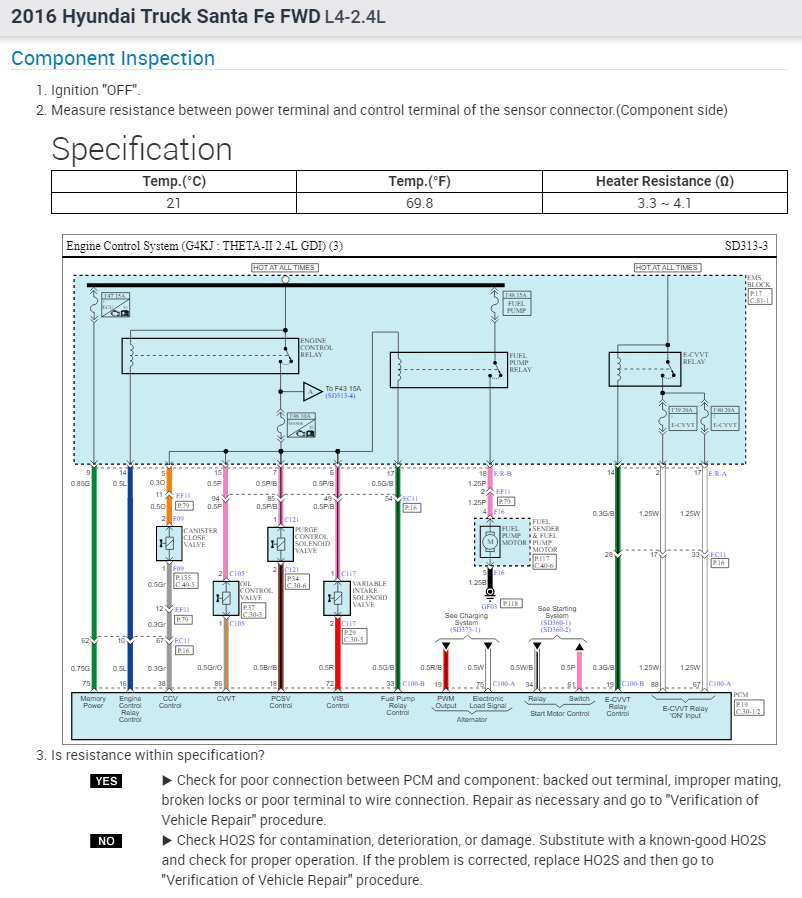

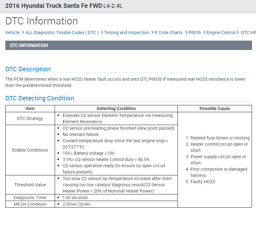

code p0036? How do I fix it?
Oct 23, 2022 at 8:01 AM
SQM
  • 6,383 POSTS
The code P0036 - Heated Oxygen Sensor (HO2S) Control Circuit (Bank 1 Sensor 2).
This can get triggered due to faulty oxygen sensor. It can also be due to faulty wiring circuit for the sensor.
I have attached the diagnostics for the code below.
Let me know if you have any questions.
https://www.2carpros.com/articles/how-to-test-an-oxygen-sensor-02-sensor
