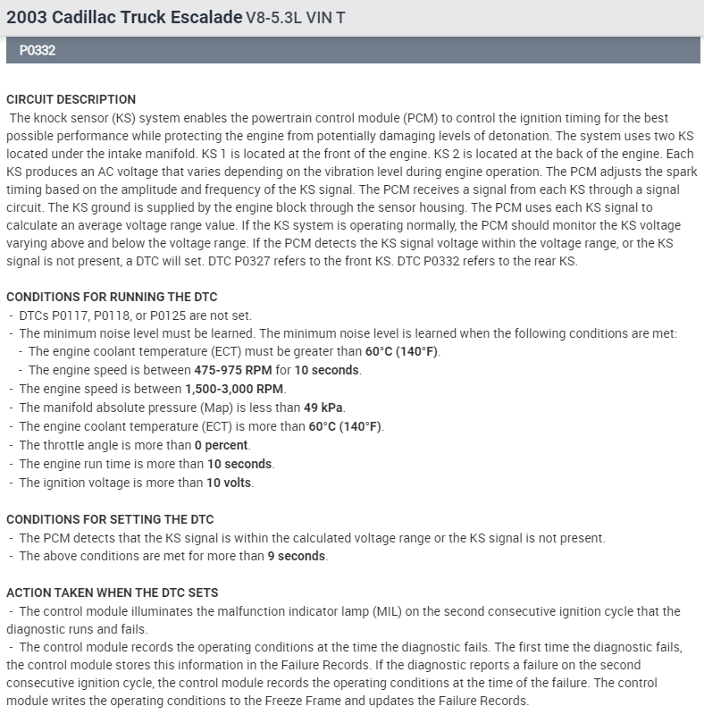

code p332?
2003 CADILLAC ESCALADE
202,000 MILES • V8 • 2WD • AUTOMATIC

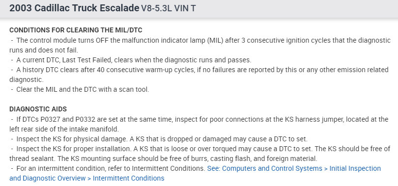

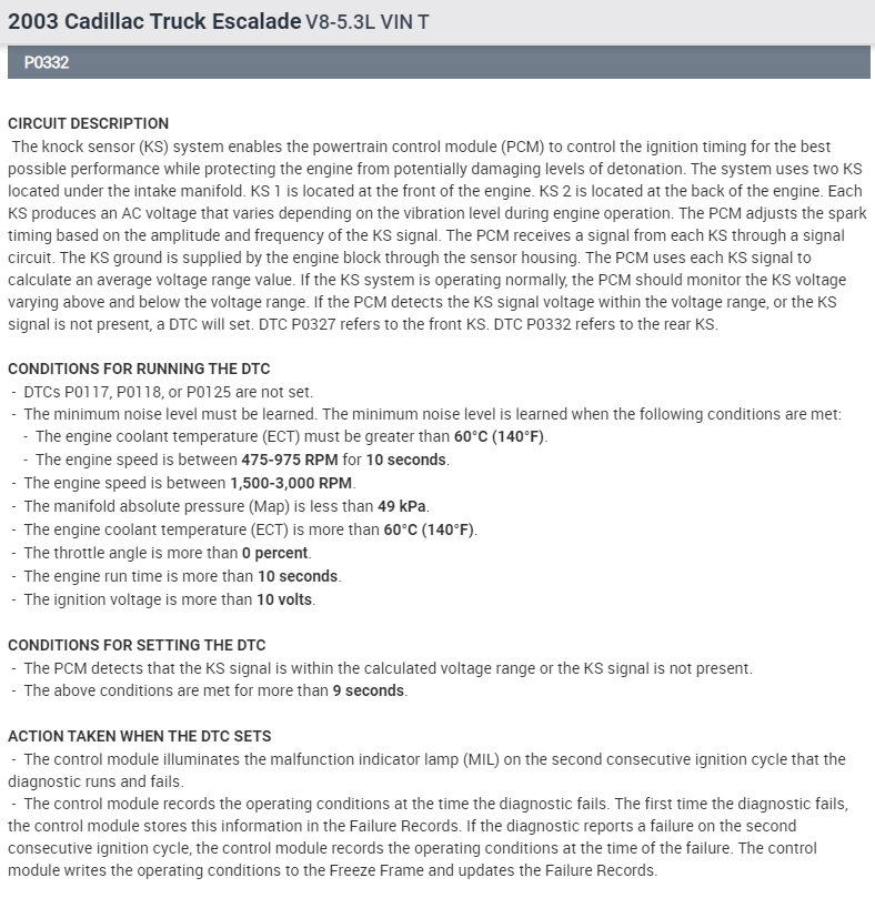

The code P0332 Knock Sensor 2 Circuit Low Input.
This usually happens due to faulty knock sensor, wiring for the sensor. It can also be due to an issue with the PCM.

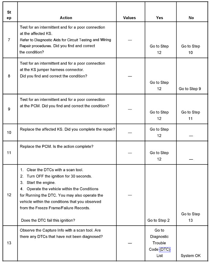

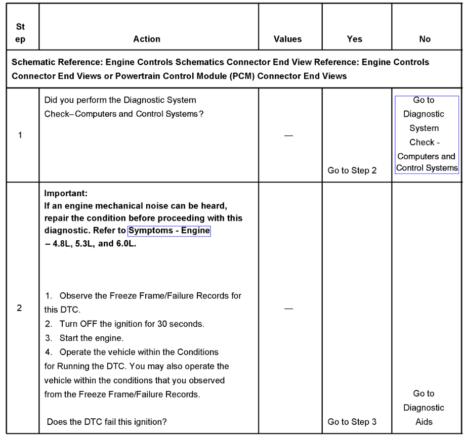

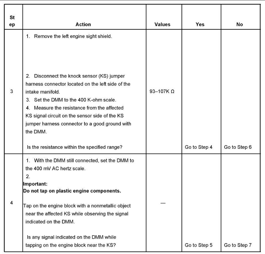

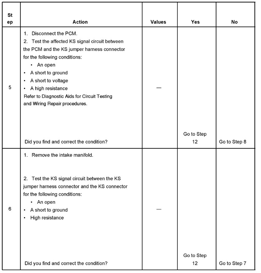

I have attached the diagnostics procedure for the code below.
Let me know if you have any questions.
