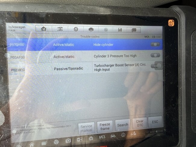

code P03AF and P0238?
142,000 MILES • 1.8L • TURBO • AUTOMATIC
BHAMDOC1
  • 423 POSTS
If this is the sensor in the boot i removed which goes frim throttle to the air cooler then i cleaned it before i installed it because the hose had some oil in it. Not sure about the other codes or why they popped up. Its one thing after another. Code p03af
Jul 3, 2026 at 8:29 AM
  • 55,711 POSTS
Yes, the sensor in the charge-air hose between the intercooler and throttle body is likely the boost/MAP pressure sensor related to P0238.
P0238 — Turbocharger boost sensor “A” circuit high
P03AF — Cylinder 3 pressure too high
If you cleaned the sensor it can be damaged now, I would replace it and then clear the codes. Let me know what you find.
Jul 4, 2026 at 7:28 AM
BHAMDOC1
  • 423 POSTS
I replaced the sensor and took it for a hort drive it was fine. Next day drove it to the gym 7 miles was also ok. Then from gym to the tire place down the street and it hesitated/shuttered once and epc light cane on then stayed on and everything was back to normal. No limp mode, drive fine. Not a transmission shudder. Finished from tire place started the car and epc was off. Got home and scanned it there is nothing stored, pending or permanent
