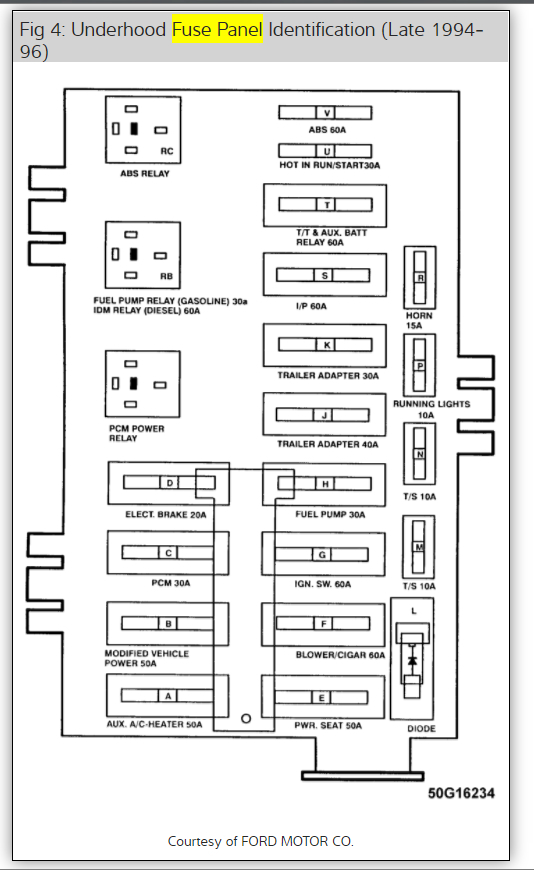

E4OD is transmission shifting rough. Code 452, 632 from KOEO/KOER. I cannot find a VSS on the transmission. There is a hole for one that is plugged and not used on the transfer case. My speedometer works fine. Is the PCM getting its VSS signal from the rear axle VSS? Would the speedometer not stop working then?

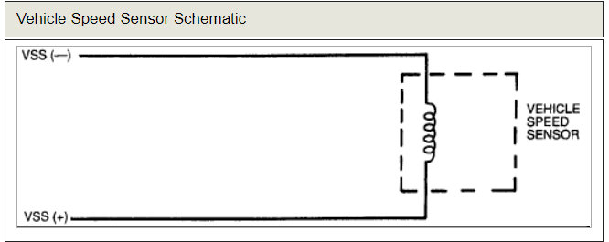

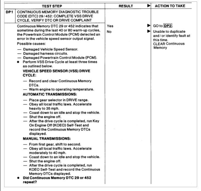

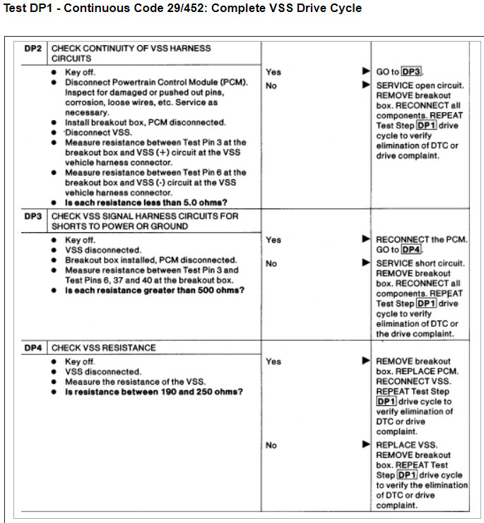

The PCM gets its signal from the transmission/transfer case output shaft speed sensor. Here is a test guide to check out the performance of the sensor.
Please run this test and get back to us.

My van has a Quigley 4wd conversion. My manuals for the unconverted van show no second VSS (only the one on the rear diff). The manual schematics show the rear diff VSS signal passed to the PCM through the PSOM modual. As I mentioned before, the hole for one near the ouput shaft is plugged; no sensor. There is a sensor on the transfer case (it's a Borg-Warner 1356 I believe) that was installed by Quigley but the Borg-Warner documentaion shows this sensor to be a 4wd indicator light. Is it possible that the indicator light sensor was replaced with a VSS? The speedometer stops working if I disconnect the VSS on the rear diff so there must be a second one somewhere but the only thing I can find is the sensor on the transfer case. Is there a way to determine if it is a 4wd indicator switch as opposed to a VSS?

There might not be a second VSS sensor, they can be using the signal sensor to run the system which is what I suspect. Is your van obd2 or 1?

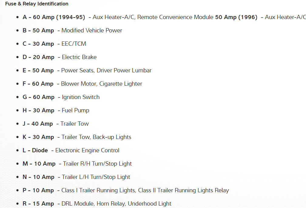

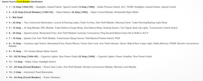

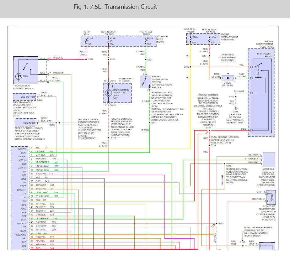

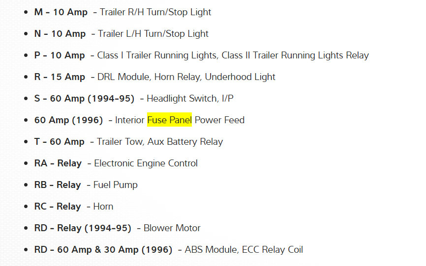

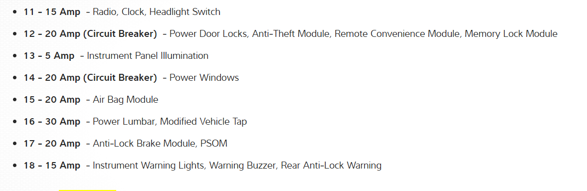

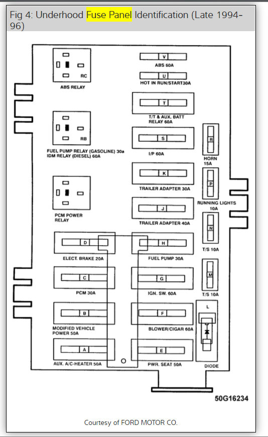

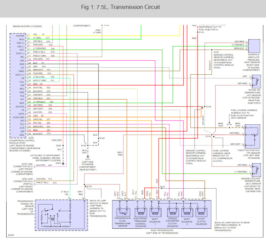

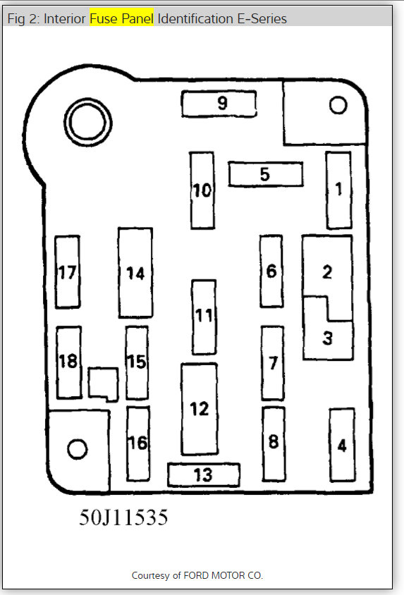

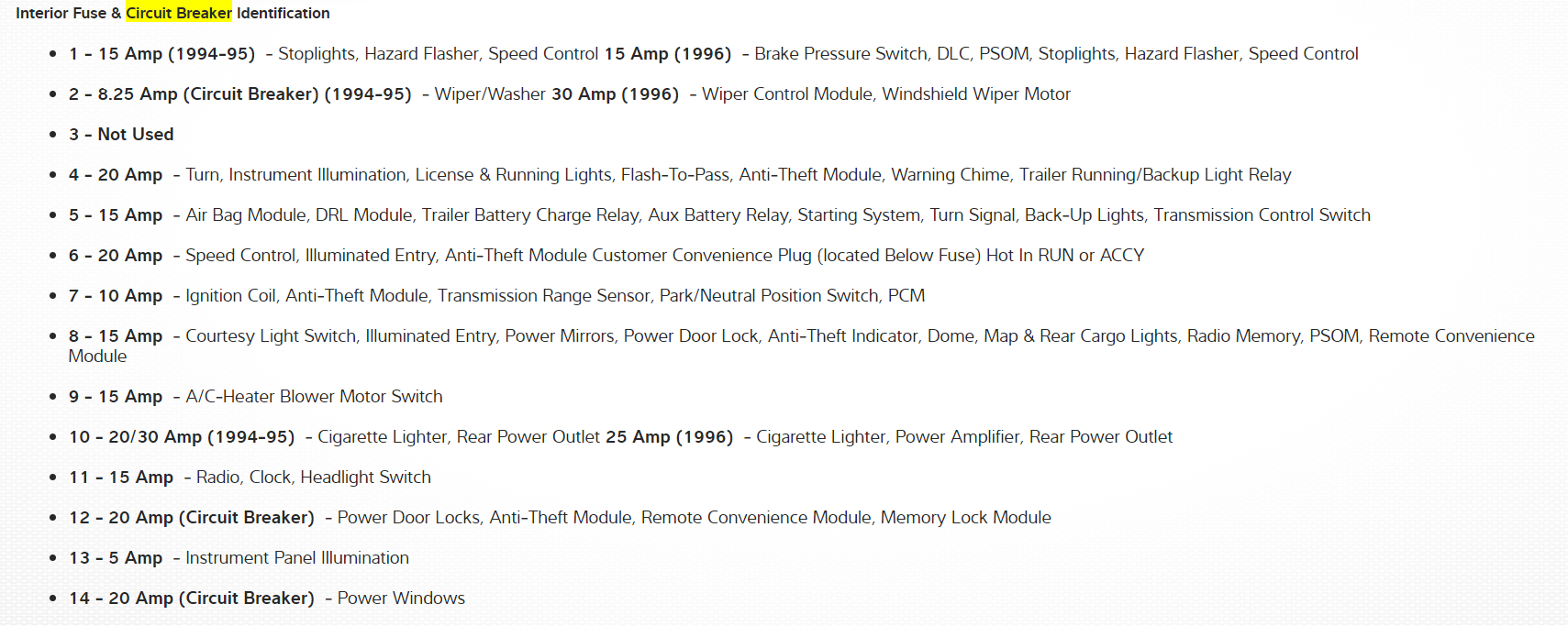

Here are the transmission and VSS wiring diagrams and it looks like there is a few fuses that should be checked before we got further.
#1, 5, 18, U and C Here is a guide
If the fuses are okay check the wiring here is a guide and the wiring diagrams (Below)
