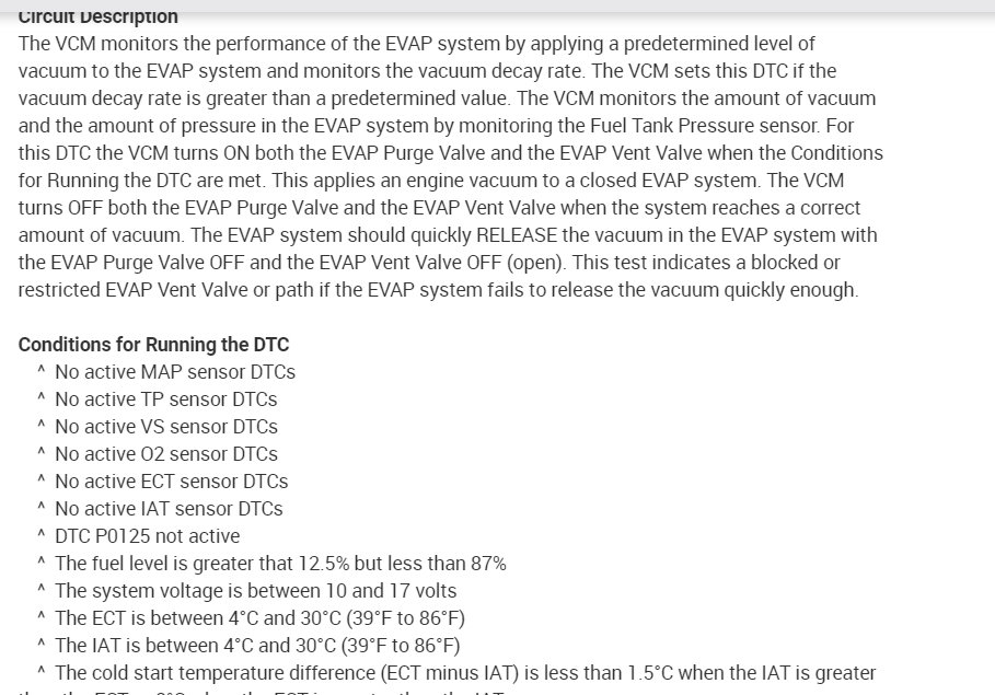

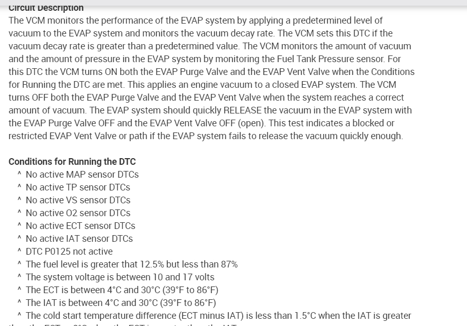

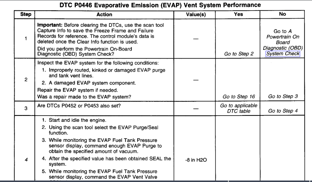

Intermittent start and stall. Sometimes get a little bit of chugging at acceleration. Need to know if it is purge valve. I don't think I'm having issues with the vent because no problems fueling. At a loss here.
May 14, 2019 at 2:04 AM
SCGRANTURISMO
  • 4,897 POSTS

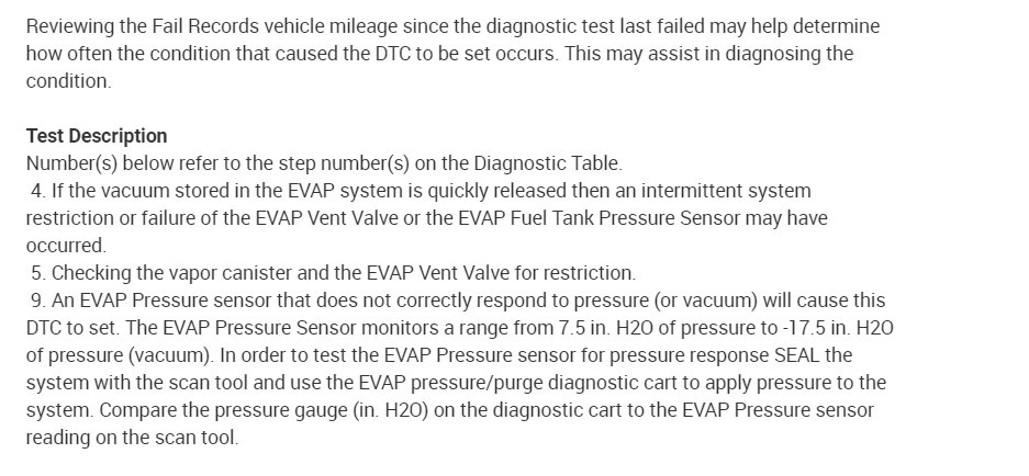

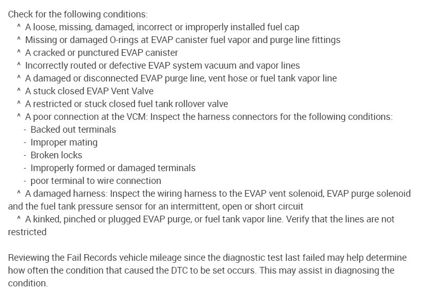

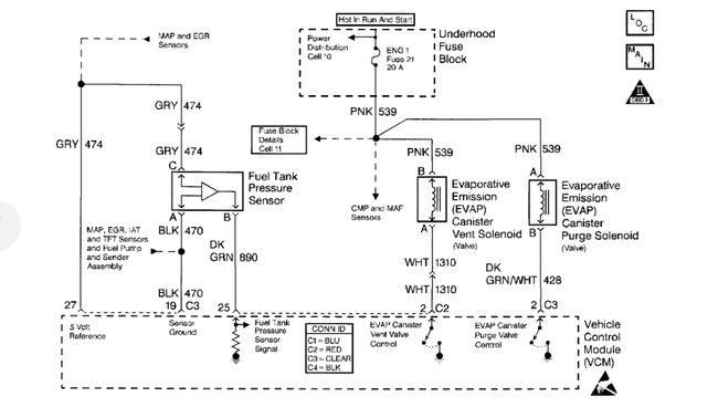

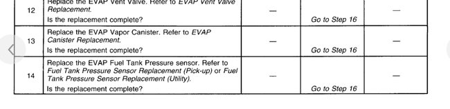

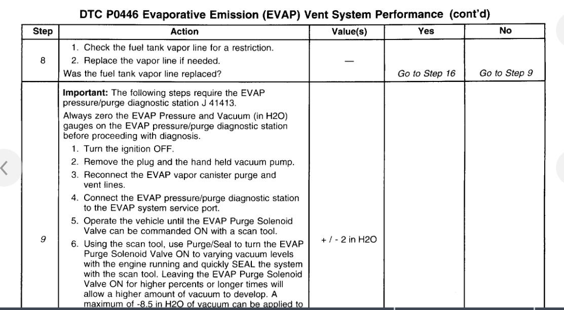

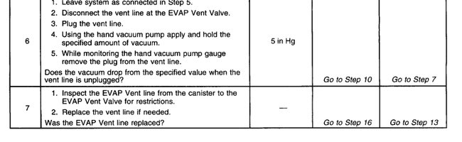

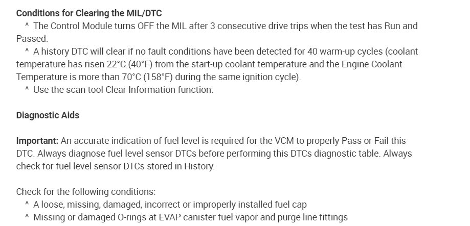

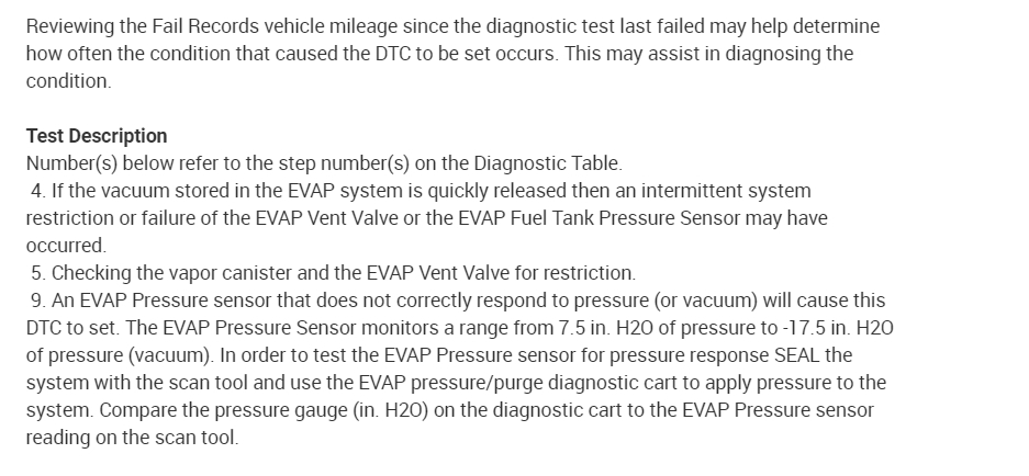

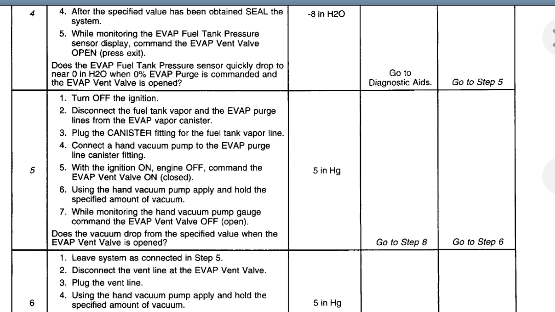

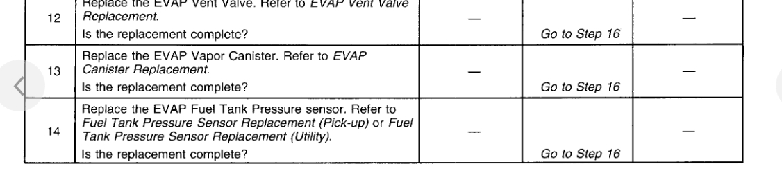

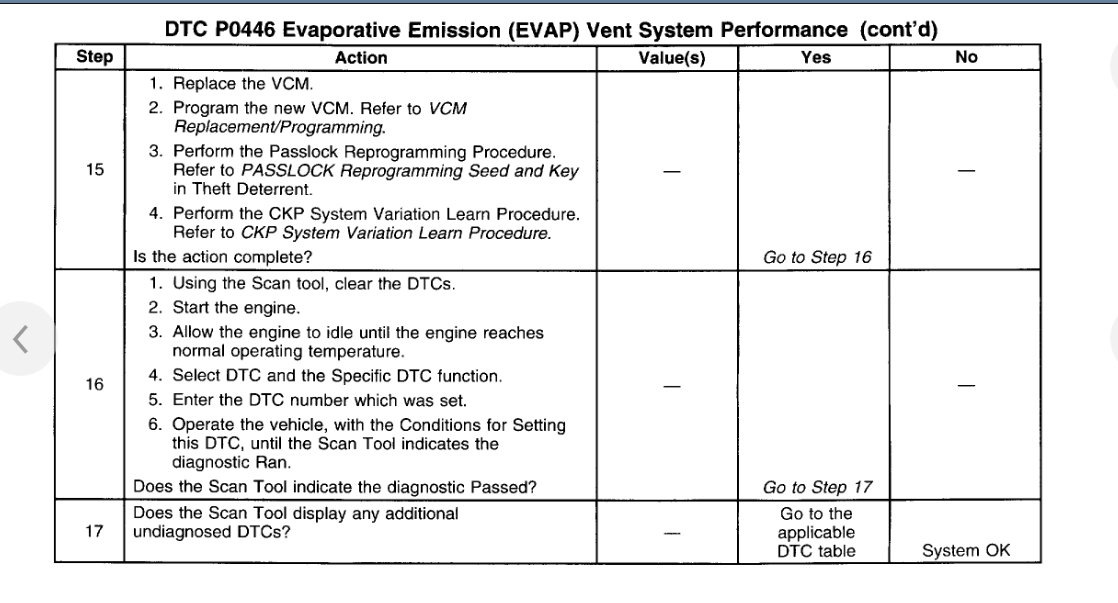

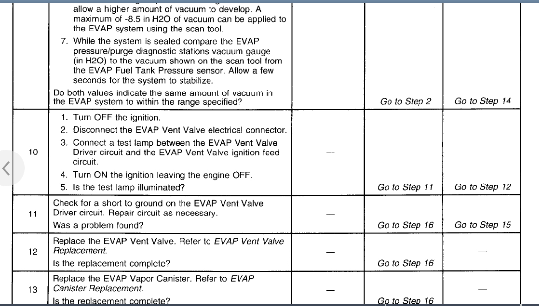

Direct Trouble Code*DTC) P0446 does indeed deal with the evaporative emission system (EVAP) of your vehicle. I have included for you in the diagrams down below a factory troubleshooting flowchart that will pin down the exact cause of this DTC for you. Please go through this guide and get back to us with what you are able to find out.
