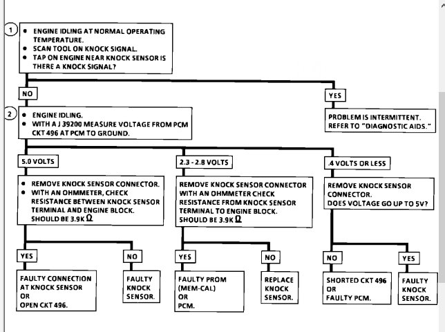

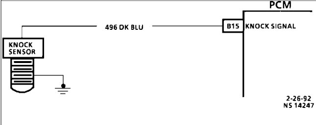

I have had the knock sensor replaced which is on the block next to starter. put a meter on it after, but still the check engine light comes on and as well as code 43. i have tried everything.
Mar 28, 2019 at 4:51 AM
SEVAG P
  • 405 POSTS
Hello thanks for using 2CarPros.
For the fault code 43 it seems you have wiring issue because you already replaced the sensor, check fig 1 for trouble shooting, and fig 2 to check the wire from engine management to knock sensor.
