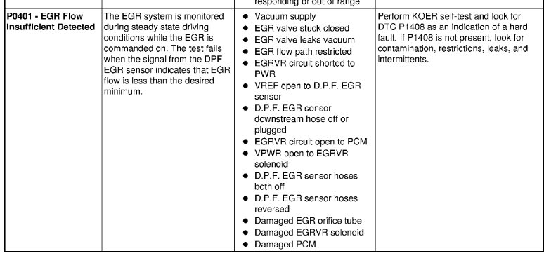

I have changed pressure sensor, EGR valve, EGR solenoid. I'm still getting a code but car runs great. I don't know what else there is. I've also checked all hoses for leaks found none.

I've attached below a few more things for you to check regarding the code P0401. Hope this helps and thanks for using 2CarPros.

Thanks, I only saw a couple thing I haven't tried yet.
