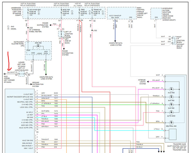

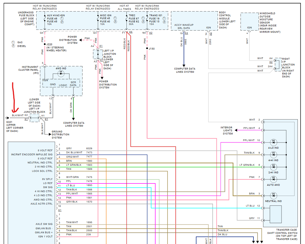

Getting this code along with the service 4wd. When shifting from 2h to auto it blinks and takes 20 seconds before switching. It goes to 4h and 4lo faster. I can hear encoder motor click but after watching scanner live data the front axle never engages. I replaced front actuator with gm oe part and didn’t help. Tested actuator at connector and it’s not getting power. Also not getting power at midway point near fuse box. Pulled harness from midway point to actuator and removed plastic covering and found no damaged wires and both connectors looked fine with no corrosion. Wondering if it’s a grounding problem or a damaged wire between the tccm and the mid point connector or just a failing tccm? New parts include tc encoder motor, front actuator and ignition switch. Checked and cleaned as many grounds as I could but I’m sure I’m missing a few. What grounds would be most relevant for my problem? Also when I watched scanner live date you could see that the command was given to go from 2h-auto-4h-4lo but it would never say engaged on front axle. Not sure where else to turn unless it’s replacing tccm.

This is a good one, based on your testing, I’d be chasing an open power/control circuit between the TCCM/fuse block area and the midpoint connector, or a bad TCCM ground/connector terminal, before replacing the TCCM itself. I have seen the switch cause this problem as well. Here is a guide to help you check the wiring and the transfer case system wiring diagrams so you can see which fuses to check for power as well.
C0379-04 often points toward an open/high-resistance type fault. If the circuit is open, the TCCM may command engagement but never see current flow or axle feedback.
https://www.2carpros.com/articles/how-to-check-wiring/
I marked the grounds you need to check on the diagrams. Check out the images (below). Please upload an image or a short video in your response, so I can see what's going on.

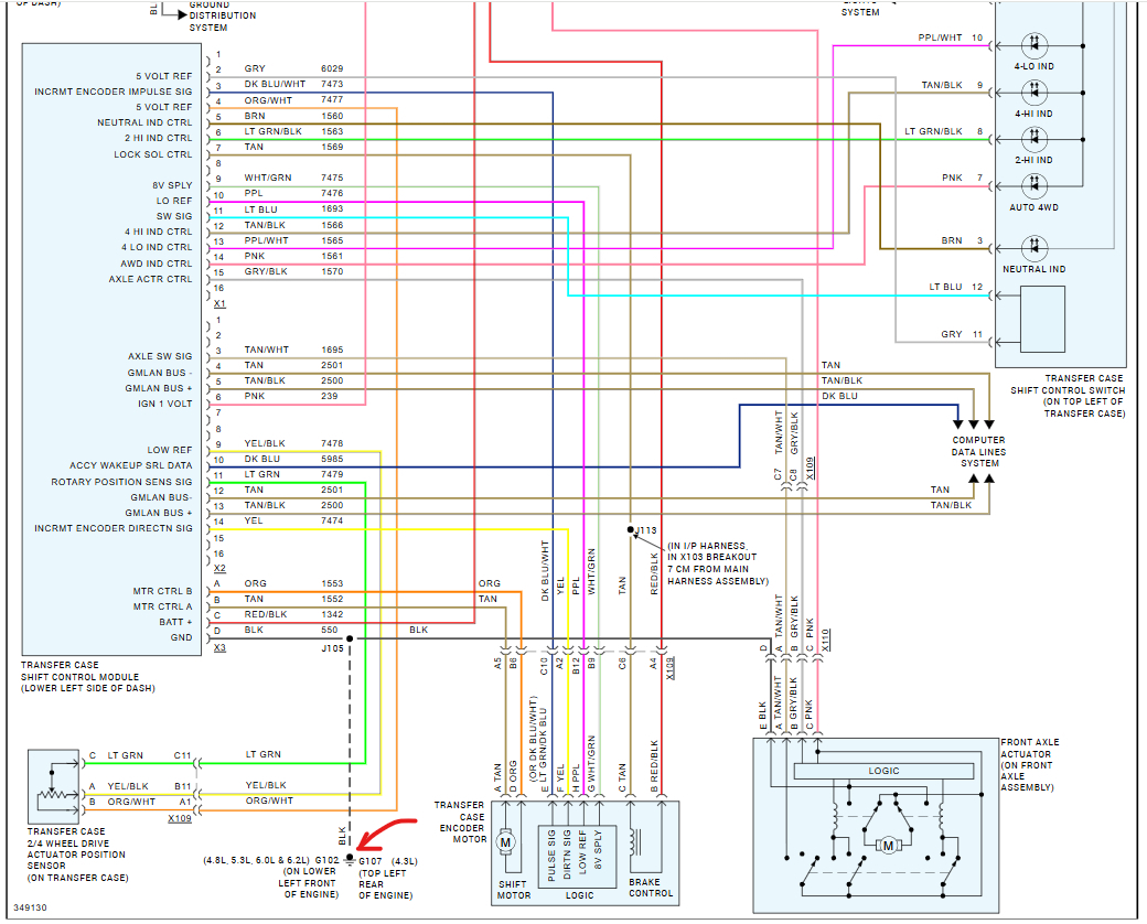

So I would check the wiring to the front differential, I has another user find the wiring harness rubbed through there, there is a TSB on it. You can safely check for power using a test light, this guide will help you.
https://www.2carpros.com/articles/how-to-use-a-test-light-circuit-tester/
With the system on, check the pink wire at eh front diff actuator and the red/blk wire at the transfer case actuator. Let me know what you find.

The wiring from the midway connector to actuator looks good unless there is an internal break somewhere. Both connectors look good with no corrosion. I have tested the front actuator pink wire with system on and showed nothing. Also showing no voltage at midway connector. I looked at wiring diagram so I want to test if tccm is even sending power towards actuator when commanded or maybe a continuity test on the 3 wires from tccm to the midway connecter. I know you mentioned transfer case wires do I need to be checking them. What is the most important test I can do to determine if this is a tccm output issue or a broken wire-ground issue?

You found the problem, if the pink wire does not have power with the truck on then please check the fuse "TRANS IG1" in the fuse panel under the hood. This fuse supplies power to the actuator.
P2534 — Ignition Switch Run/Start Position Circuit Low Voltage
and
P0700 — Transmission Control System Requested MIL
These can be caused by a bad ignition switch which will cause all of your problems but lets see if the TRANS IG1 fuse has power first.
