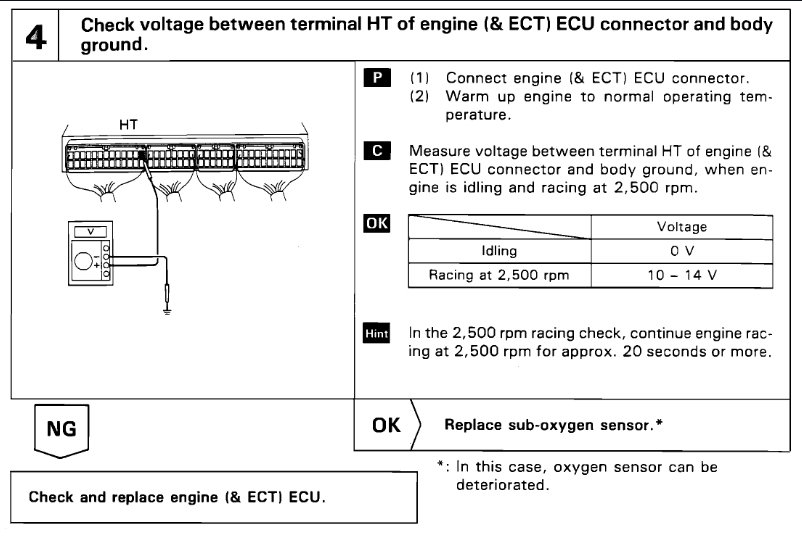

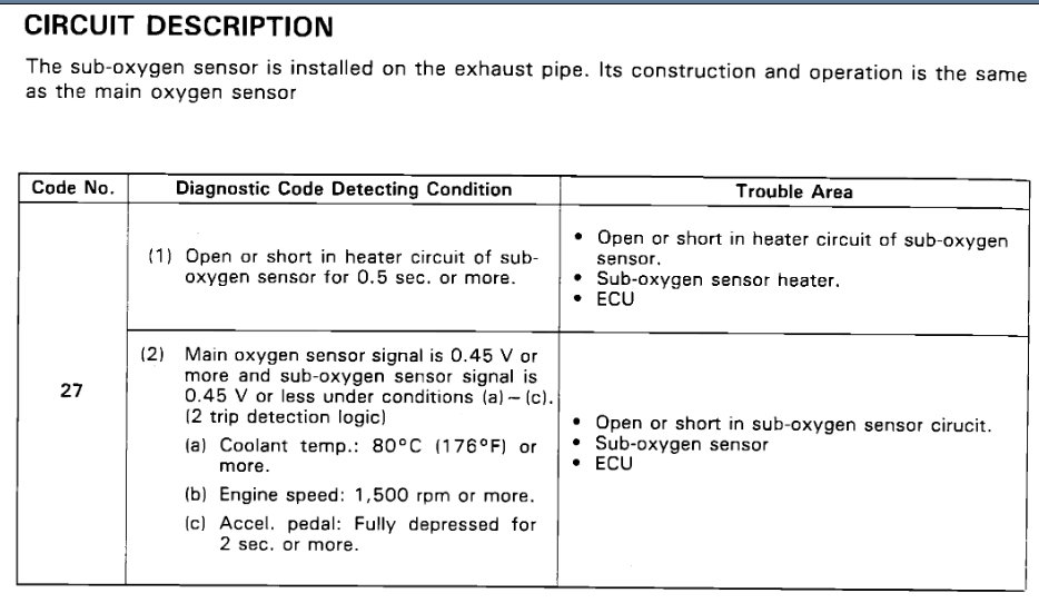

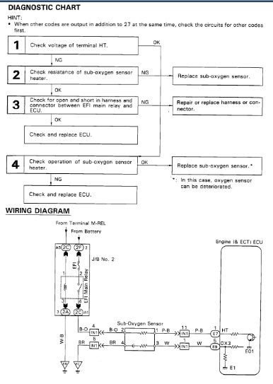

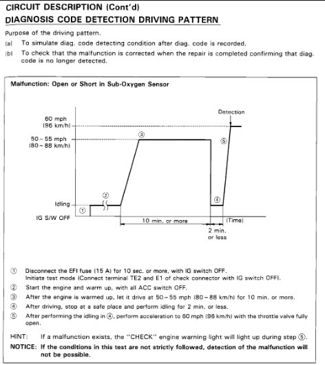

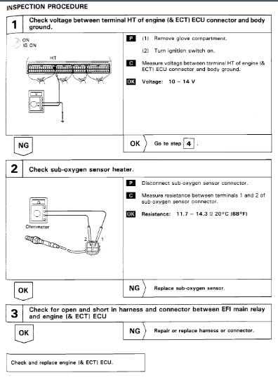

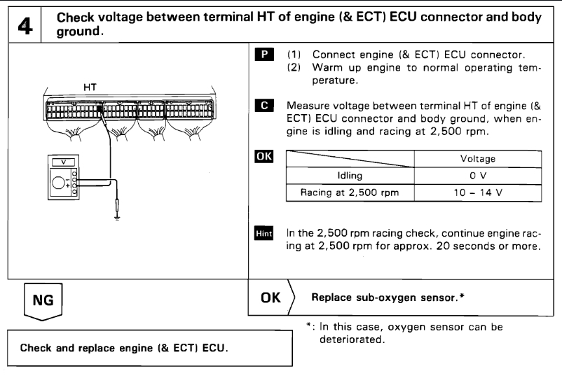

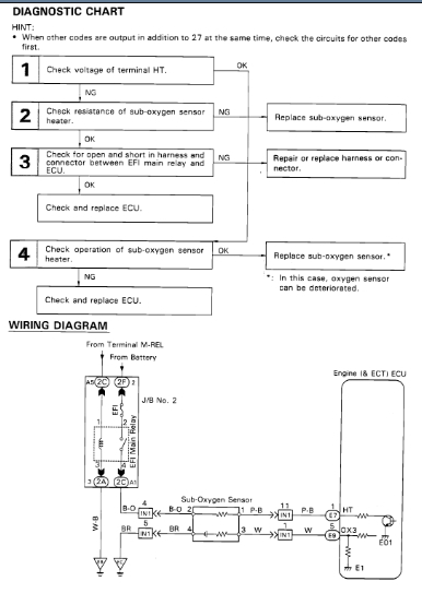

I just bought the car went to have it smogged It runs great motor looks like new, but it did not pass the emissions. Gross polluter. I pulled the code myself it's 27 sub oxygen sensor that's the only code. so should I change the oxygen sensor that's after the catalytic converter? will that fix it or could it be the catalytic converter itself?
Jun 3, 2020 at 9:04 PM
DANNY L
  • 5,648 POSTS
Hello, I'm Danny.
I've attached diagnostic steps below for Code 27. Here is a tutorial showing what's involved in an 02 sensor replacement:
https://www.2carpros.com/articles/how-to-replace-an-oxygen-sensor
Hope this helps and thanks for using 2CarPros.
