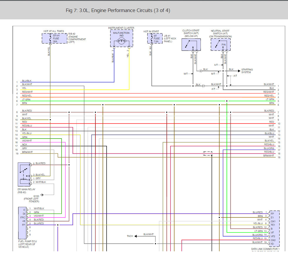

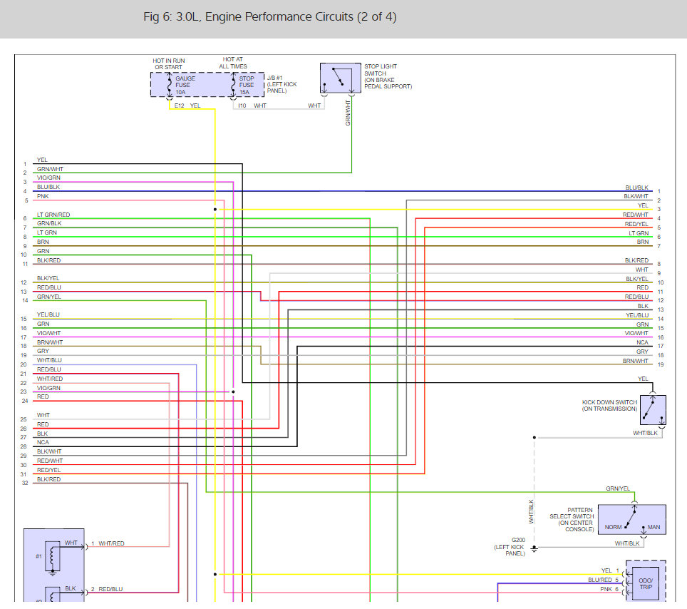

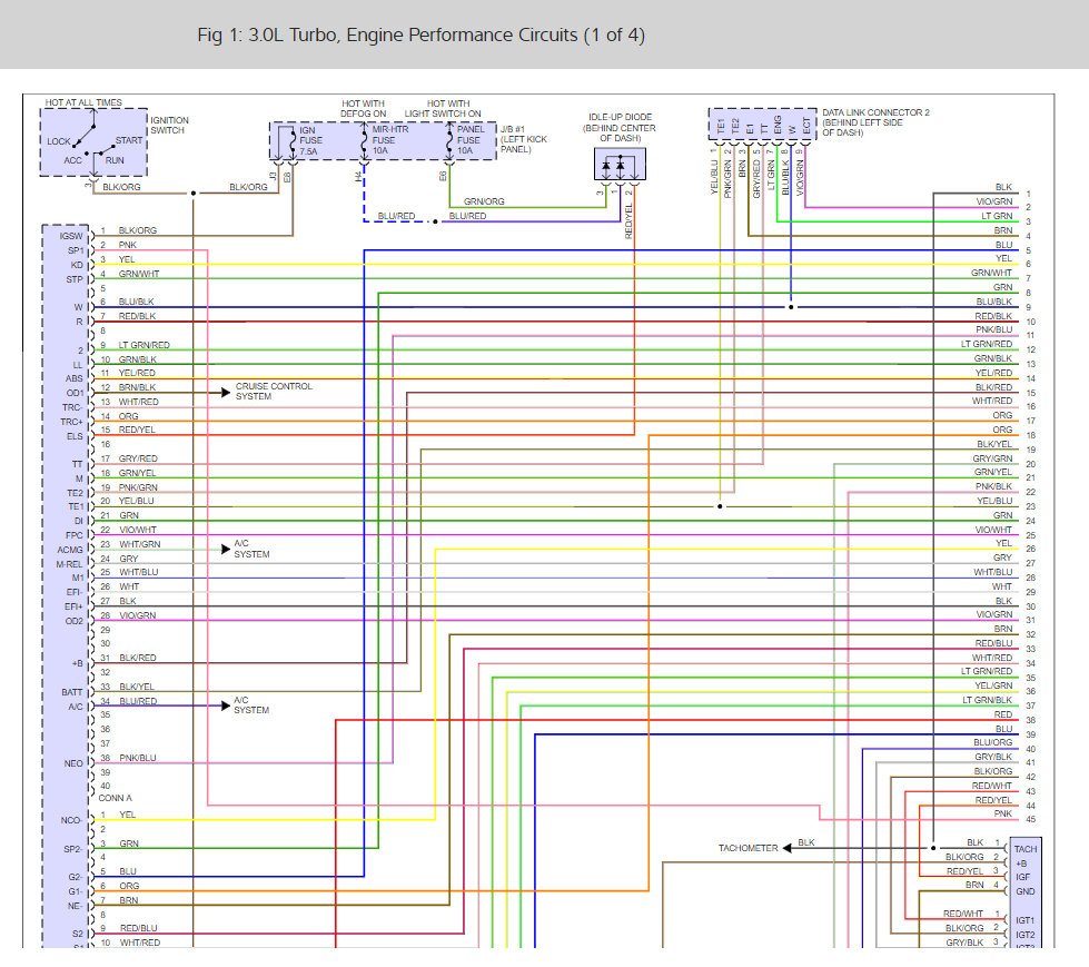

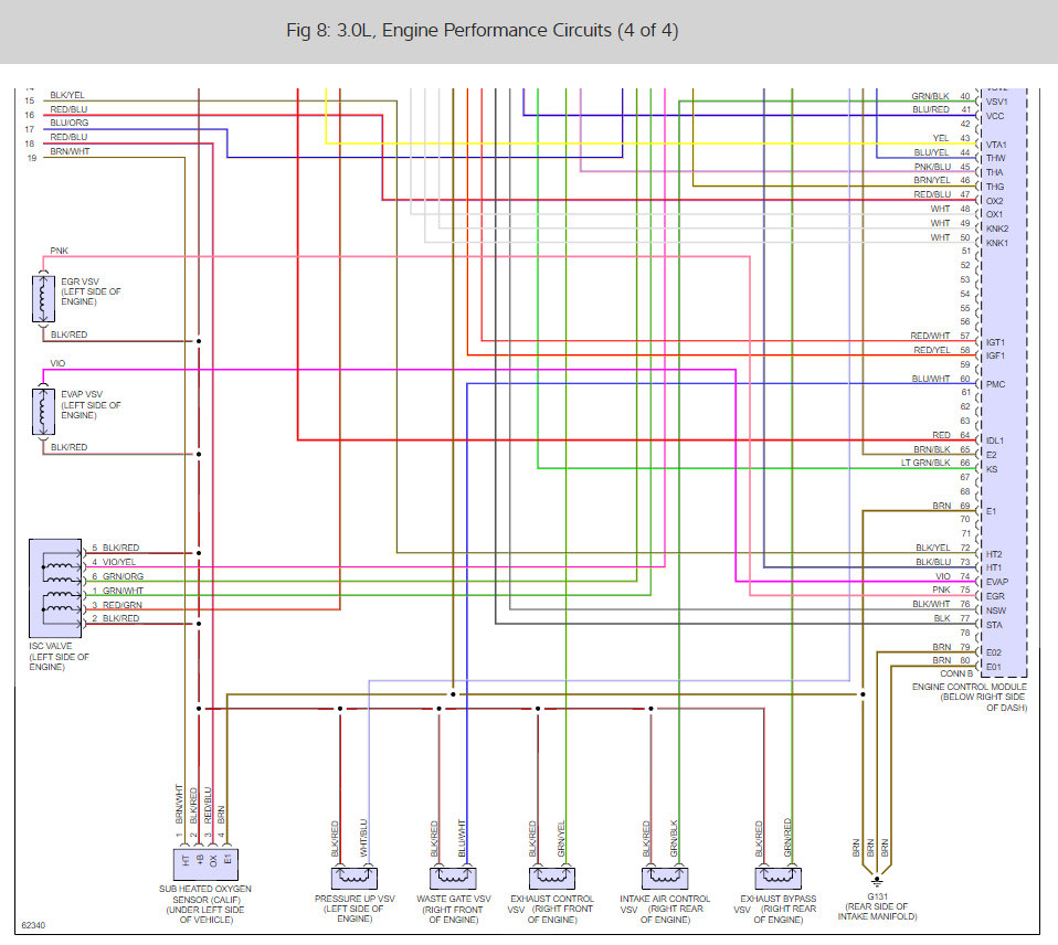

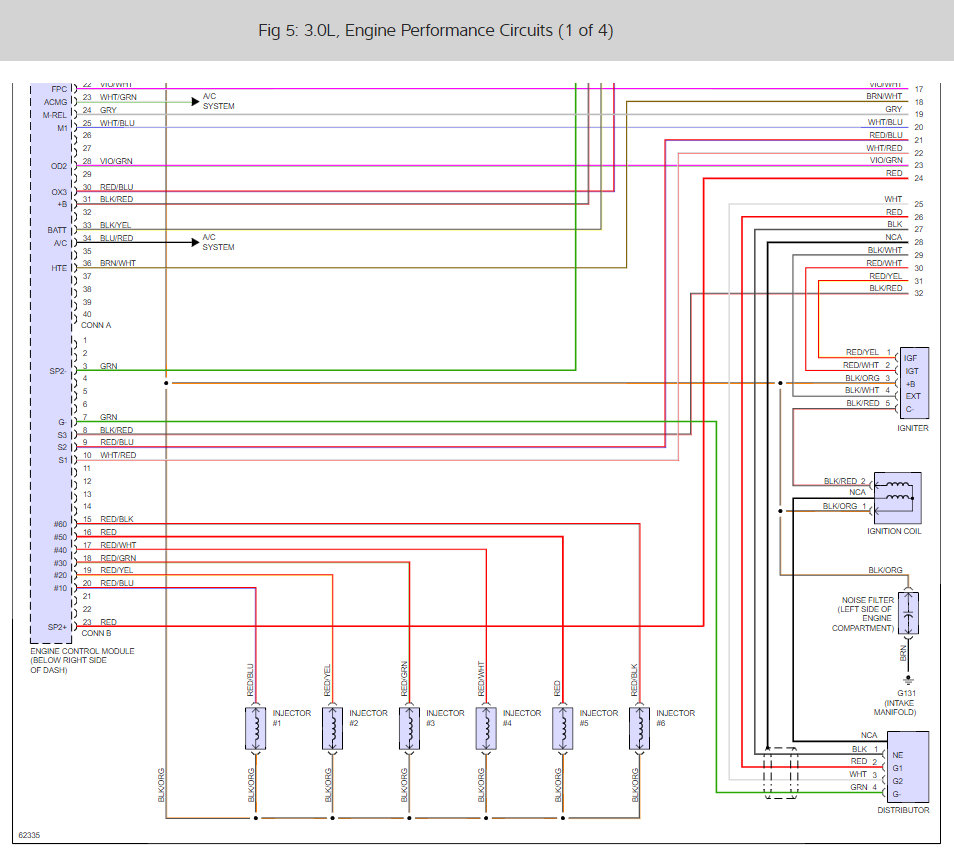

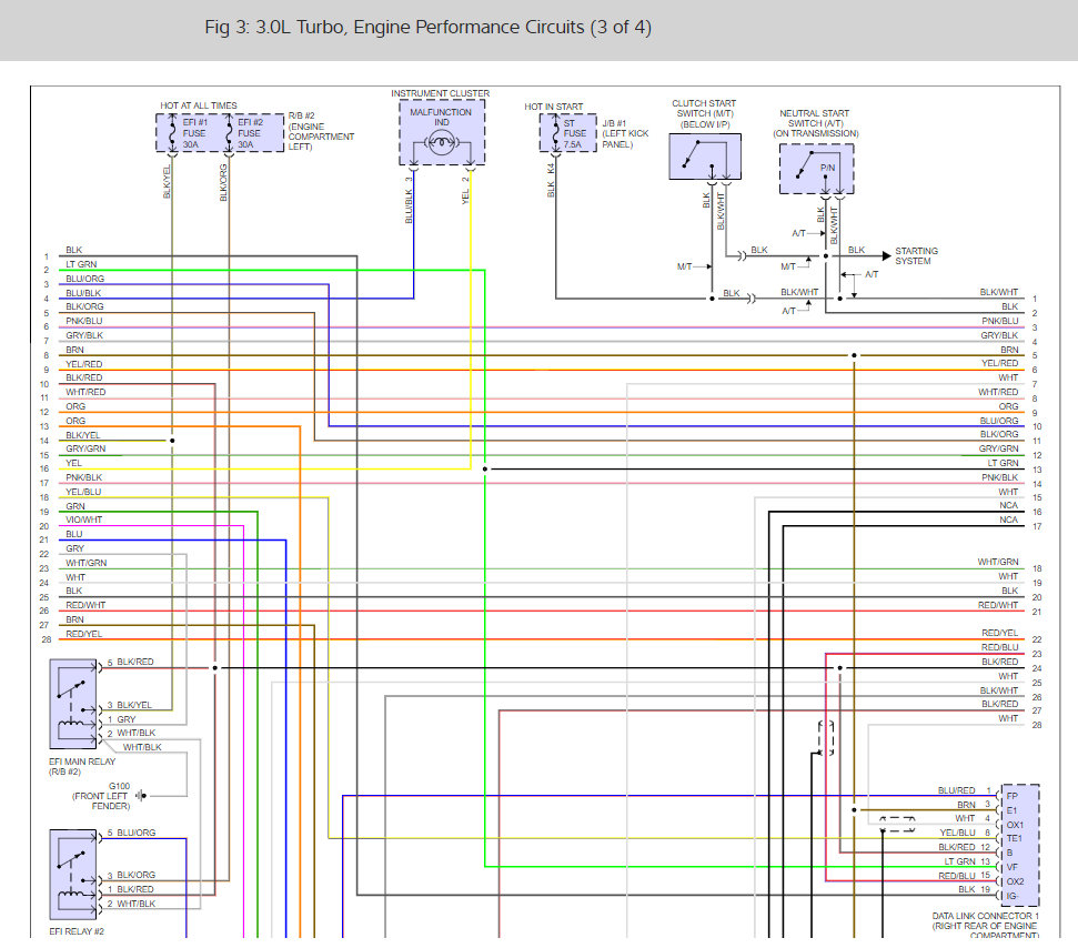

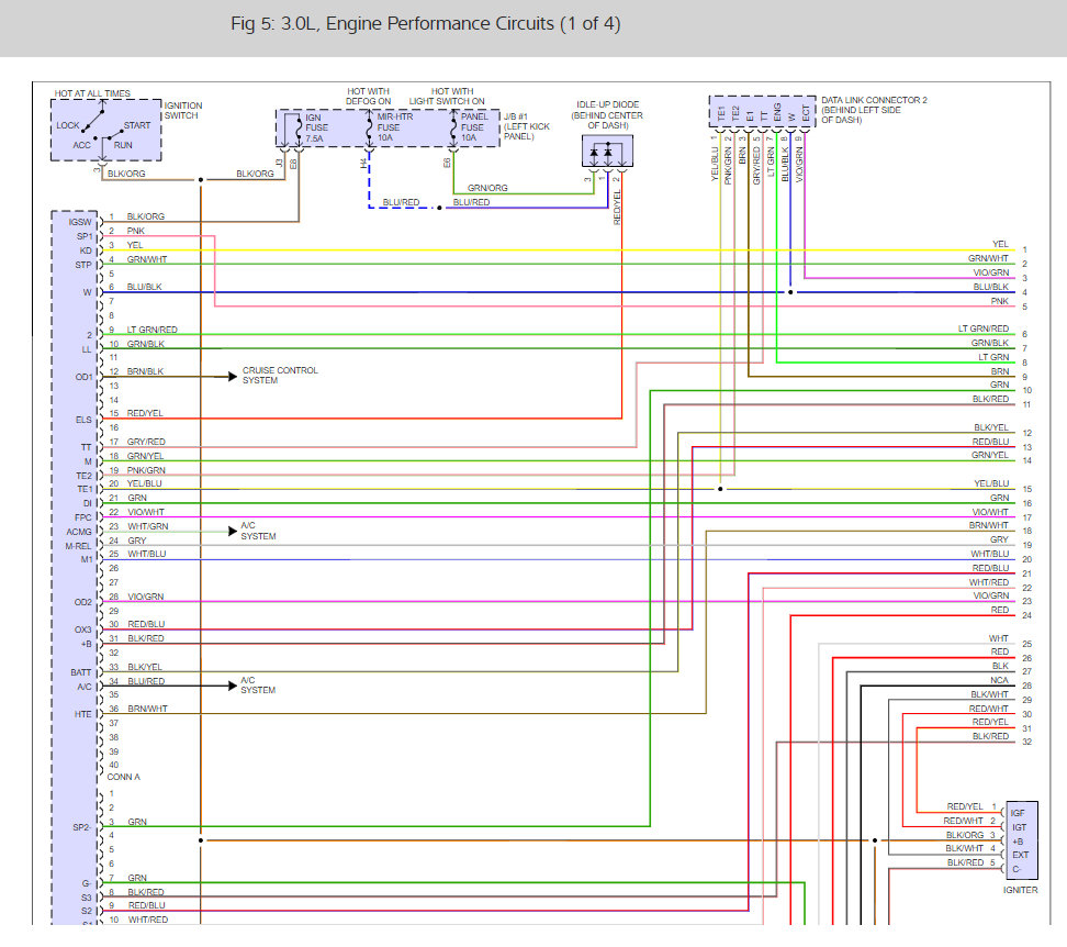

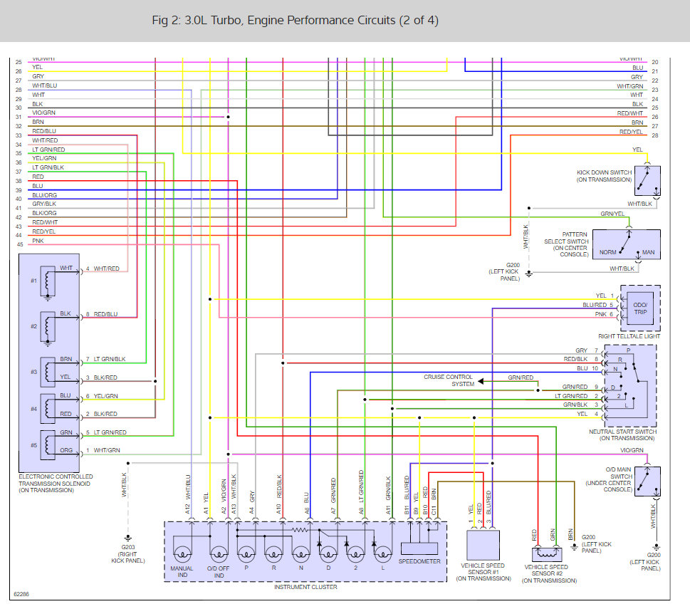

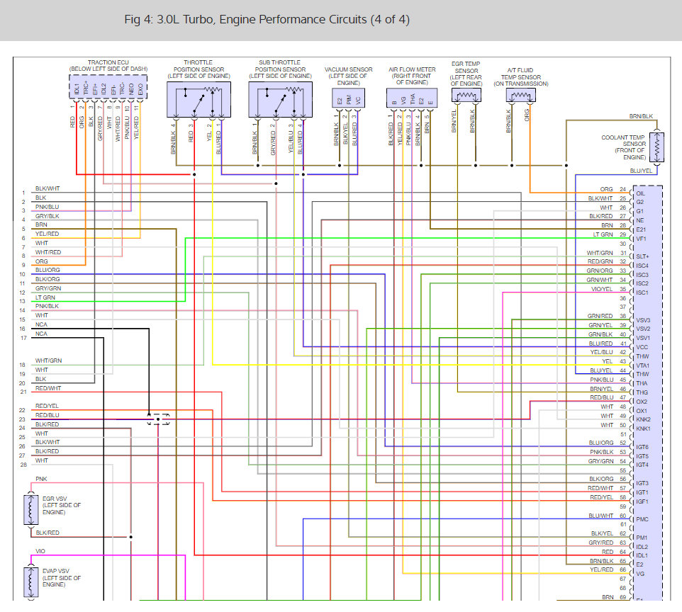

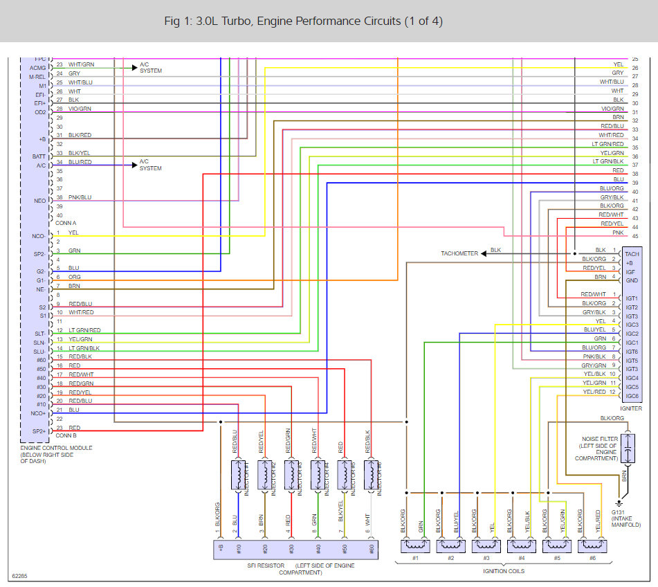

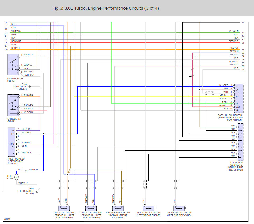

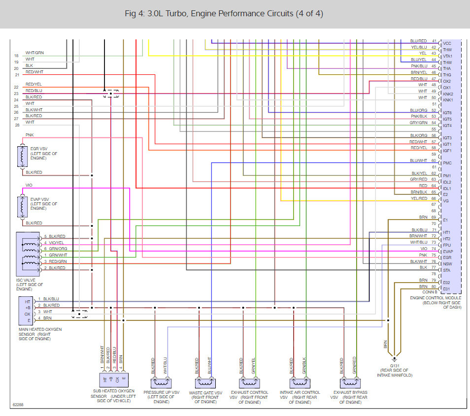

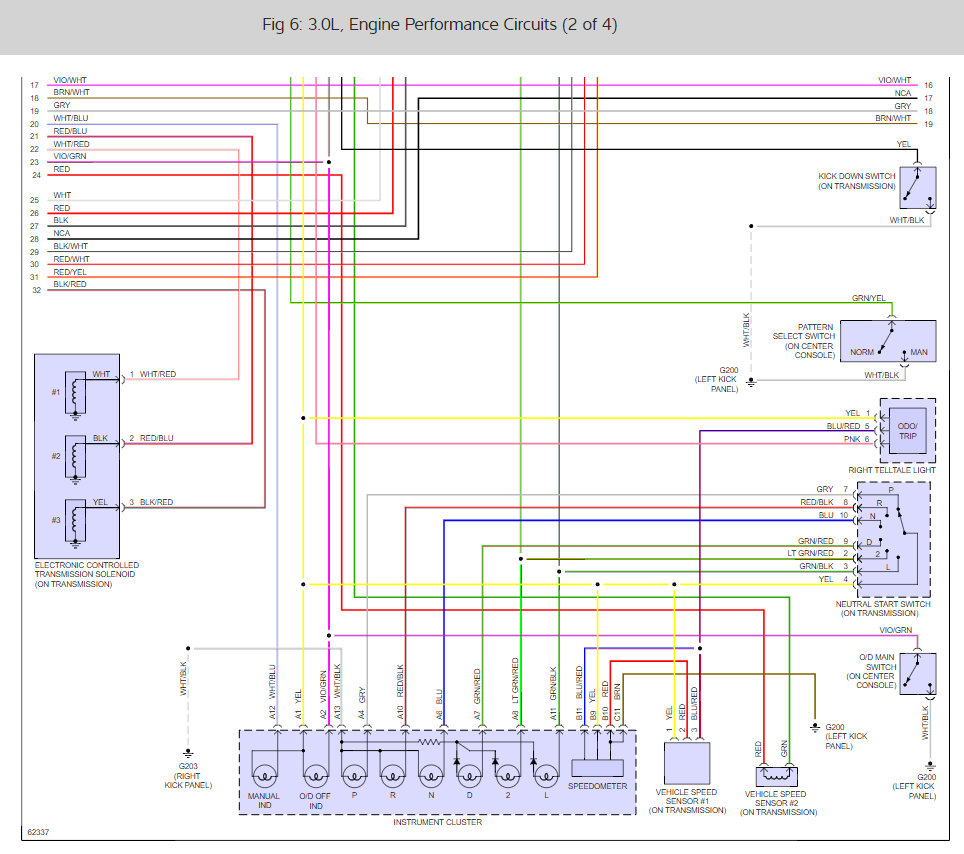

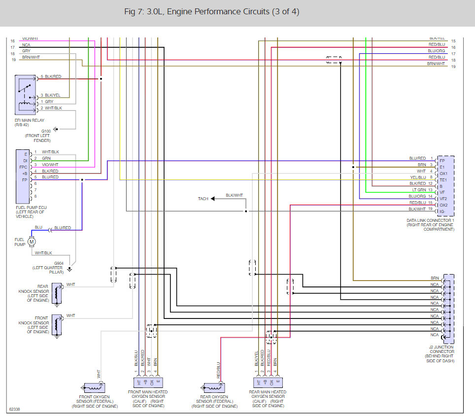

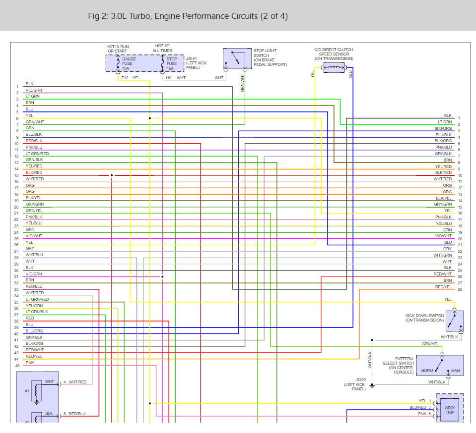

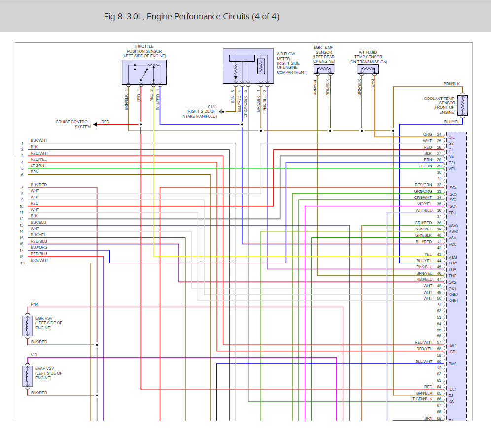

  • 55,399 POSTS
It sounds like you are on the right track. Here are some engine wiring diagrams (below) and a guide to help you do some testing to confirm the problem.
I gave you both turbo and non turbo engines
Please let us know what happens and upload pictures or videos of the problem.

Your buggy runs a 4 wire zirconia/platinum sensor. .34-.65 are on the lower end of the scale and could trip the system lean code because they are that low and not running closer to the normal range.
Low fuel pressure or a vacuum leak could cause that.

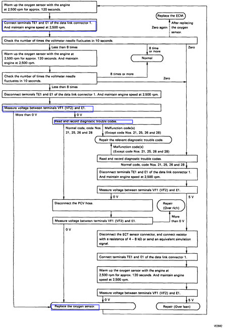

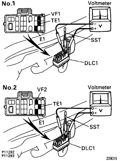

factory test -
Connect the positive (+) tester probe of a voltmeter to terminal VF1 (for No.1) or VF2 (for No.2) of the data link connector (DLC1) , and negative (-) tester probe to terminal E1.
Then follow the chart included.

Mine is a 1993 model non turbo and its old school single wire o2 sensors, I did that test and that's how I discovered that one o2 sensor (the engine wire to it ) was dead and not producing any volts at all I then followed from the manual how to monitor the volts using ox1 and ox2 on the diagnosis port to monitor each o2 sensor

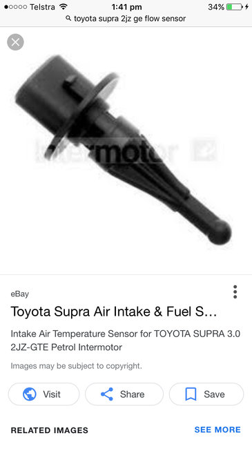

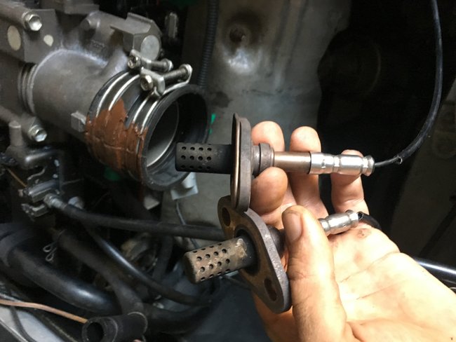

I don't have any of those types mine looks ancient and is a 2 wire one, the clip is missing must of been broken by previous owner so it's pretty much 2 wires each connected to a metal clip that clips directly onto the sender where as the wires would be connected to the female plug to plug onto the sensor. The second picture is the best photo I have ATM where you can see on the intake that the wires directly connect to the sensor itself not through a female/male plug connectors so I might fix that up but at the same time wouldn't that set off a code straight away, the code comes on after around 1minute of driving when the o2 sensors warm up and start operating, one o2 sensor works fine volts jump and and down but the second one doesn't it stays high and doesn't move , I tried to rewire a few days ago and it started jumping like the other one but has failed again so I will have to really cut and connect fresh wires together and solder it and see what happens
Oct 10, 2017 at 9:31 AM
STEVE W.
  • 15,344 POSTS
Yeah if the O2 sensor signal sticks it will cause codes and poor running.
Oct 10, 2017 at 2:22 PM
DRED1990
  • 13 POSTS
Yeah one jumps bolts like it should but one is stuck on high volt, so I will get a new air sensor and also rewire the stuck volt O2 sensor and see how it goes but can't do that for a month due to going away for a month for work but I'll let you know how it goes when I do it
