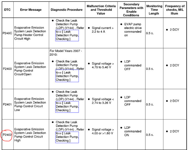

The Code: P2402 - EVPA emission system leak detection pump control circuit high.
This could also be due to a bad leak detection pump or issue with the wiring.

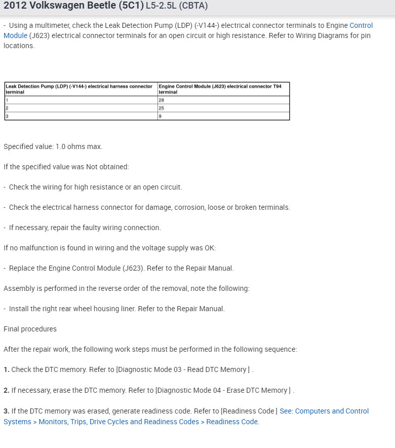

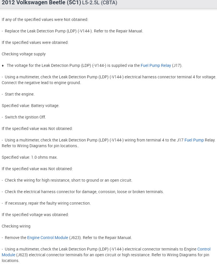

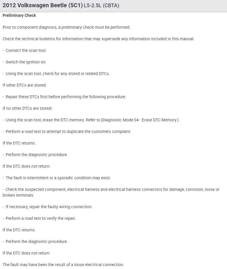

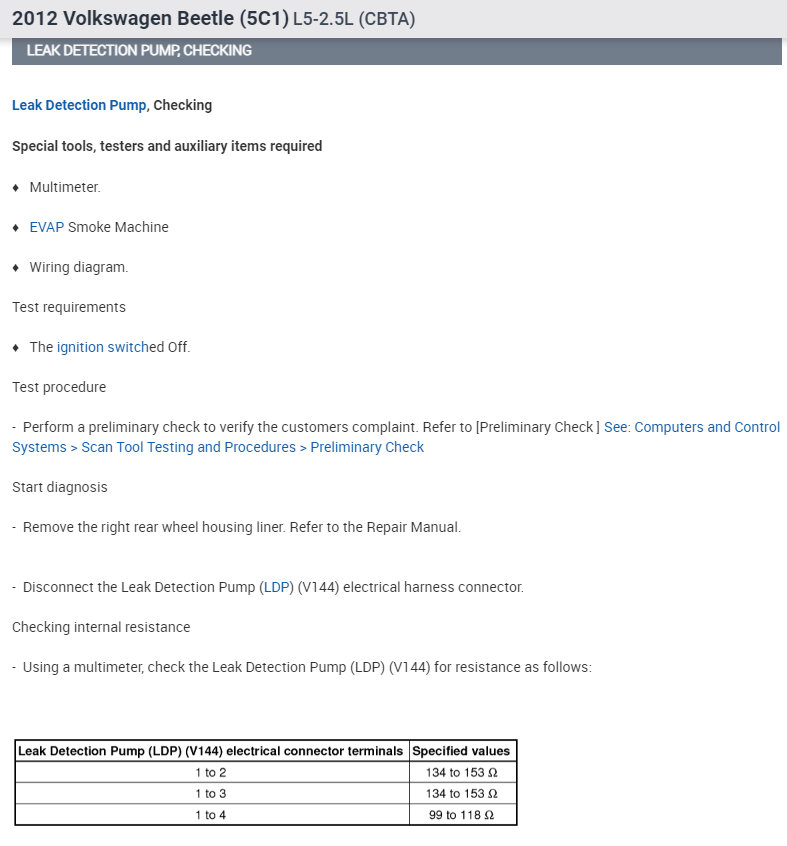

I have attached the trouble shooting guide for the Code P2402 below.
Run thru this to figure out what is the actual issue. This way you are not just replacing part(s) and not getting the desired result.
