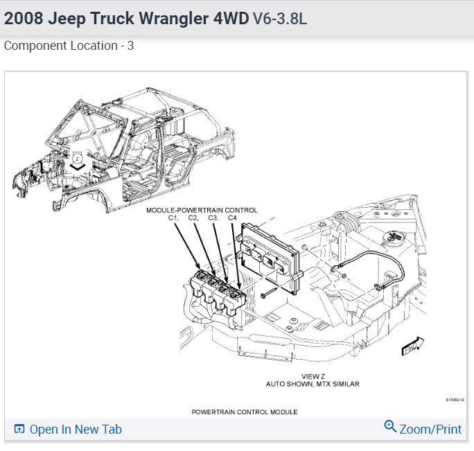

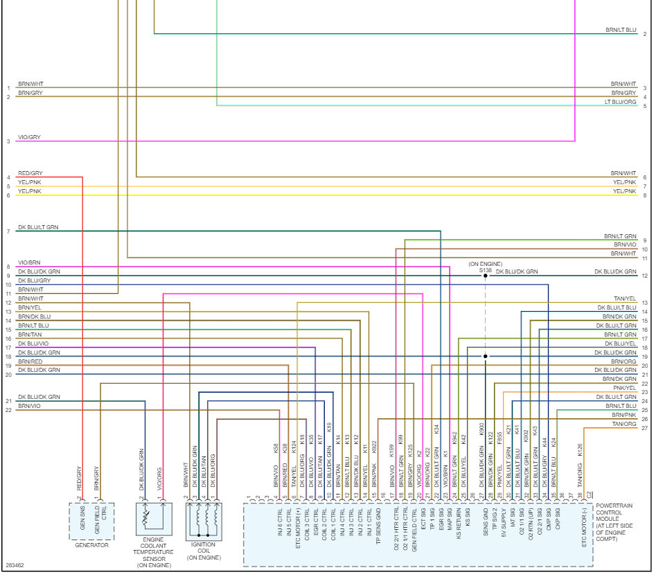

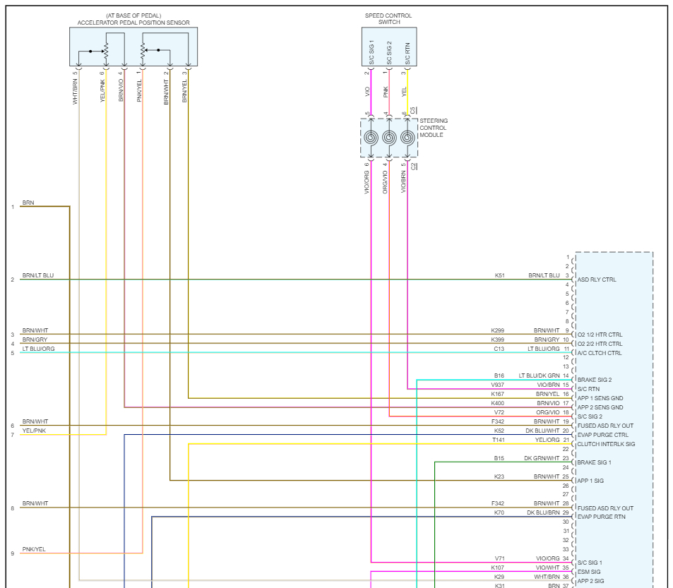

I replaced plugs, wires and coil. I'm still experiencing misfires. Could the problem be the PCM?
Sep 2, 2023 at 3:21 AM
  • 55,402 POSTS

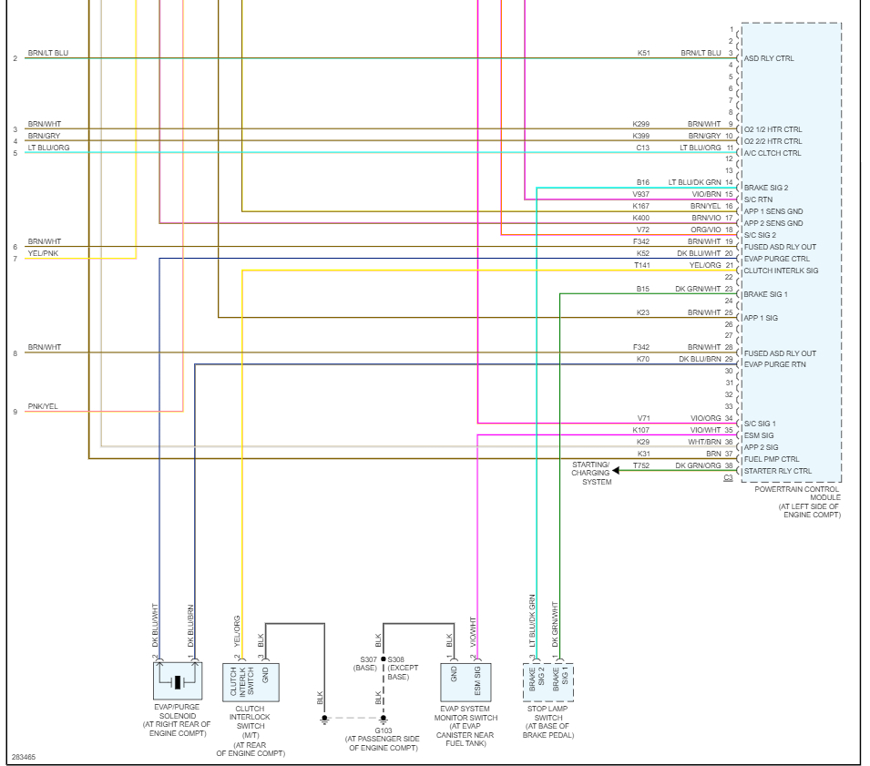

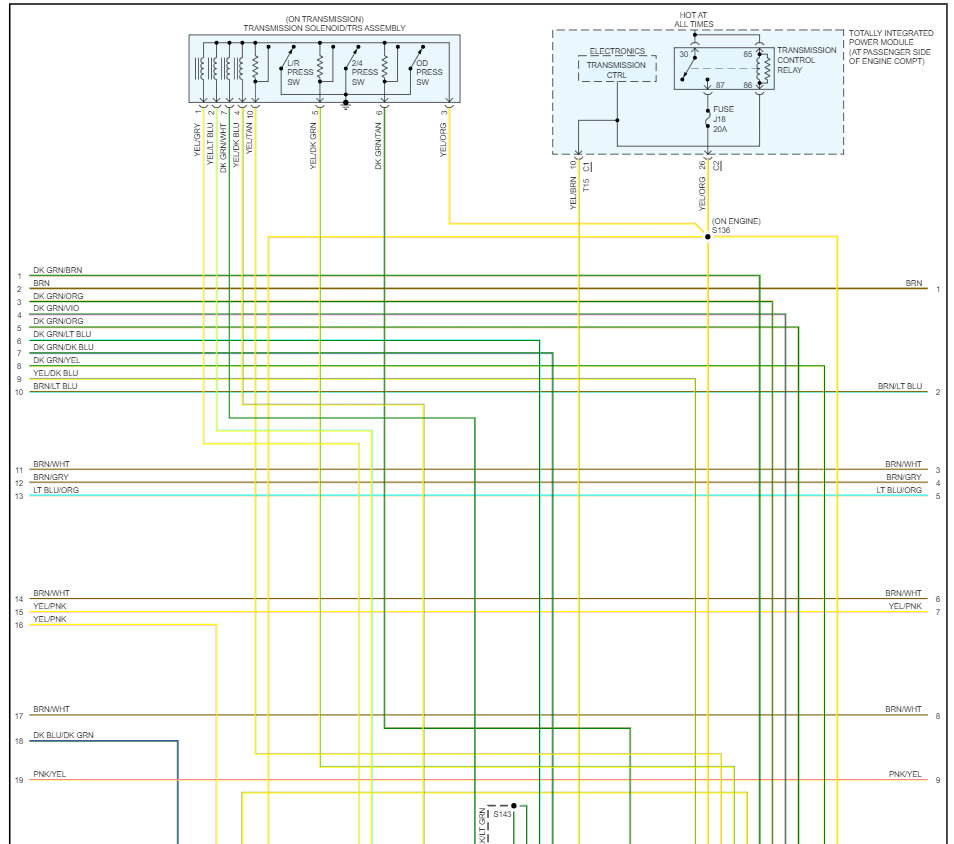

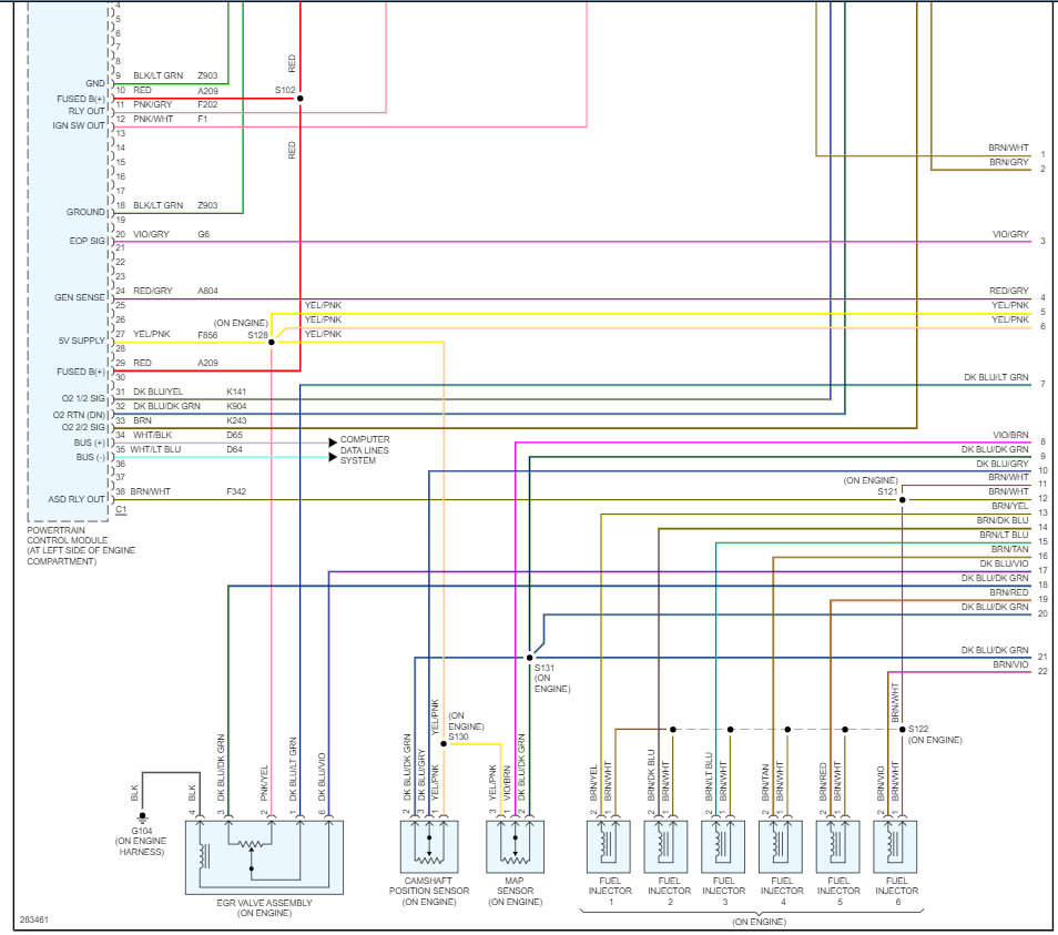

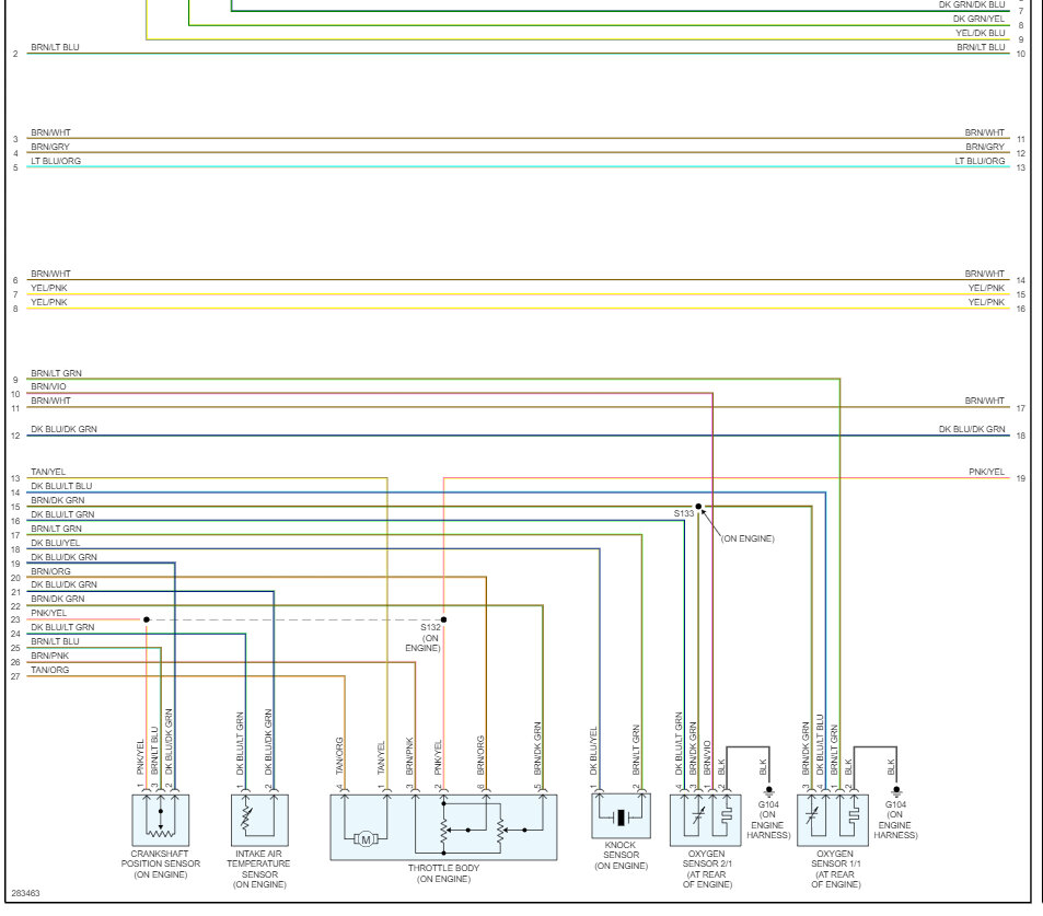

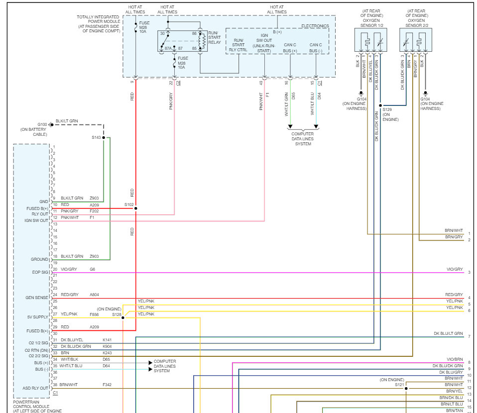

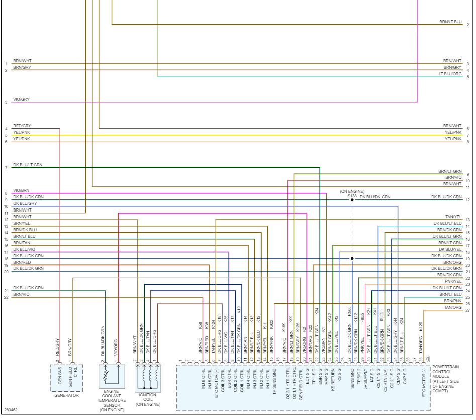

The P2305 trouble code is a generic powertrain code that indicates a problem in the ignition coil "B" secondary circuit. So, it will be a wiring issue or a bad PCM.
Here is a guide to help you test the wiring between the coil and PCM and the PCM/coil wiring diagrams below to help you with the test:
If the wiring is good here is how to change the PCM out, this guide may help as well. You can get a preprogrammed unit by searching Google or Ebay.
Check out the images (below). Please let us know how it goes.
Sep 2, 2023 at 11:32 AM
GEEZYY
Yes, it the PCM.
The notorious Chrysler P2305 issue, often accompanied by P03XXX codes, where it temporary fix problems when replacing the coil and/or spark plug, only to return later, is in 99.95% of cases, a faulty PCM.
You can get a PCM online for $300 + core.
