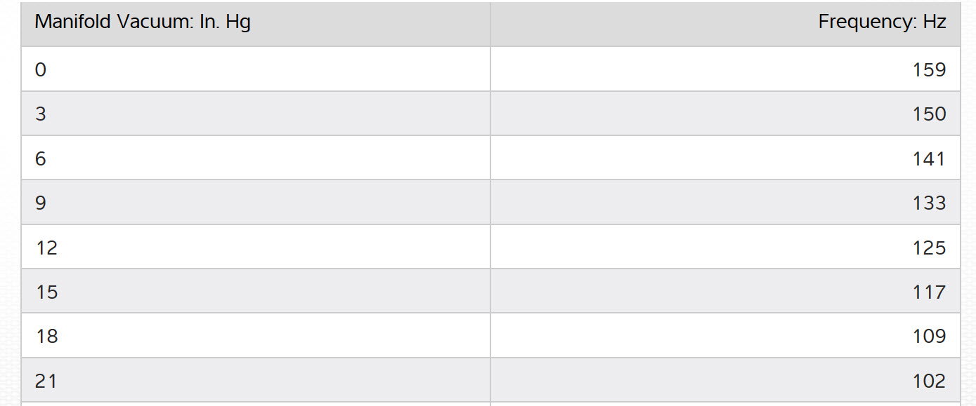

I have a hard time starting my truck. I have got new map sensor, it turns on later, it runs good an starts to turn off.
Jul 30, 2017 at 10:02 AM
ICEMAN3535
MEMBER
3 POSTS
It started doing this slowly like four mouths an to the end of the fourth month it hardly starts.
Jul 30, 2017 at 10:06 AM
HMAC300
Experienced Mechanic
48,601 POSTS
a bad MAP sensor will cause start problems. check this according to chart with vacuum applied. Also, check for a leaky vacuum hose or vacuum leaks.
Image (Click to enlarge)
Jul 30, 2017 at 10:59 AM
