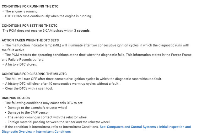

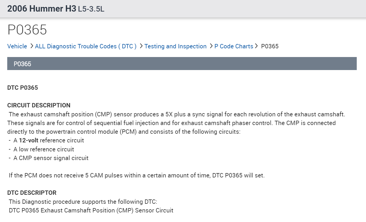

I am getting the code PO365 and was wanting to know what it is?

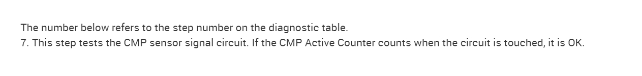

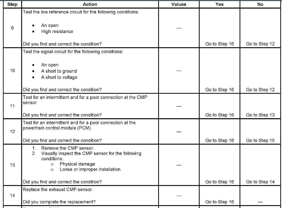

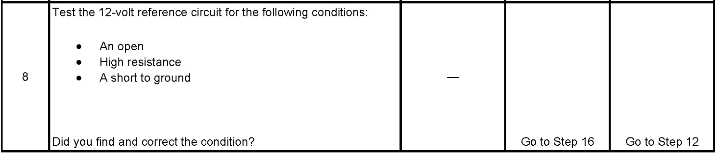

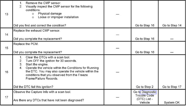

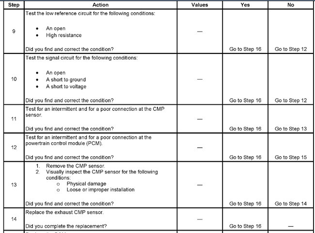

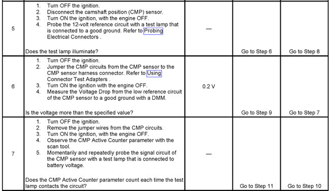

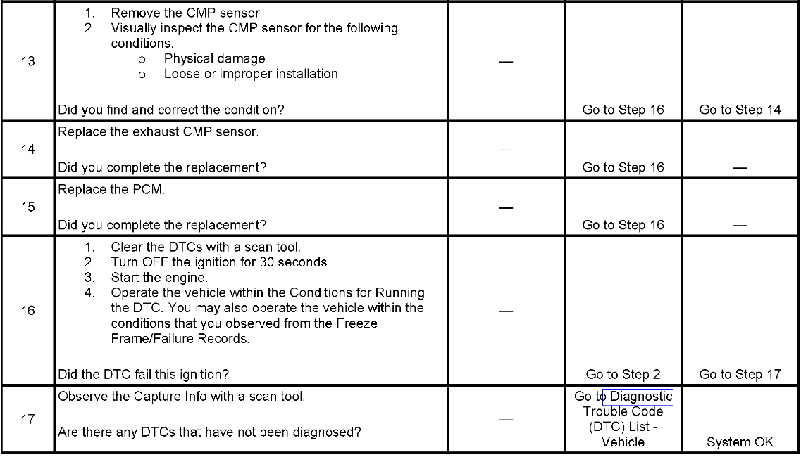

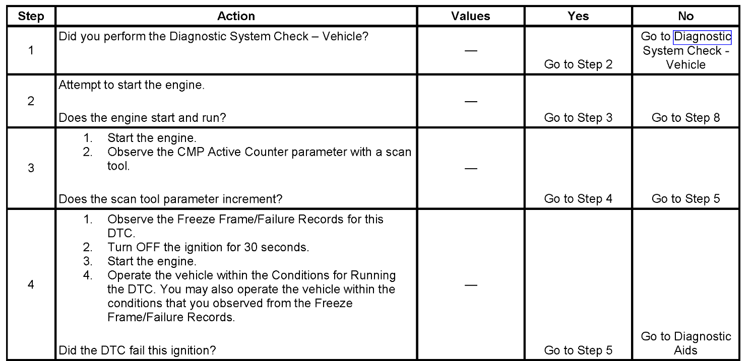

I have included the information you requested in the diagrams down below as well as a step by step troubleshooting diagnostic flow chart. Please go through it and get back to us with what you find out.
Thanks,
Alex

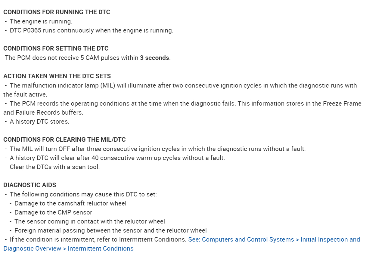

Will try this. i can turn off check engine light with engine running does not come back on while driving, but comes on when restart engine.
Mar 2, 2019 at 2:54 PM
SCGRANTURISMO
  • 4,897 POSTS
Hello again,
If you look at the conditions for running the DTC the engine must be on for the DTC to set. DTC's are usually either 1 trip or 2 trip DTC's. This is a 1 trip DTC.
