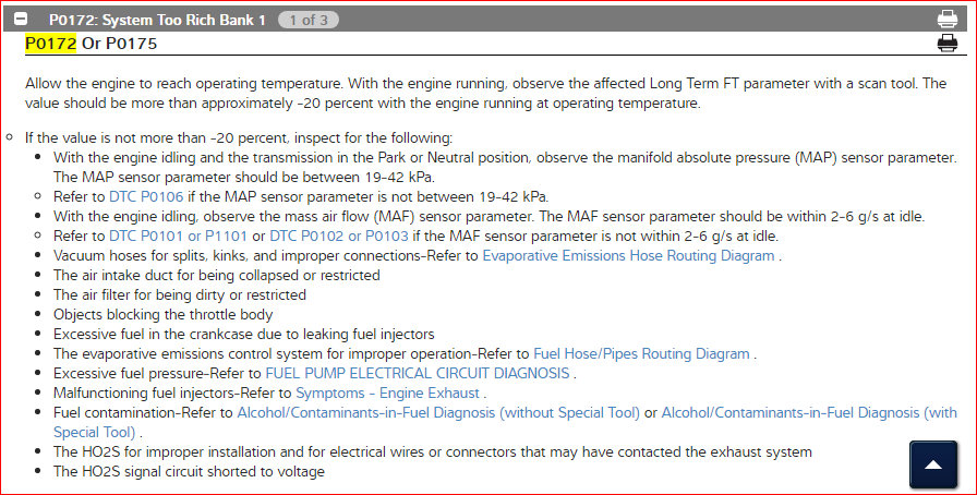

I have a code p0172 come up. Where is this located?

That code is for "System Too Rich Bank 1".
I have attached a picture as a reference for things to check for this particular code. Hope this helps and fee free to ask any questions. Thanks for using 2CarPros.
