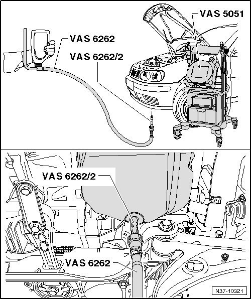

Before doing anything, make sure the trans fluid is full. If this has happened since the service, I have a feeling you will find the fluid is between 2 and 3 quarts low. If it is, make sure you use the correct fluid.
If this is the 6 speed automatic, here are the directions for checking fluid level. The attached pics correlate with these directions.

pic 2
- Remove ATF inspection plug from oil pan.

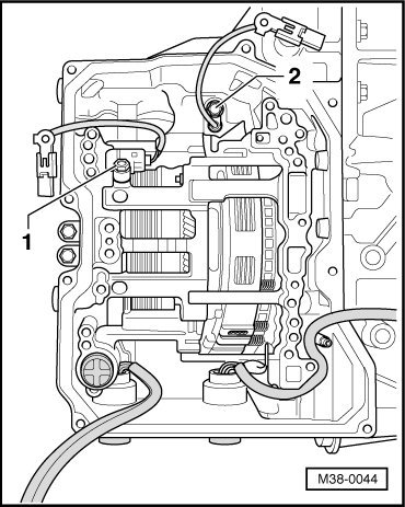

pic 3
The ATF present in the overflow tube runs out.
If ATF drips out of drilling:
ATF does not need topping off.
- Install new seal to plug and tighten to 15 Nm. This completes the ATF check.
If no ATF drips out of inspection hole:
- Top off ATF.

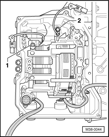

- With engine "running", install adapter for filling oil (VAS 6262/2) hand-tight.
pic 4
- Add 1 l of ATF.
