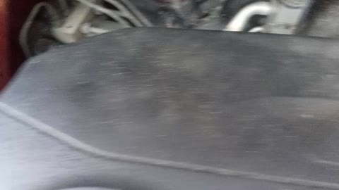

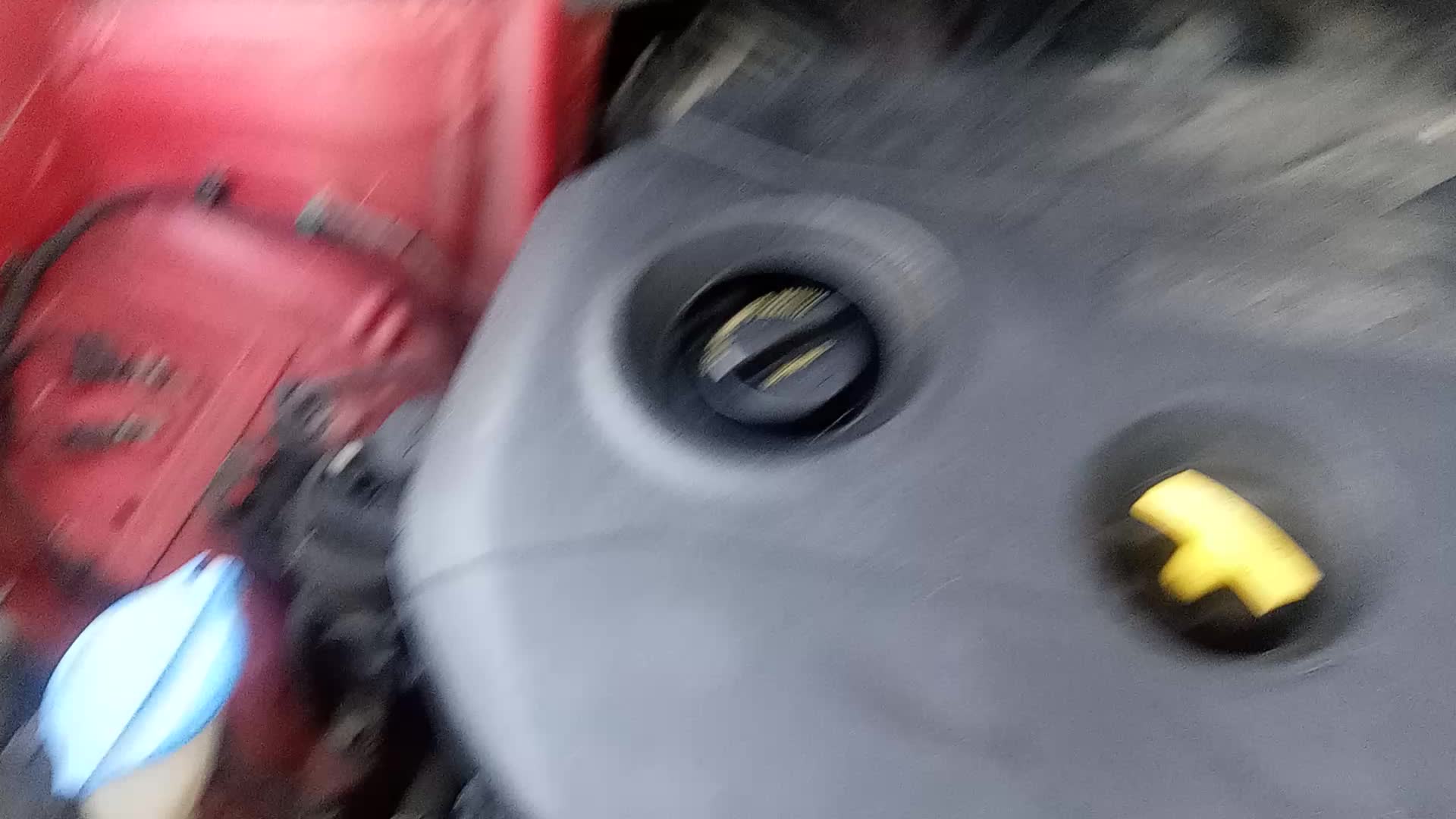

The code P1326 in a 2014 Kia Soul typically indicates an issue related to the "Knock Control System Performance." So, if the engine has an internal problem, it can be making noise which triggers the knock sensor code, can you please upload a shirt video of the engine running so I can hear it? You can upload it here with your response.
Dec 21, 2023 at 5:08 AM
BOSTONBOATSWAIN
  • 45 POSTS
Ten tries but I finally got vid loaded.
(Not your system-my crappy phone).
Seeing a lot of people getting this.
Jan 4, 2024 at 12:52 PM
  • 55,214 POSTS
Yep, that is a noisy engine, it sounds like the timing chain guide has broken and the timing chain has jumped, but to be sure let's do a compression test which will help tell us what is going on.
