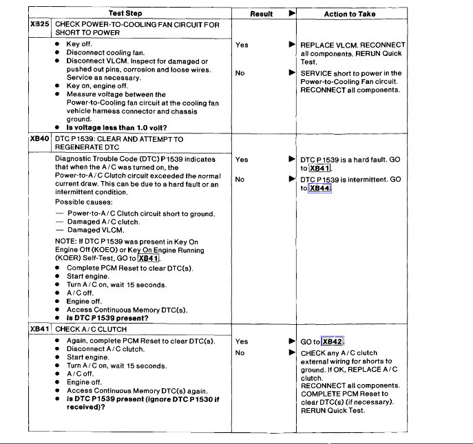

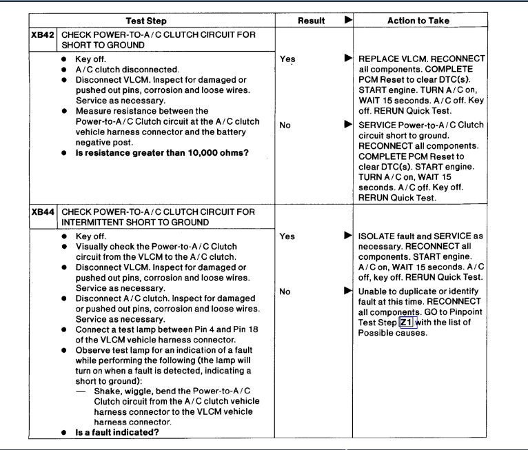

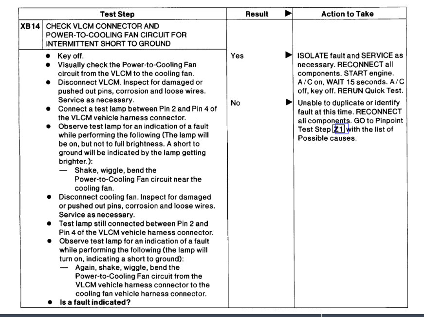

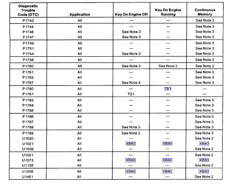

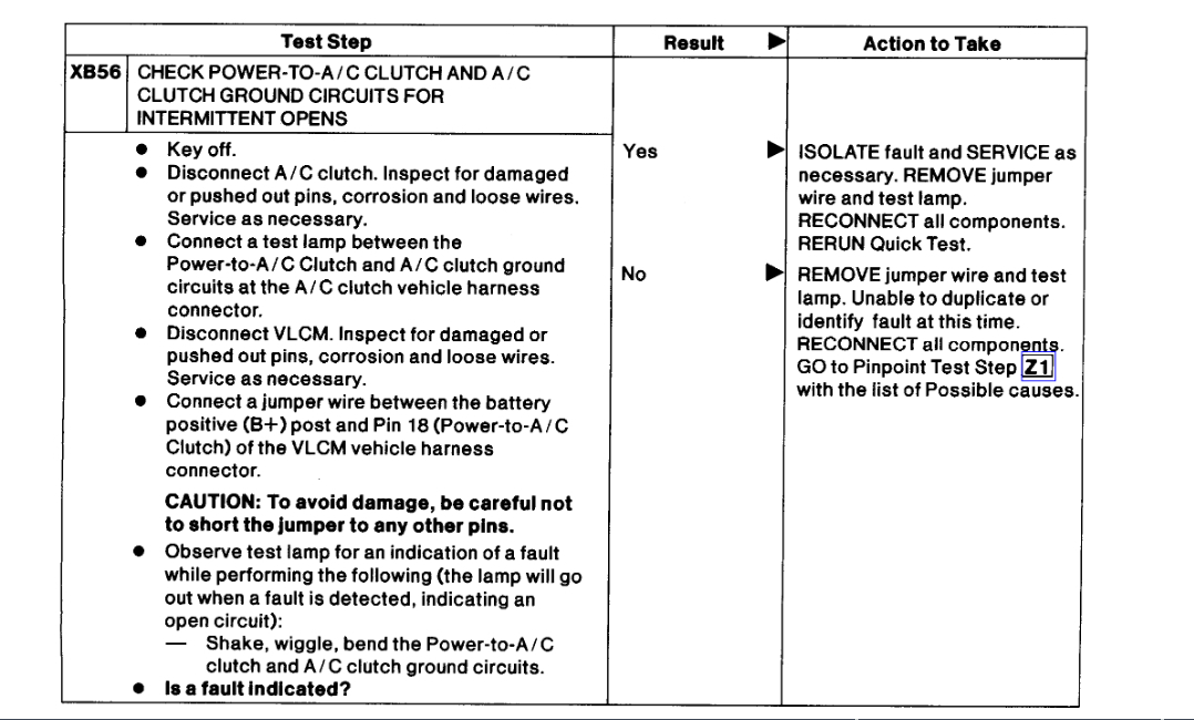

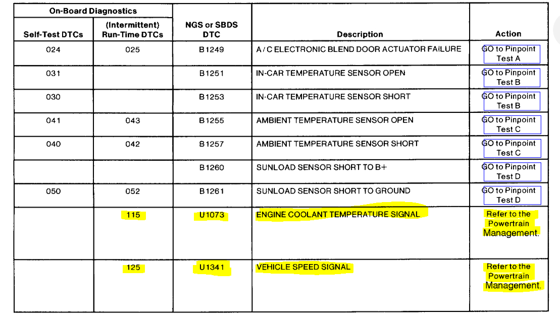

No A/C did the button thing and it blinked 115 125 . Heat works but not really. Wisconsin winter soon please help. A/C is charged.
Aug 12, 2019 at 9:28 PM
SCGRANTURISMO
  • 4,897 POSTS

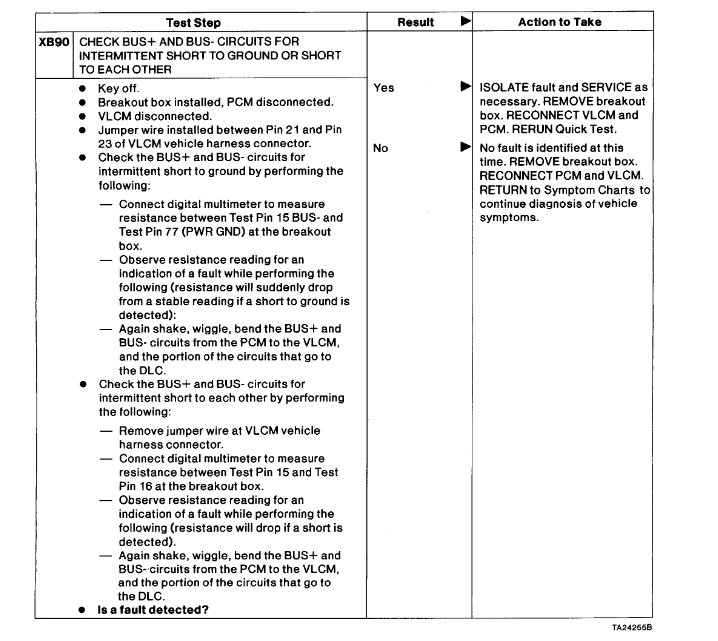

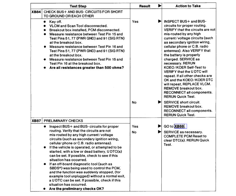

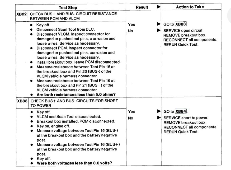

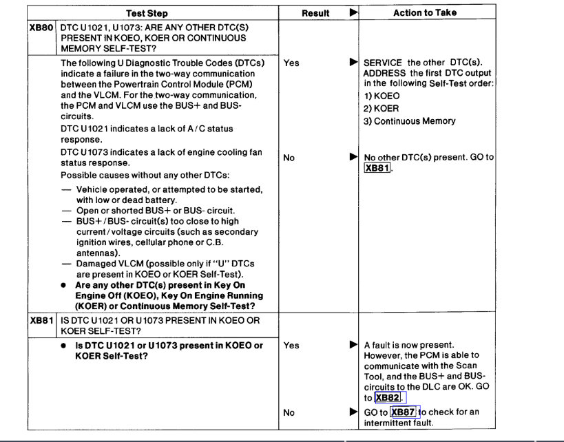

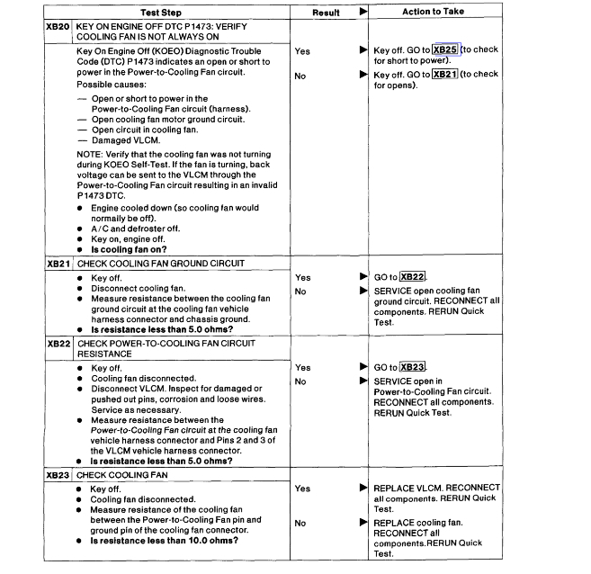

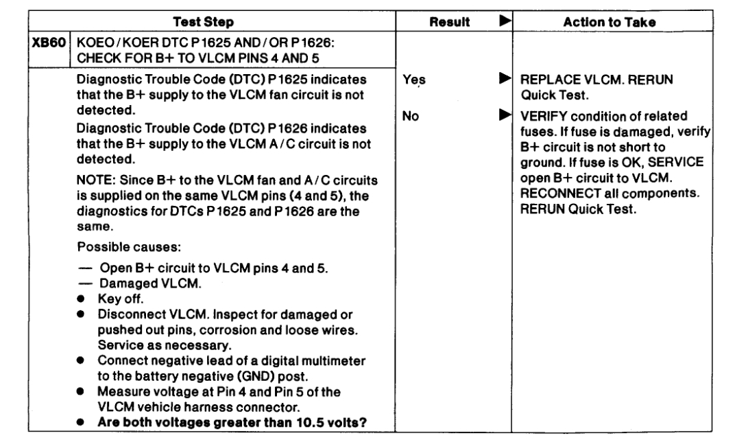

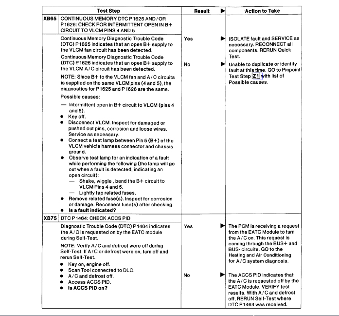

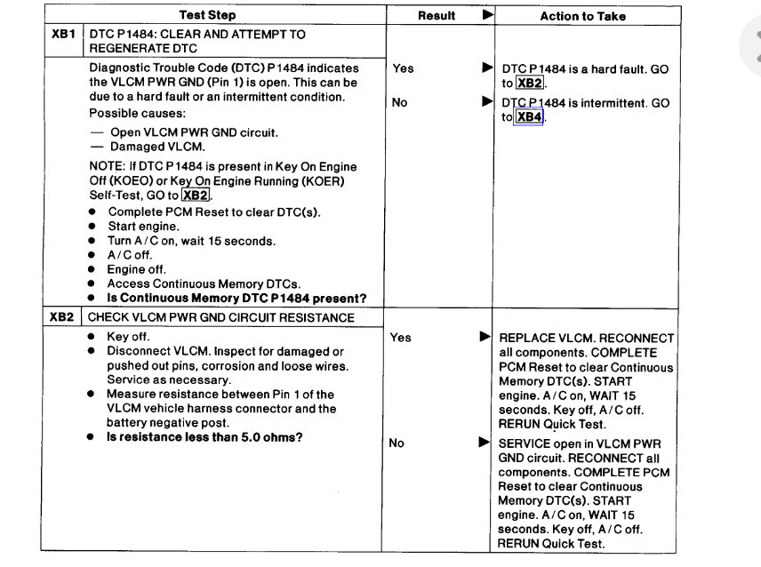

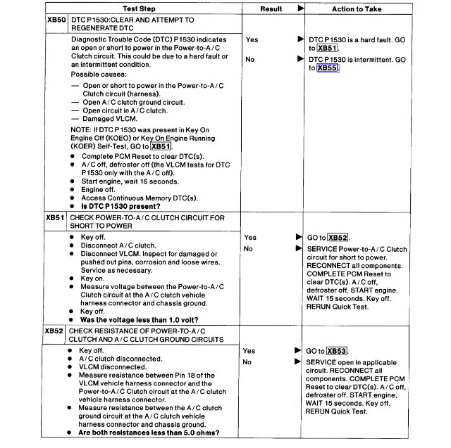

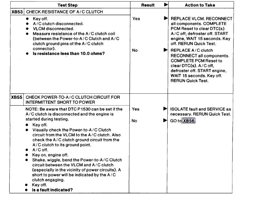

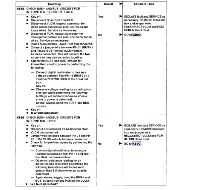

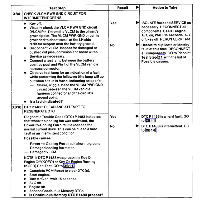

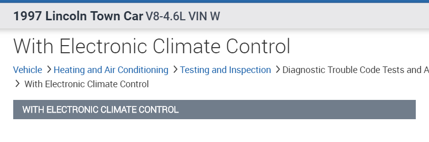

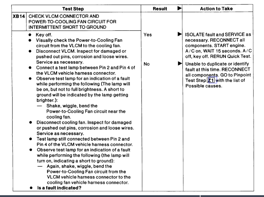

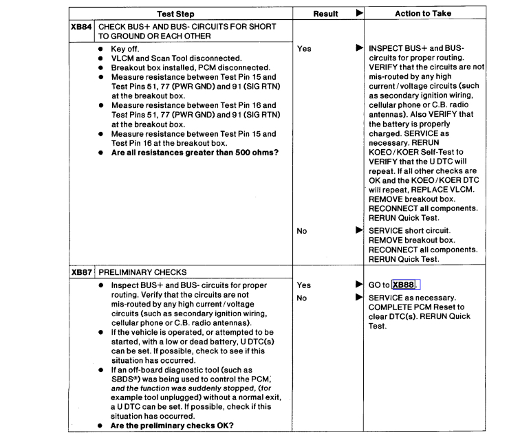

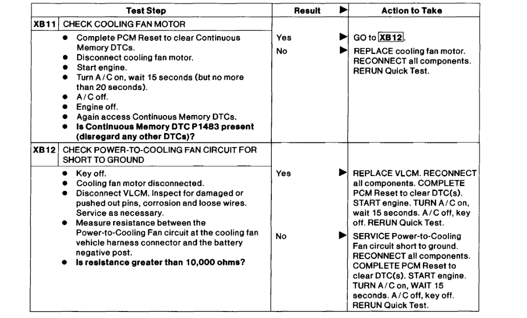

In the diagrams down below I have included the first pinpoint test that you are guided to from the Heating Ventilation and Air Conditioning (HVAC) diagnostic troubleshooting number guide from the HVAC DTC numbers you gave me. It is for code 115. Please go through this first pinpoint test and get back to us with what you are able to find out.
Thanks,
Alex
