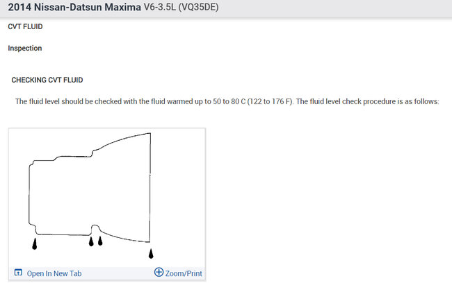

My car is throwing P0746 code, and I don’t know what to do.

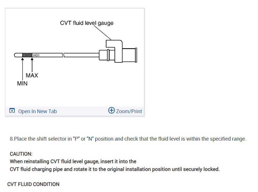

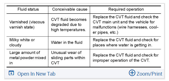

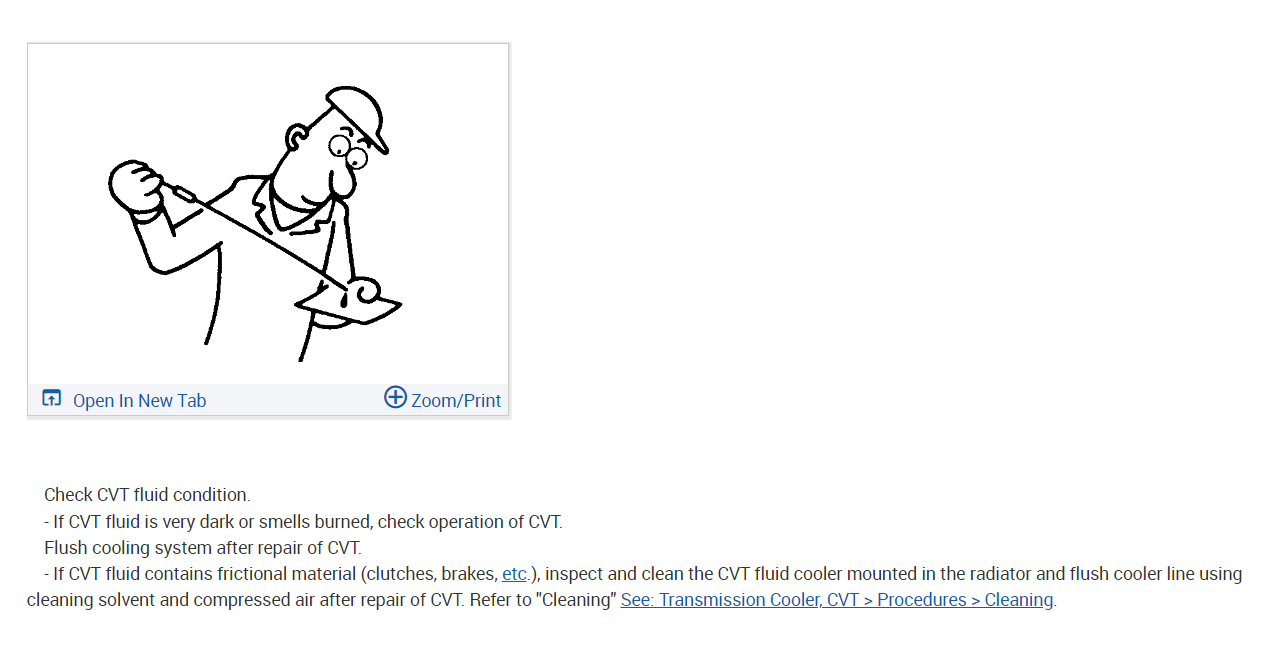

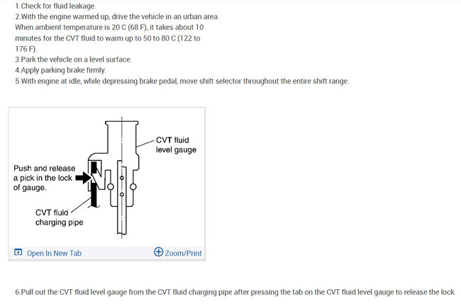

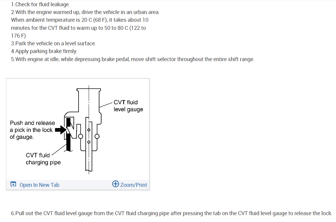

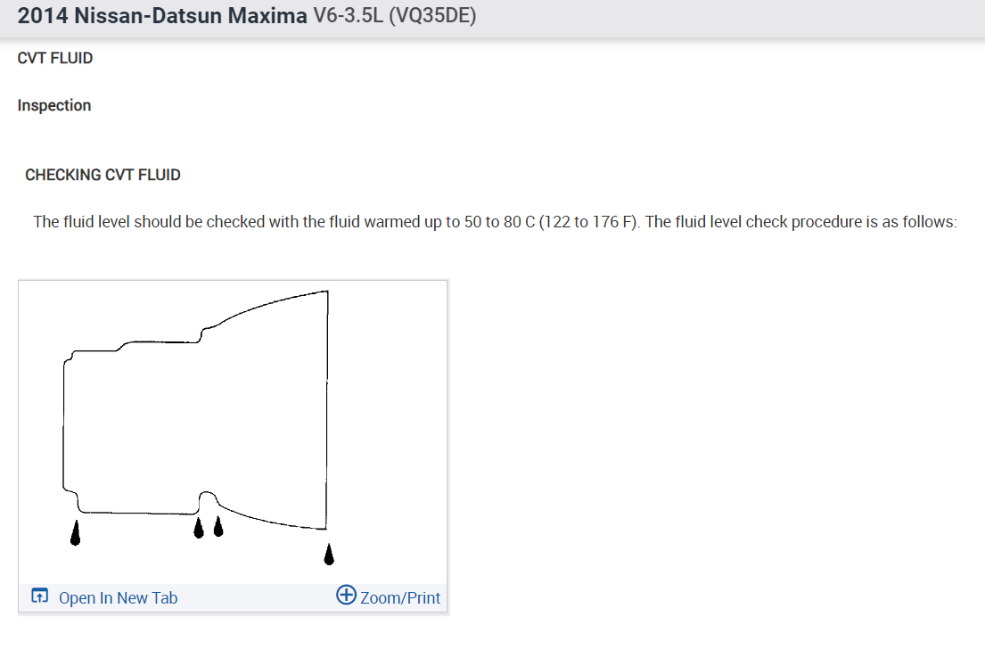

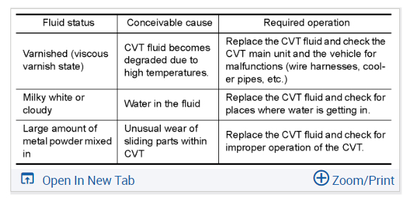

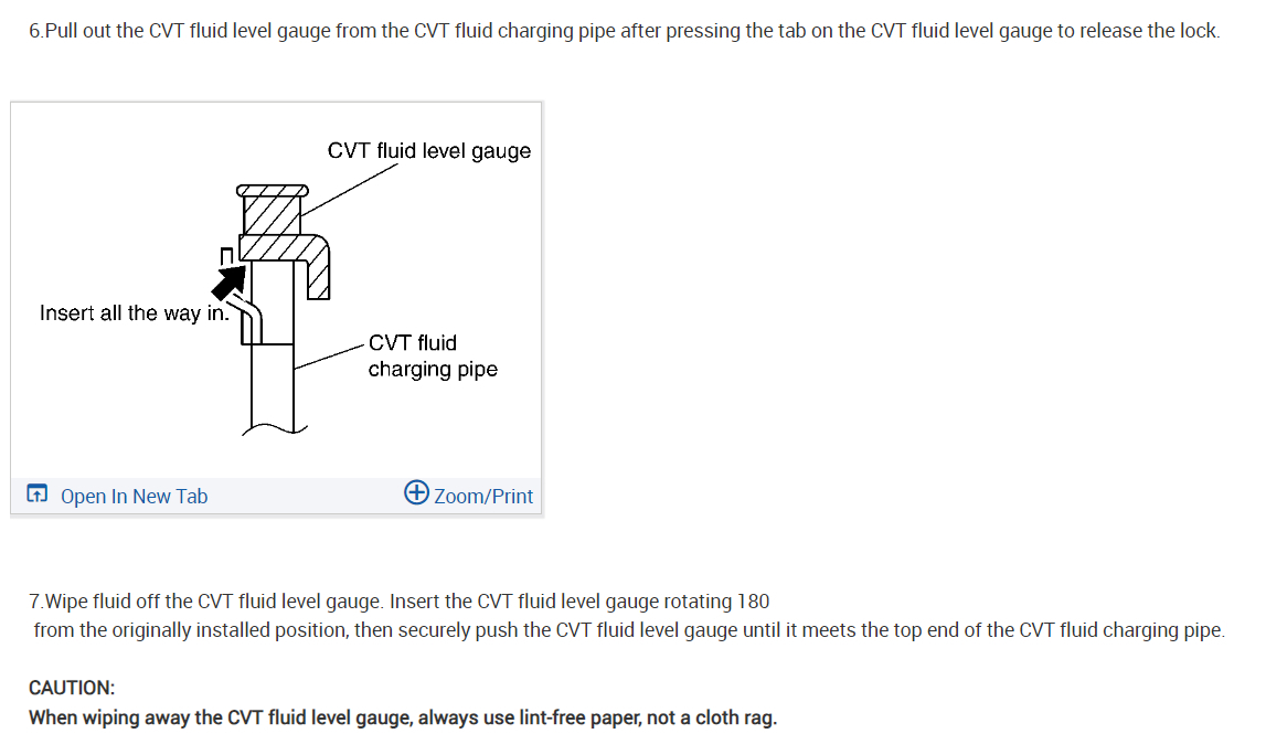

The diagnostic trouble code P0746 in a 2014 Nissan Maxima is related to the Pressure Control Solenoid 'A' Performance or Stuck Off in the transmission.
Here is a guide to help with instructions in the images below to help you with your car:
https://www.2carpros.com/articles/how-to-check-and-add-transmission-fluid
Automatic Transmission Fluid
Type .................... Nissan CVT Fluid NS-2
Check out the images (below). Please upload pictures or videos of the problem so we can see what's going on.
