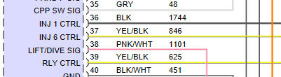

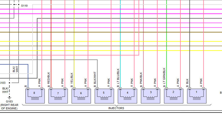

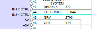

HMAC300
  • 48,601 POSTS
I did not send a diagram because of the VIN had to find out which it was first. the wires may have a connection right at back of engine under manifold so check there as the wires show going right back to PCM. you might check wire going to PCM on offending cylinder and see if it has a good connection normally under five ohms per wire. also make sure to check injector one and two fuses in fuse box under hood. numbers on PCM correspond with wires and are numbered on plastic connections at PCM.
