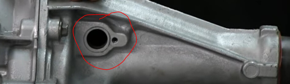

This truck had the transmission replaced before my brother bought it. I have spent hours on my computer looking for information on what I thought was the original transmission only to find out after getting the serial number of the transmission that it was swapped out for the Cobra transmission. We drained the fluid, cleaned the pan, changed the gasket and filter and filled it back up. All this because the transmission was jerky, overdrive light kept blinking, speedometer quit working. My brother had way overfilled it which caused all these problems. Found the sensor and purchased it before finding out it is a Cobra transmission. Long story short, I just need to know where the speed sensor on this transmission is.

The 17 quarts is if the entire system is drained, cooler, torque converter, valve body, and so on. What you installed sounds accurate or close to it.
With your part number above, I was able to determine the transmission is an E40D transmission. The vehicle speed sensor is on the tail housing (driver's side). See pic below. Note in the picture there is no speed sensor installed.
In that location, you can have a speed sensor, a plastic plug, or the bolt hole where the sensor or plug bolt-on can be missing. If it is missing, the VSS will be on the differential.
Let me know if this helps.

If the sensor I identified above isn't there, chances are it is at the top of the rear differential. Let me know.

Was the sensor on the transmission or the rear differential? I've seen issues where ones on the differential are inoperative due to dirt in the differential preventing the hall effect signal.

The sensor is on the rear differential, he cleaned the entire area and replaced the part. I am pretty confident now it is a wiring problem. Rick says the truck is only shifting with a little resistance at 1st gear then shifts smoothly. I suggested he no longer takes advice from the "mobile" mechanic. We will now have to trace every wire from point to point to try and find his problem. Of course it would be easier if we could get this truck from the hot asphalt to do so.
