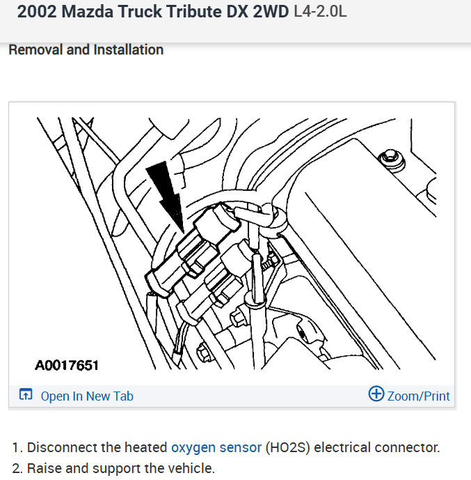

how do i replace the co2 sensor
Jul 25, 2026 at 8:45 AM
Experienced Mechanic
55,688 POSTS

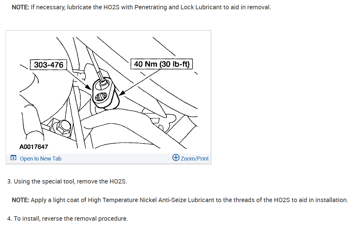

Sure, you can replace the oxygen sensor, I think that is what you mean. There should be 2 or 4 depending on which engine you have, which one are you replacing? Here is a step by step guide to help which instructions below for your car.
https://www.2carpros.com/articles/how-to-replace-an-oxygen-sensor/
Let me know how it goes.
