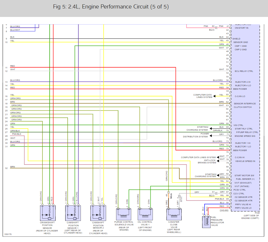

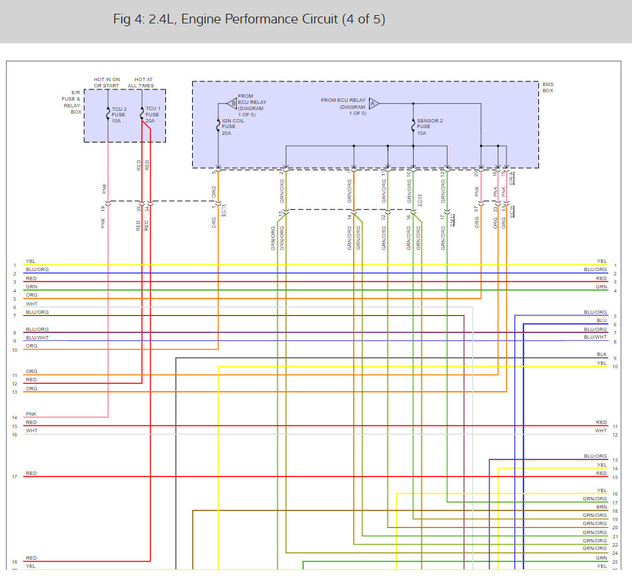

The wires going to my CMP are blue/orange, green/orange, and green. I need to know (facing the front of the car) what order the three wires go on the plug-in? Thanks.

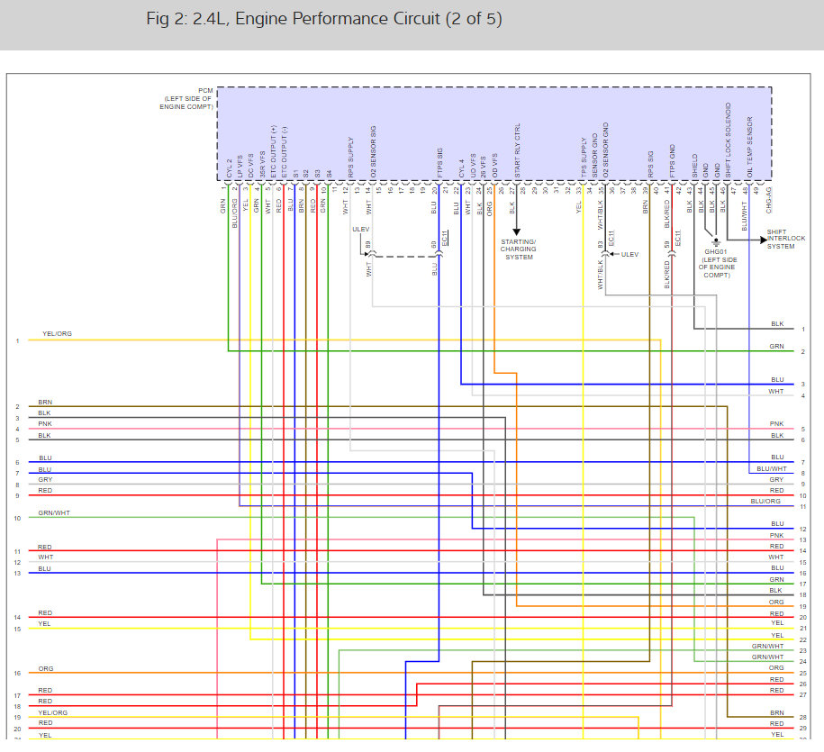

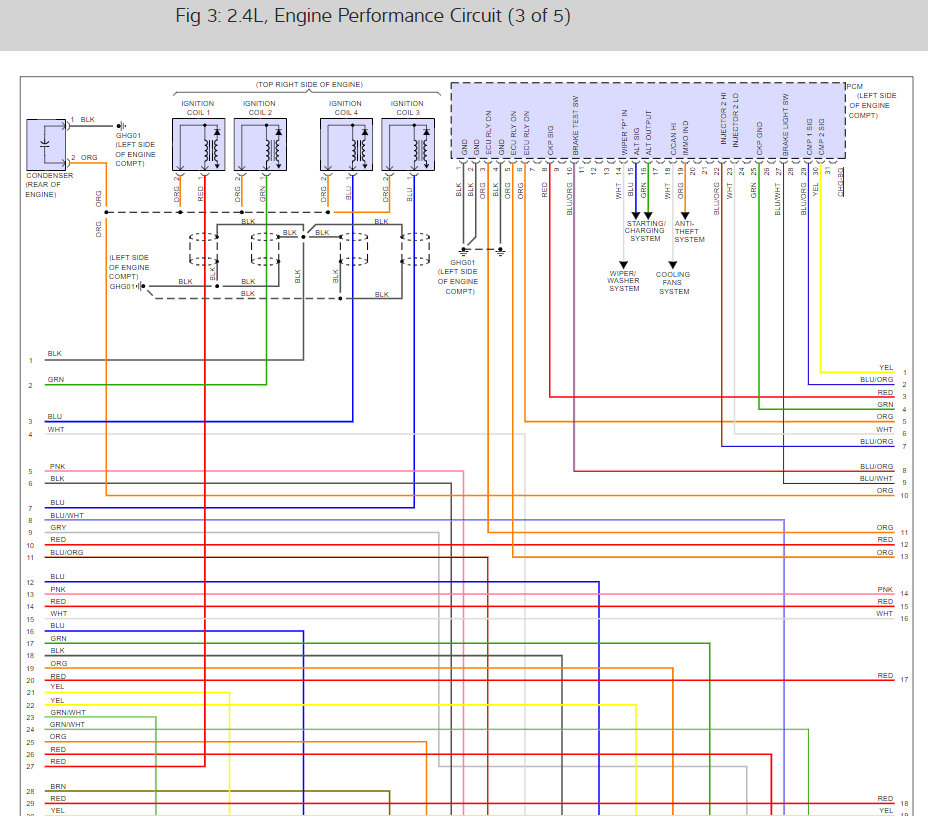

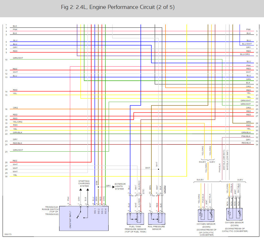

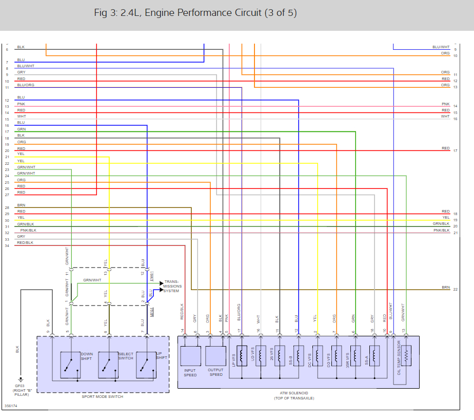

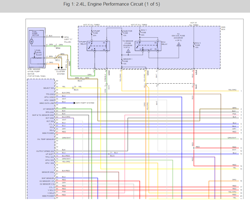

No problem hope all is going well. Here are the wiring diagrams for the engine so you can see exactly how everything is connected. There are two sensors, by the way you should save this page which has the complete engine wiring diagrams on it. Check out the camshaft sensors in the diagrams I think it is at the bottom of #10.

Thanks a bunch Ken. You saved the day! Engine light is out and running fine! With all the schematics I looked at I couldn't find the right one but you did!
