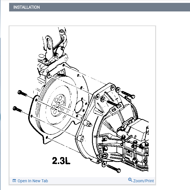

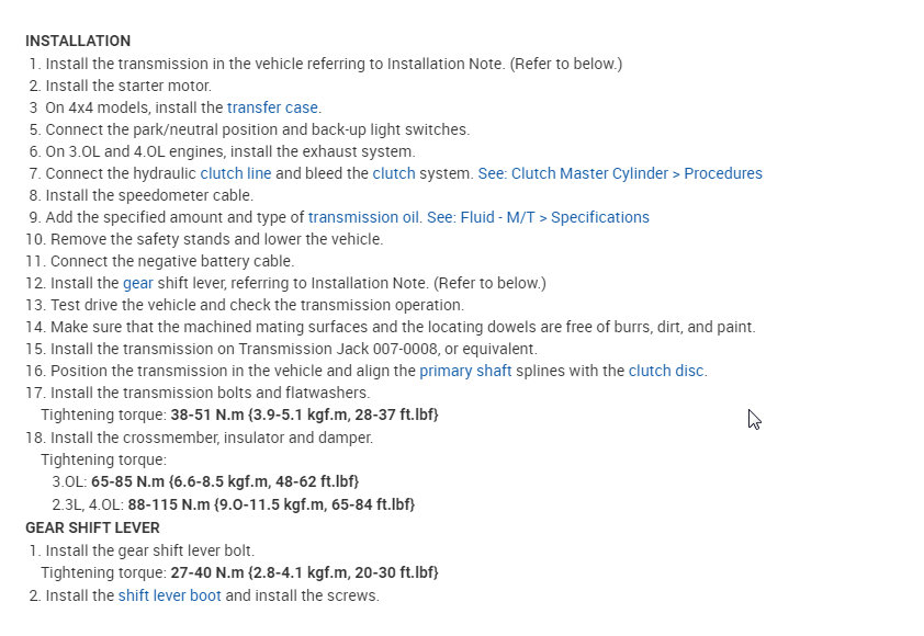

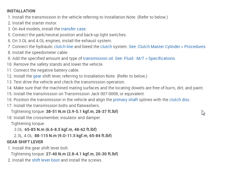

Have you replaced the clutch or any components recently? If not, it sounds like the clutch has just failed and is in need of replacement.
Here is a guide that talks about different issues causes by a failed clutch:
https://www.2carpros.com/articles/clutch-symptoms
Let us know if there are any other things that have happened recently as far as repairs. If not then I would just go ahead and replace the clutch and related components such as flywheel, bearings, and slave cylinder. Thanks
