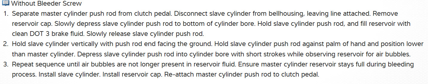

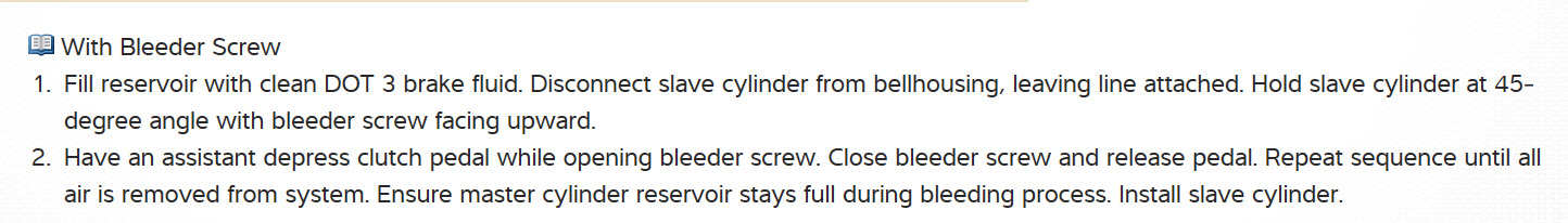

changed master cylinder then changed slave cylinder, bled it for about three hours. when in first gear truck cuts off I have been working on this truck for three days now. please someone help I need some answers soon!!

slave cylinder is not moving far enough.

i put it in first gear the clutch is not disengaging. it cuts off.

slave has to be removed to bleed it correctly then reinstalled. See pictures and try that. there are two different versions with/without bleeder screw i am sending both.
