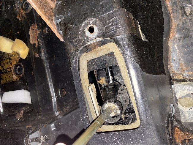

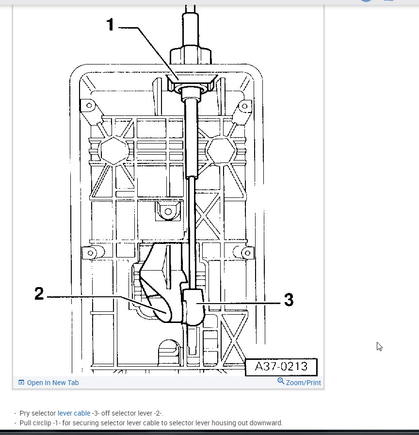

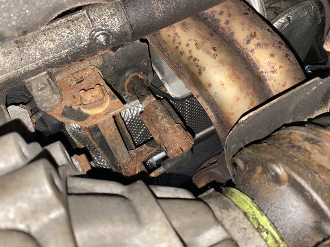

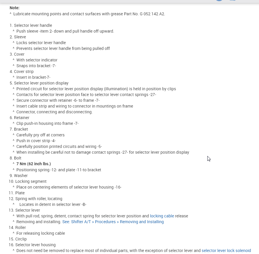

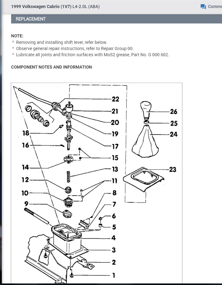

Working on rebuilding the shifter but cannot figure out how to detach the clutch rod from the transmission
Oct 11, 2020 at 4:21 PM

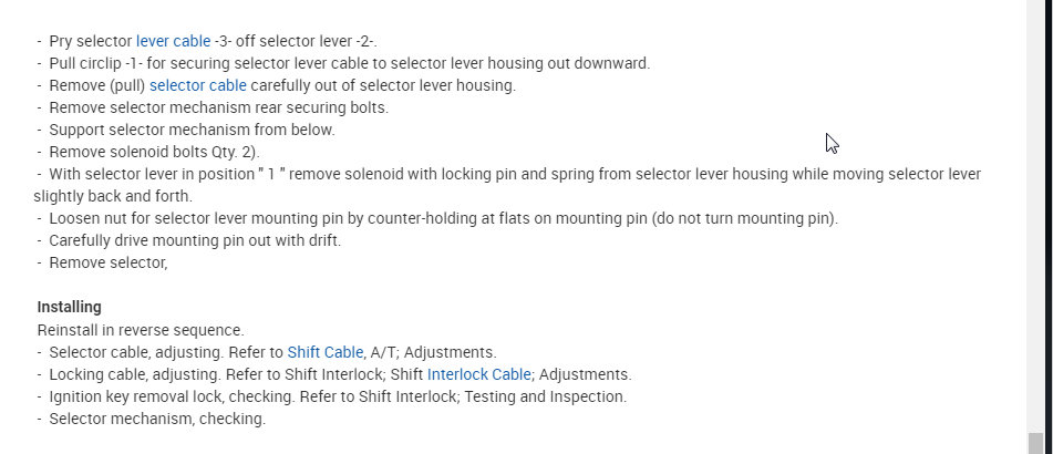

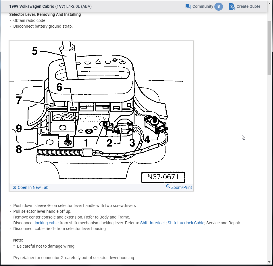

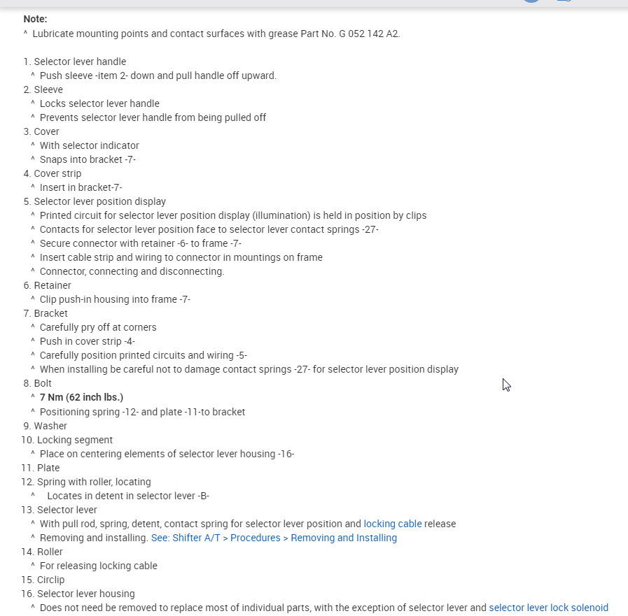

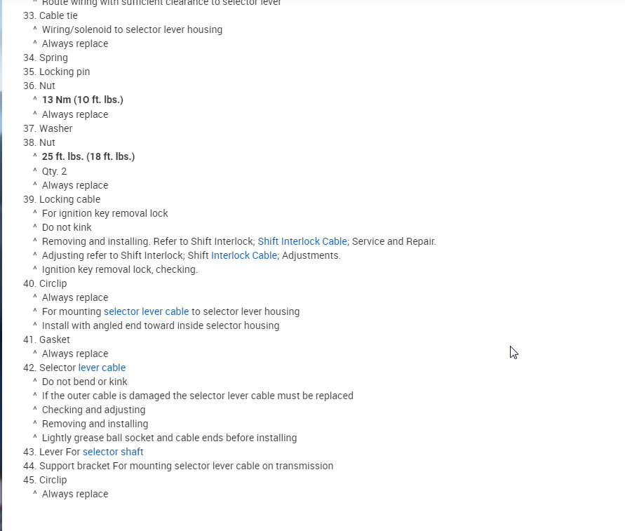

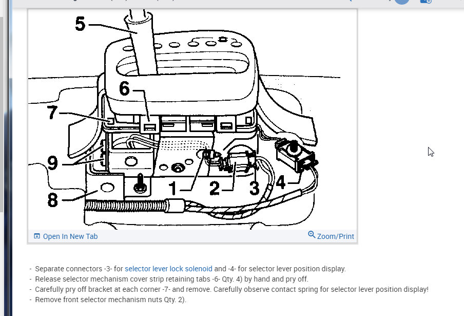

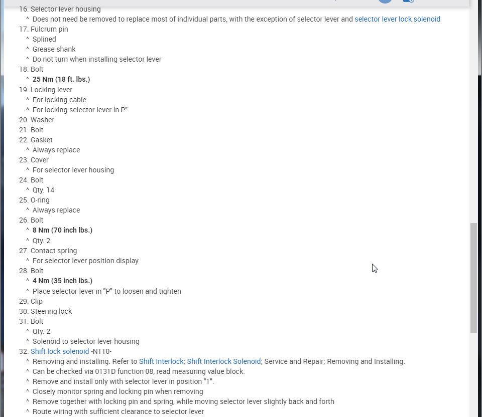

I am attaching the entire process for your review to see if you are missing a step.

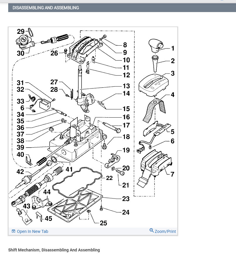

Also, I included the exploded view of the shifter that may help identify what you are missing. Let us know what questions you have or how you make out. Thanks
Oct 11, 2020 at 4:32 PM
SETH7383873
  • 15 POSTS

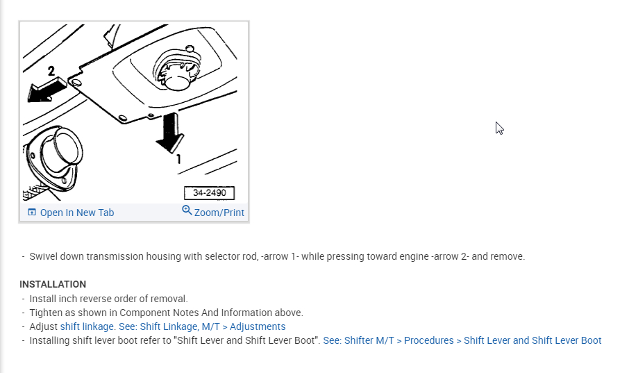

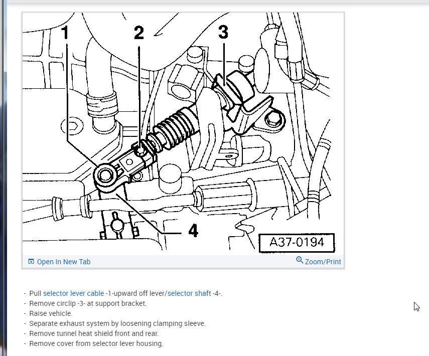

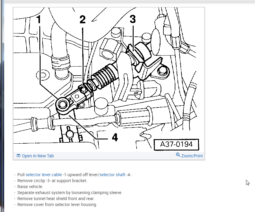

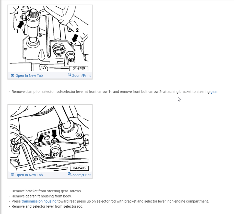

It is for a automatic i need manual.
Oct 11, 2020 at 5:19 PM

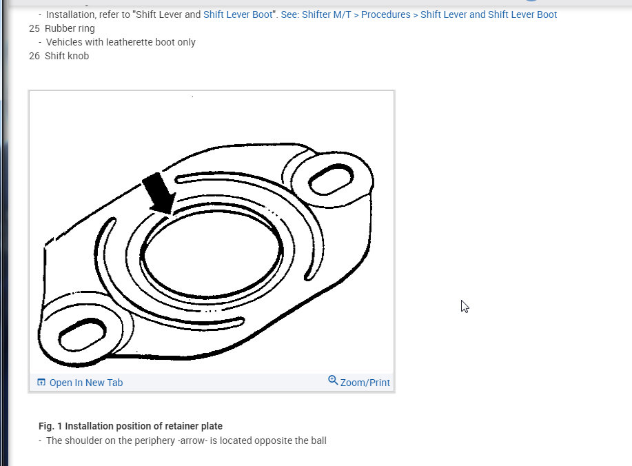

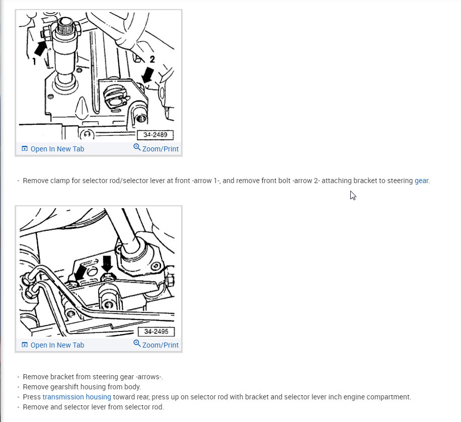

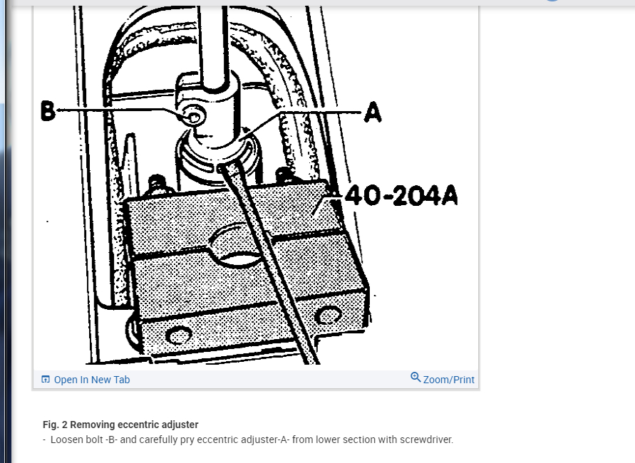

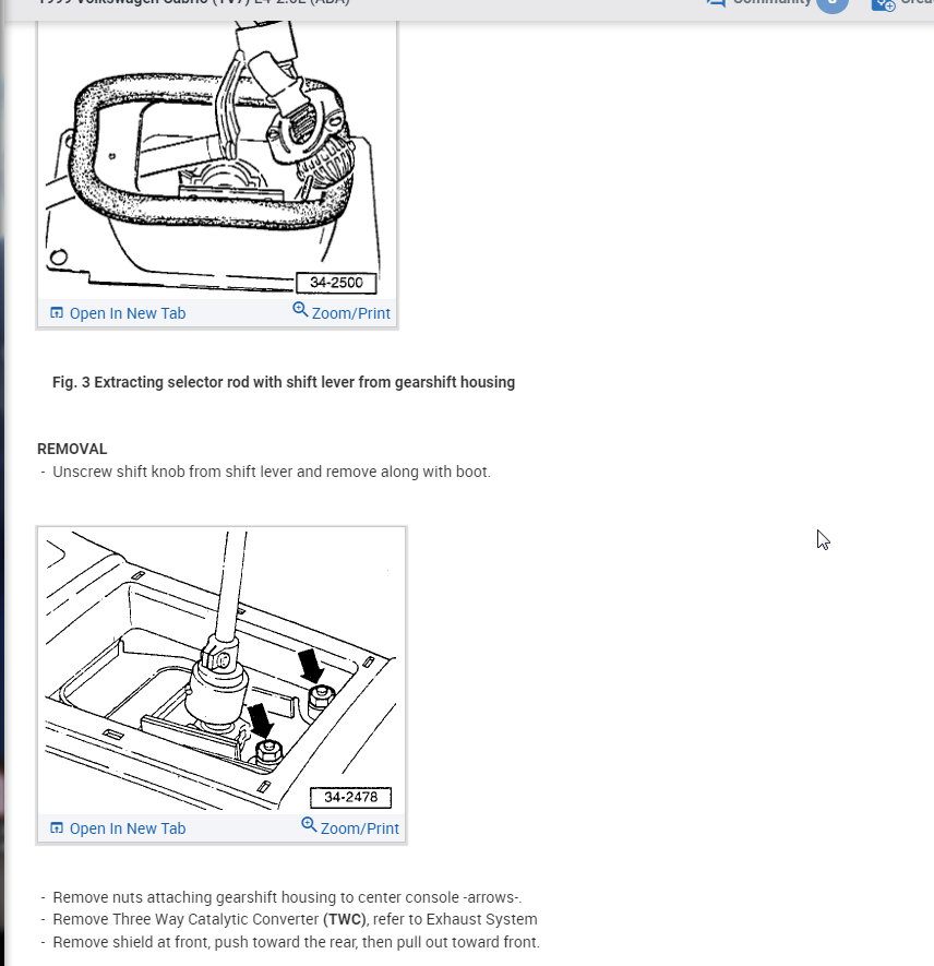

So sorry. I am just used to answering that question for auto transmissions. Here is the process for a manual.
Let me know how you make out.

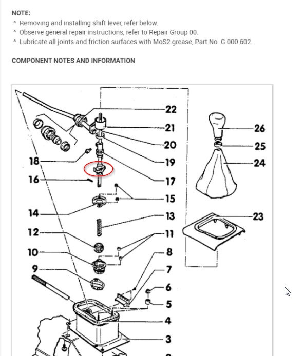

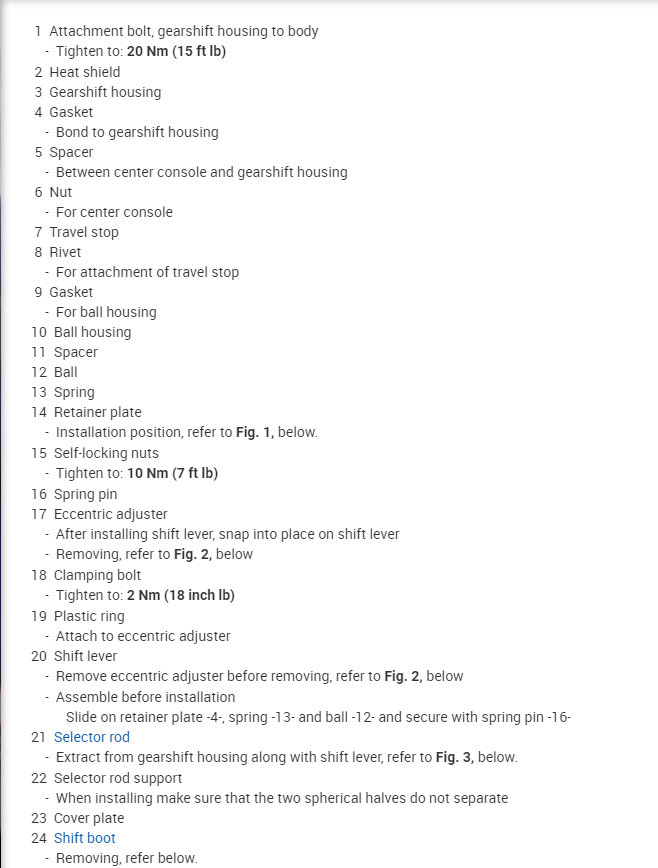

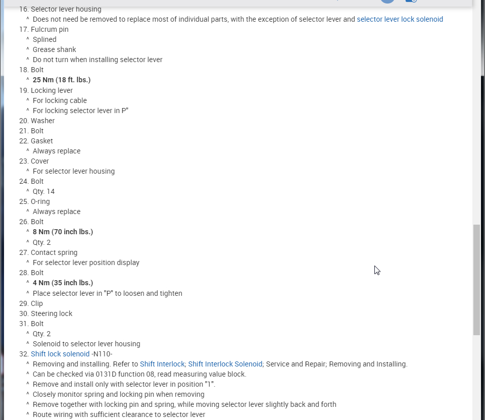

Thank you! Have one more question though, what is the part between 16 and 17? The guy I bought it from really did a number on this thing and cut that part and needs to be replaced. Thanks!
Oct 15, 2020 at 3:24 PM
Just so I am clear, this part that I circled? If so, that is part of the spring pin (16). However, I am not confident that you will find just that part. You may need to get the shifter assembly or find a salvage yard that has one and will let you take just that piece.
