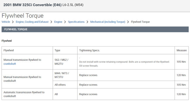

Sure, here are the torque specs you have requested.
Manual transmission flywheel to crankshaft S62 / M62 / M62TU - Do not install with screw retaining compound. Bolts are a component of the flywheel.
Oil screw threads. 105 Nm
Manual transmission flywheel to crankshaft M44 / M73 / M73TU
Replace screws 120 Nm
All others Replace screws 105 Nm
Automatic transmission flywheel to crankshaft
All Replace screws 120 Nm
Clutch to Flywheel
M8 Bolts [Grade 8.8] 24 Nm
M8 Bolts [Grade 10.9] 34 Nm
They don't say what the rear main housing bolts are. Let us know if you need anything else.

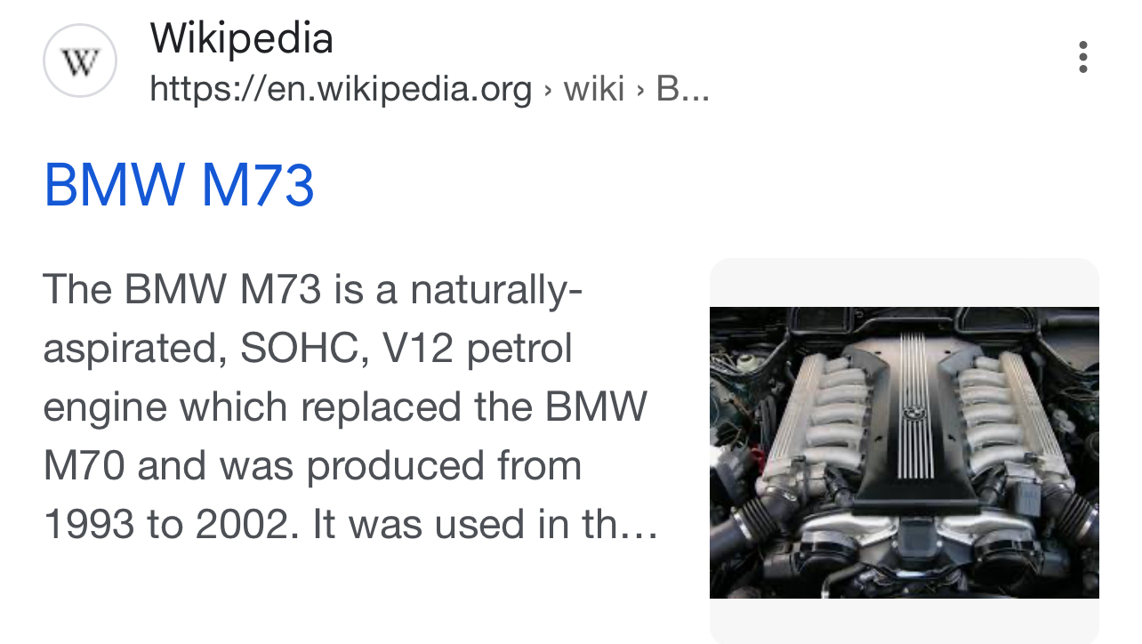

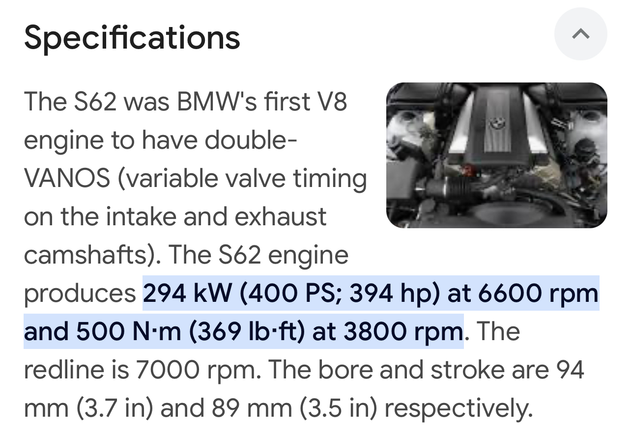

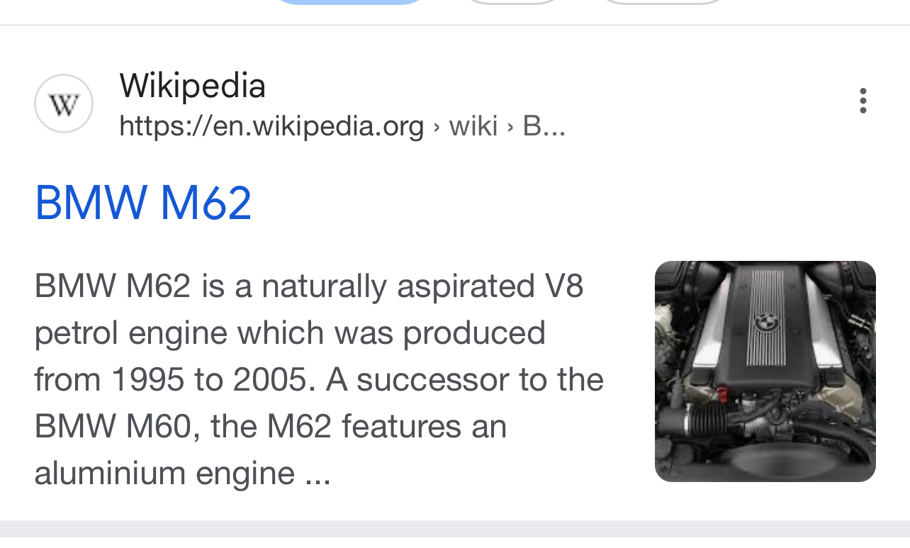

S62 / M62 / M62TU I think these are for v8s.

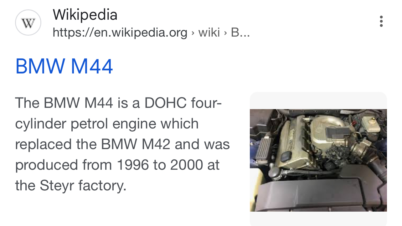

I checked. All of them are for v8s except the m44 which is a 4 cylinder It's on Wikipedia and many other sites. I am very familiar with these numbers too, that's why i asked. The 6-cylinder inline are usually the m54 abd m52.

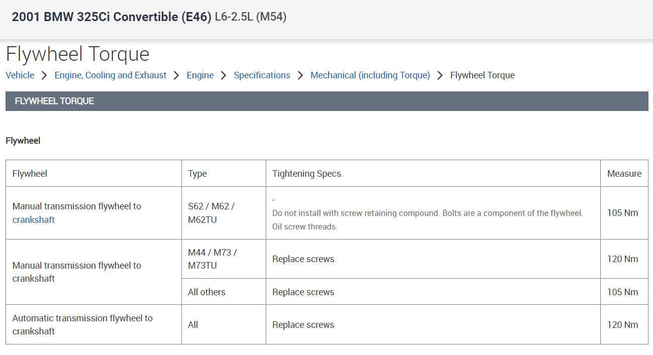

Sorry, my bad I was looking up the convertible. Here is the inline 6 cylinder:
Manual transmission flywheel to crankshaft S62 / M62 / M62TU - Do not install with screw retaining compound. Bolts are a component of the flywheel. Oil screw threads. 105 Nm
Clutch to Flywheel

S62, m62 are v8s.

  • 55,214 POSTS
Hmm, Alldata must have it wrong, sorry.
The 2001 BMW 330Ci does not come with the S62 or M62 V8 engines. Instead, it is equipped with the M54 inline-six engine.

Aug 24, 2024 at 3:03 AM
  • 55,214 POSTS
This is what they show, check out the images (below).
