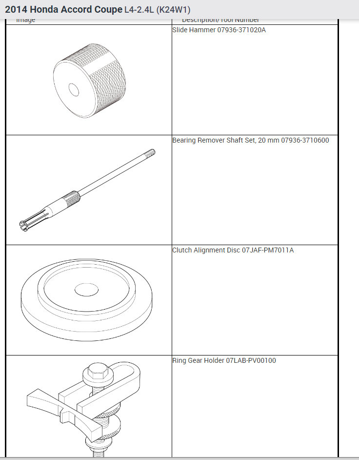

Replacing the clutch is a fairly extensive work and does require some special tools.

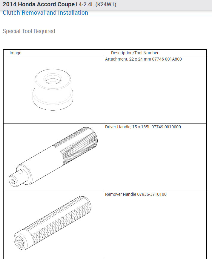

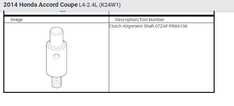

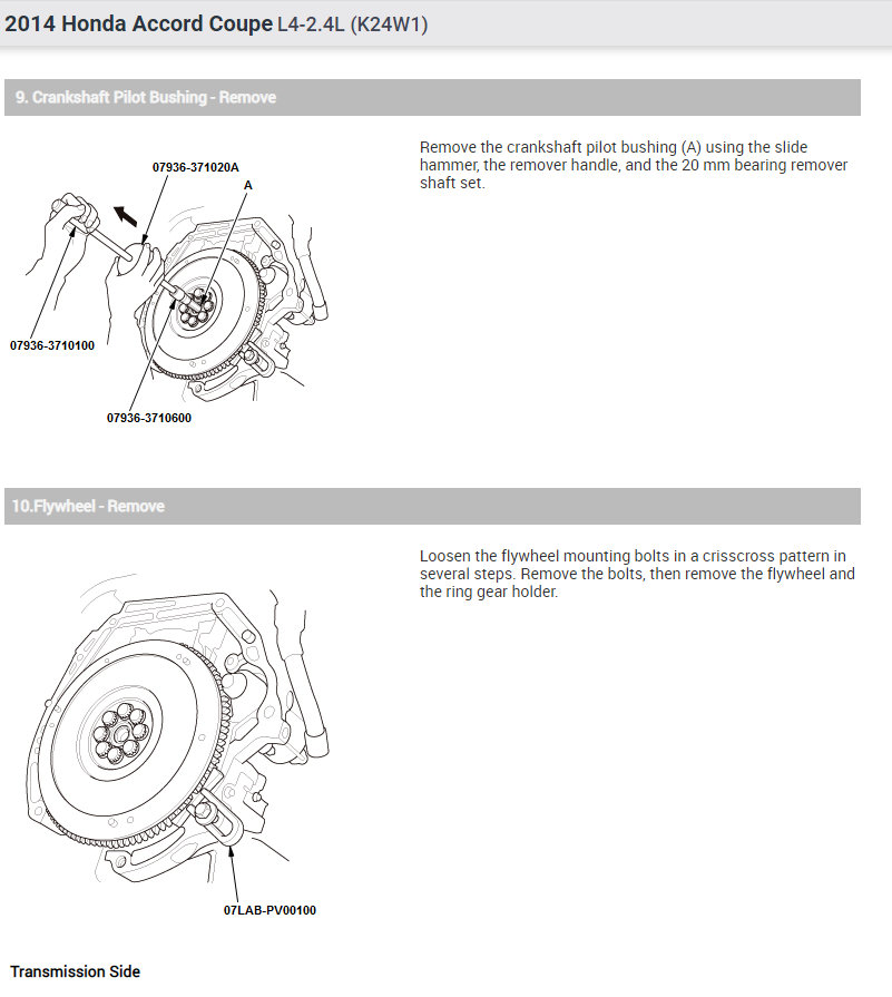

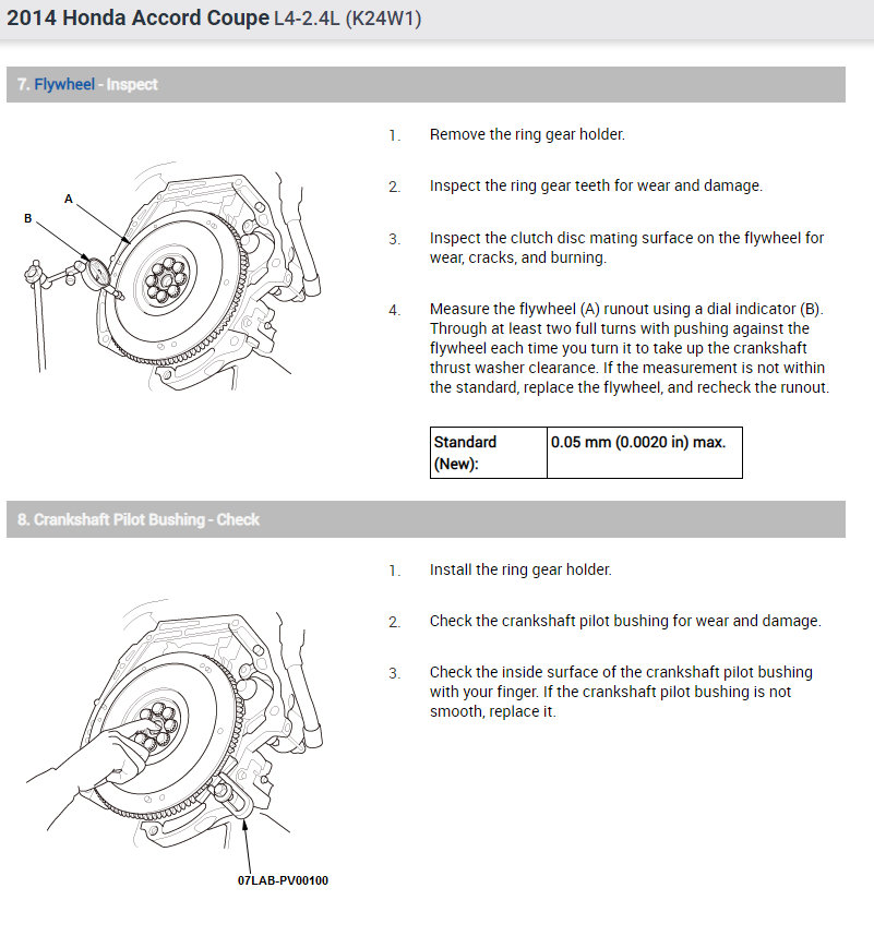

A. This job requires some specialty tools besides the typical wrenches and sockets. If you do not replace the flywheel, get it resurfaced, which can be done at your local parts store or machine shops.

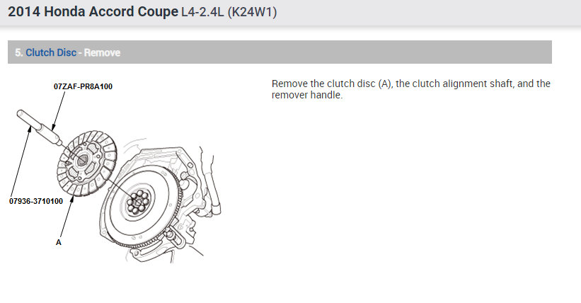

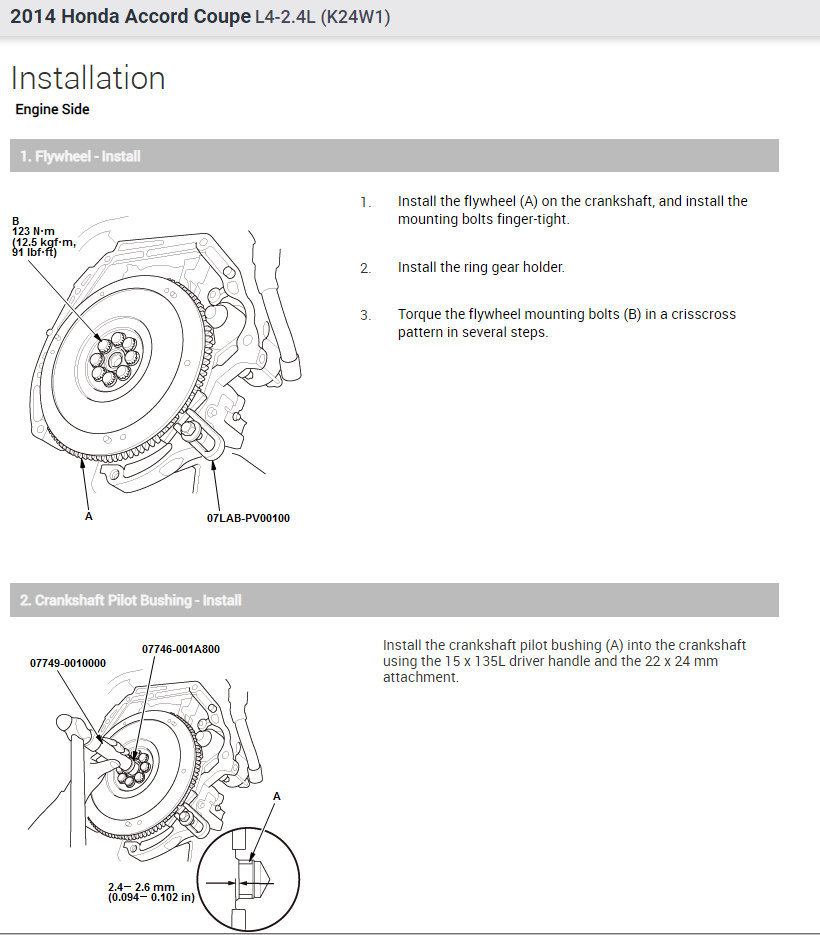

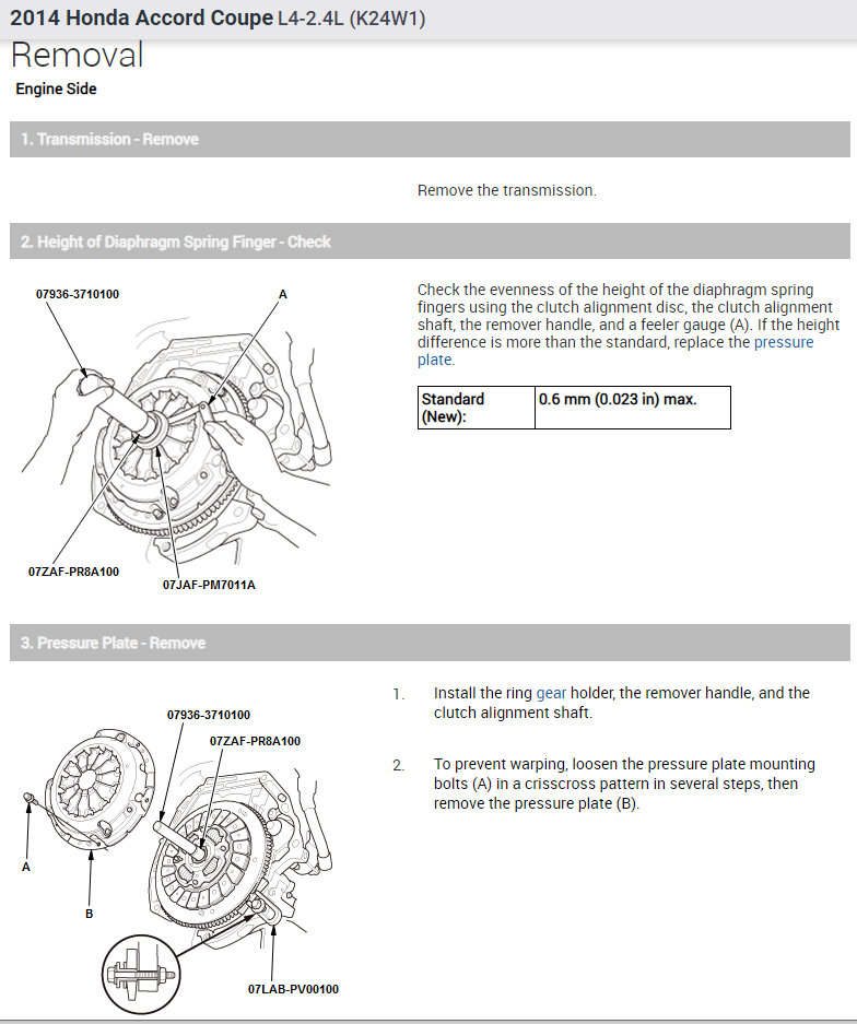

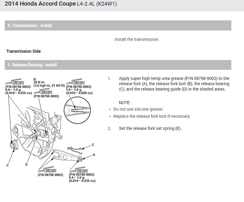

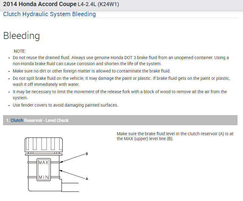

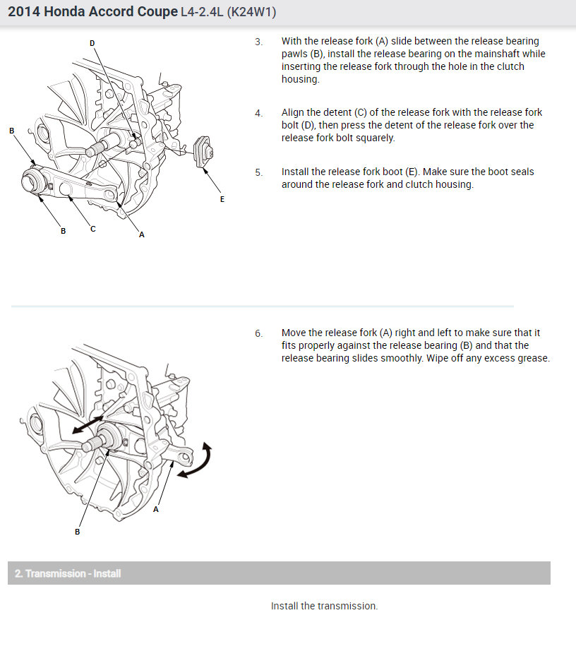

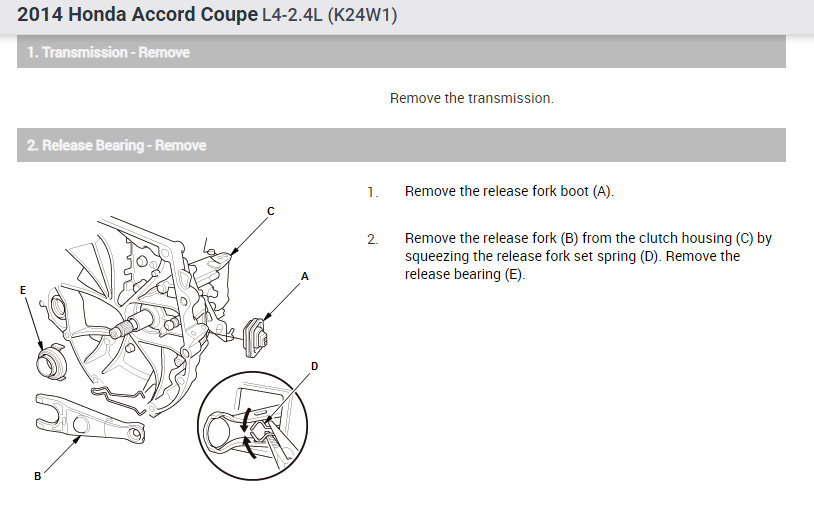

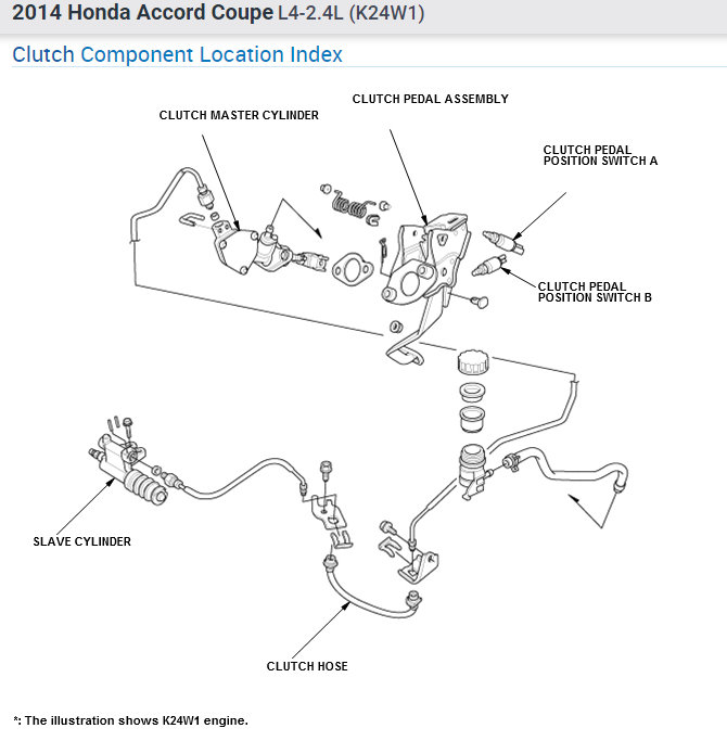

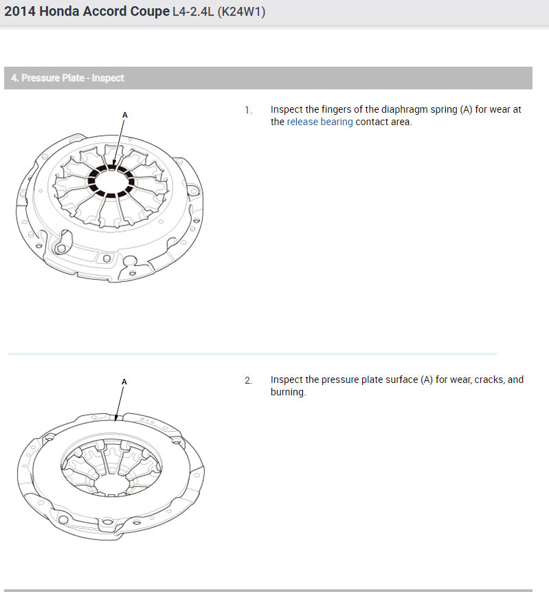

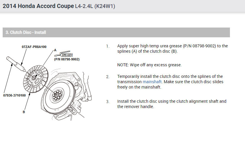

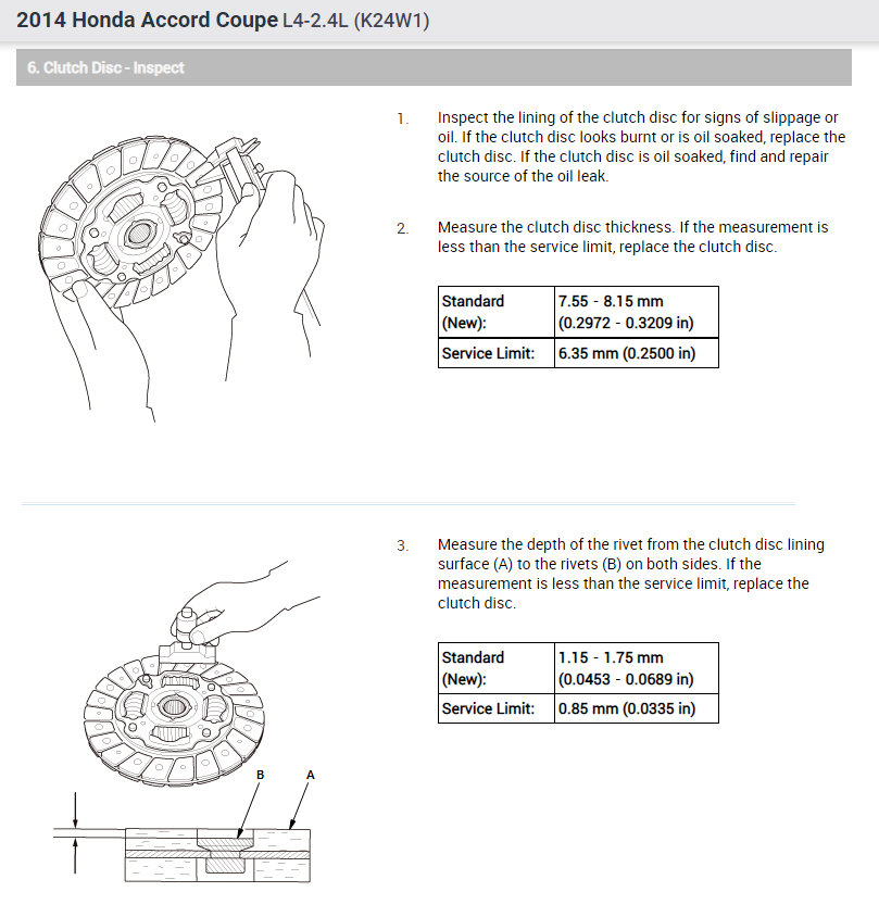

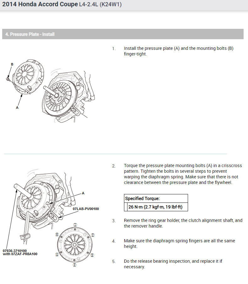

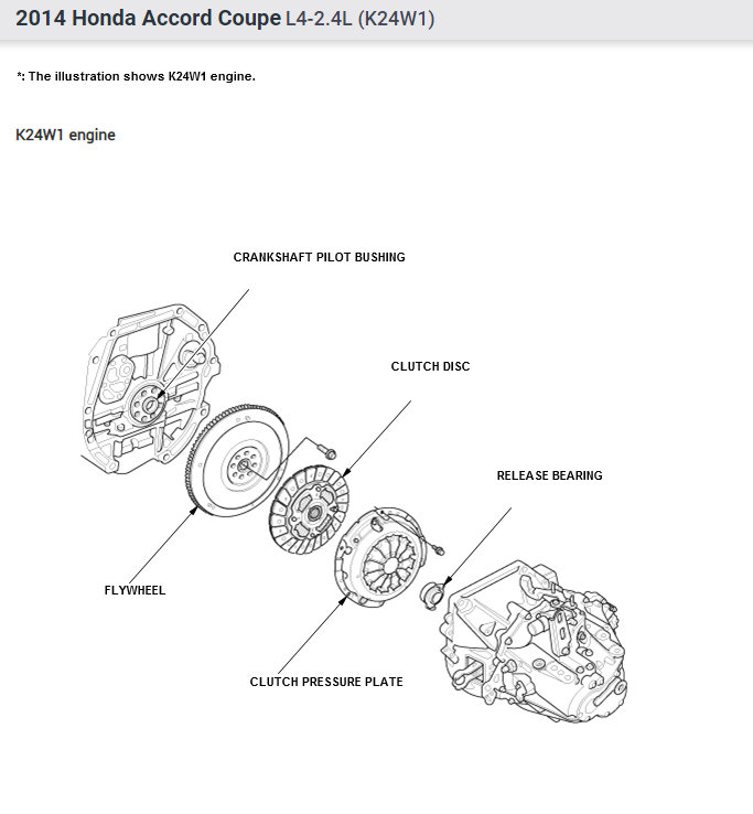

I have included the clutch replacement procedure for your reference.
