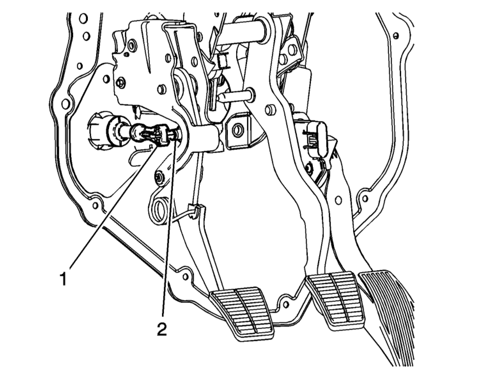

2. Disconnect the clutch master cylinder push rod (1) from the clutch pedal pin (2).

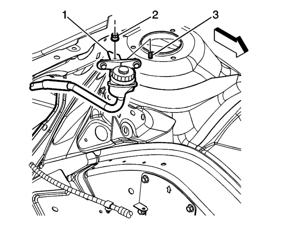

3. Remove the clutch fluid reservoir retaining nut (2).
4. Remove the clutch fluid reservoir (1) from the strut tower stud (3).

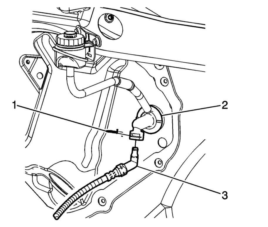

6. Important: Install a rubber cap over the exposed hose fitting in order to prevent fluid loss and contamination.
Remove the clutch hose retaining clip (1)
7. Disconnect the clutch hydraulic hose (3) from the clutch master cylinder (2).

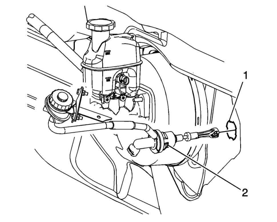

8. Rotate the clutch master cylinder (2) clockwise 1/8 turn.
9. Remove the clutch master cylinder (2) from the cowl (1).
