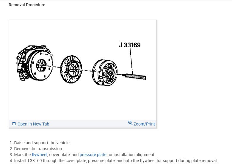

I have the clutch kit I have never replaced a clutch before. Do I have to remove the transmission completely?
Nov 4, 2022 at 11:41 AM
  • 110,244 POSTS

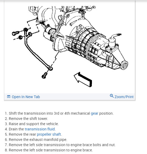

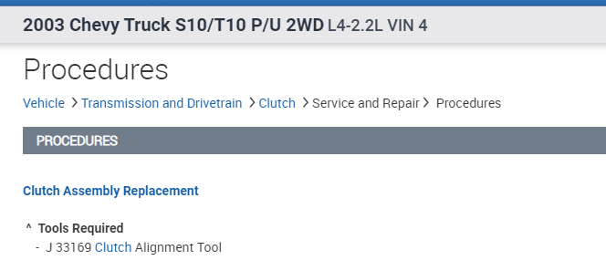

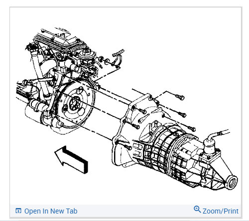

The transmission will need to be removed to access and remove/replace the clutch disc, pressure plate, and release bearing.

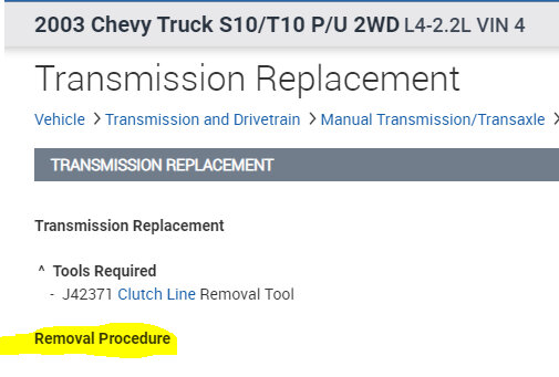

This model wasn't offered in the US. I know years back the Chevrolet S10 was basically the same vehicle, but they changed after 2004.

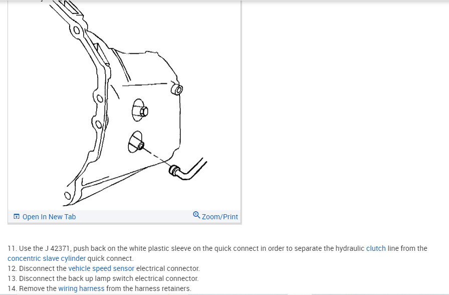

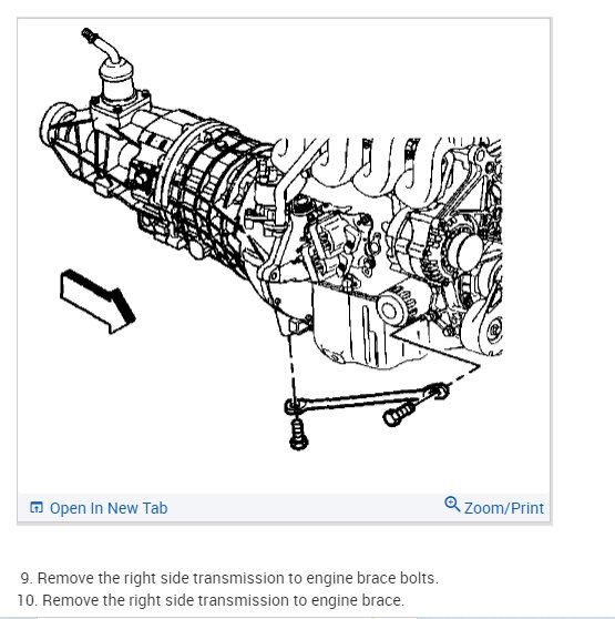

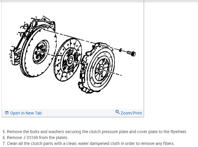

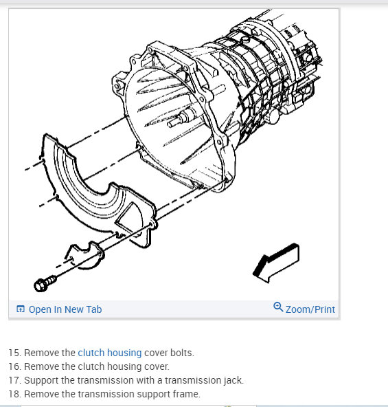

Regardless, I am attaching the directions below for replacing everything on an S10. It won't be identical, but it does provide pics and what will need to be done. Additionally, here is a link that explains the procedure in general:
https://www.2carpros.com/articles/how-to-replace-a-clutch
If you run into trouble, let me know and I'll try my best to help.
Let me know if this helps.
