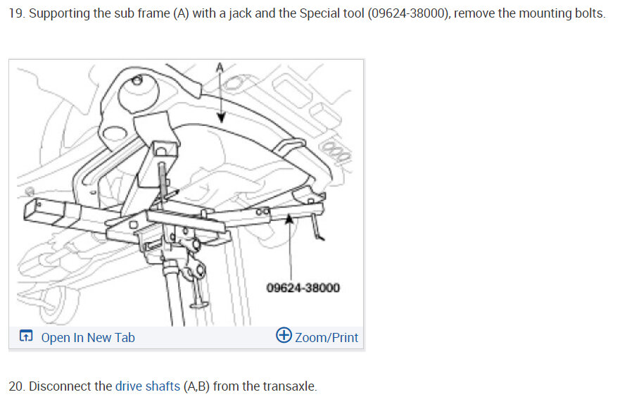

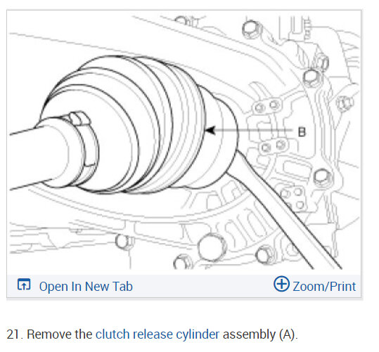

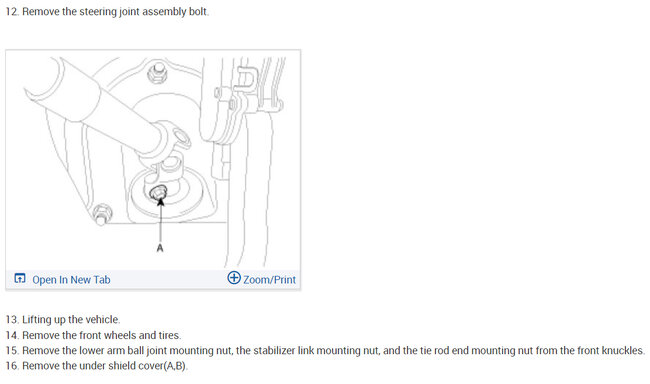

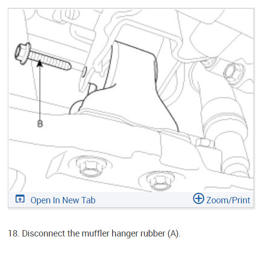

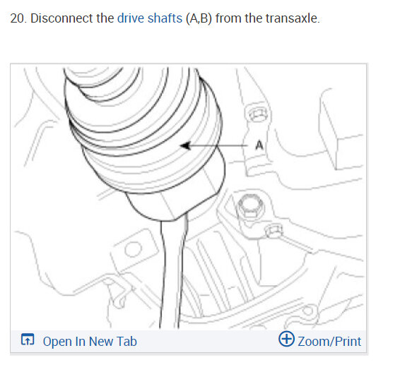

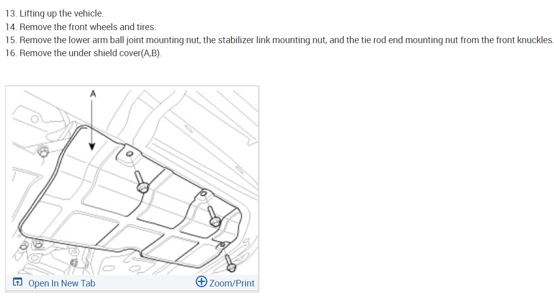

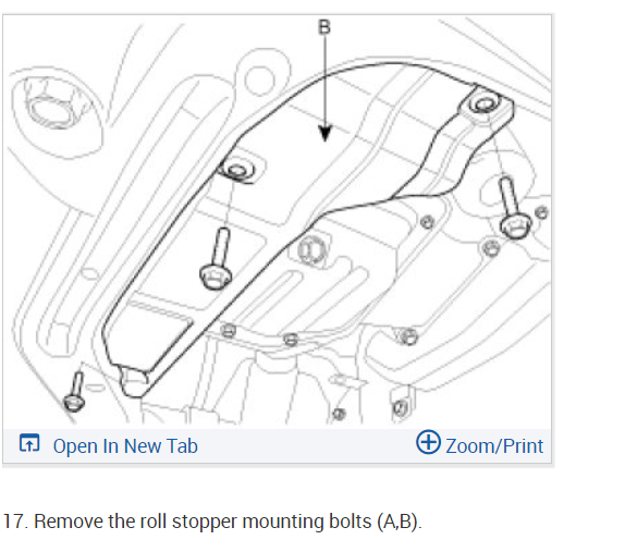

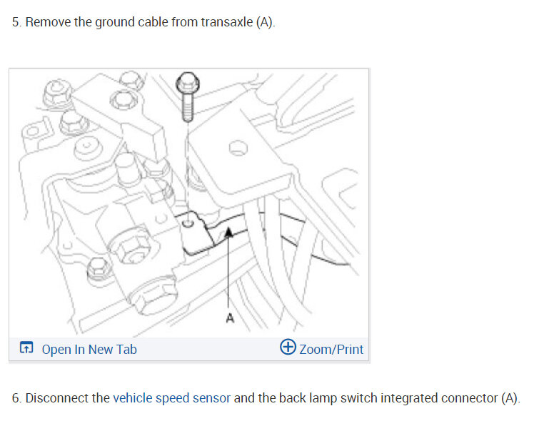

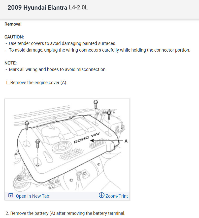

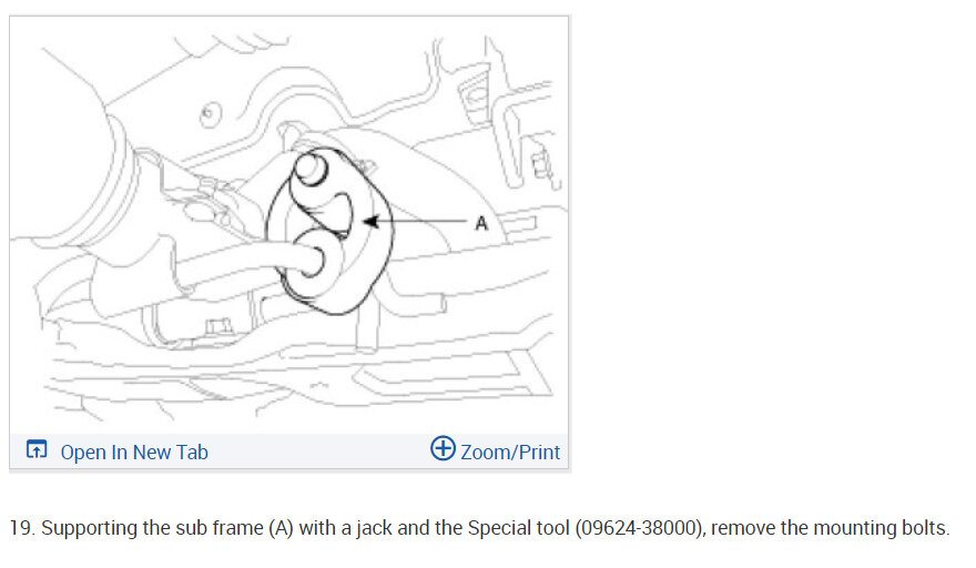

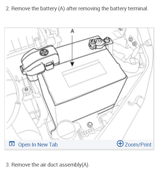

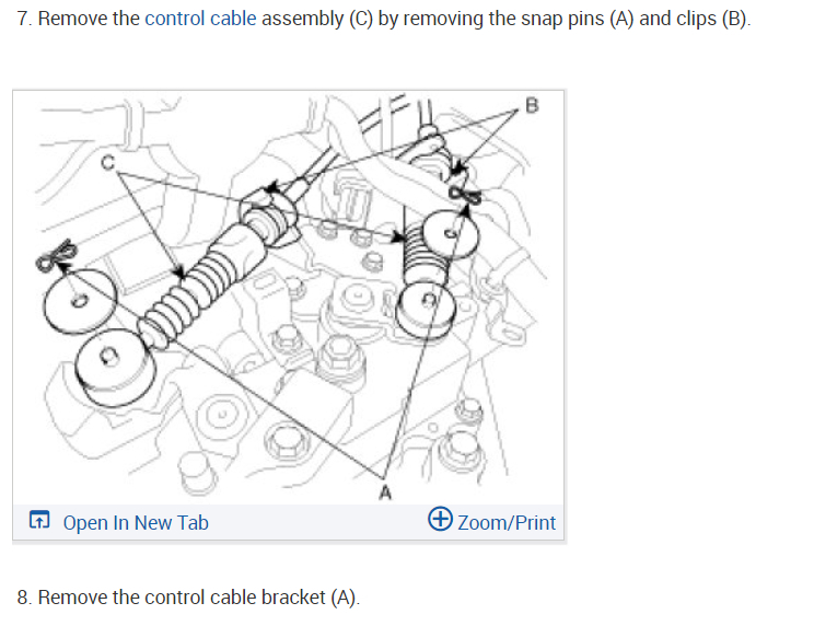

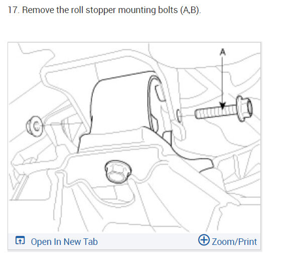

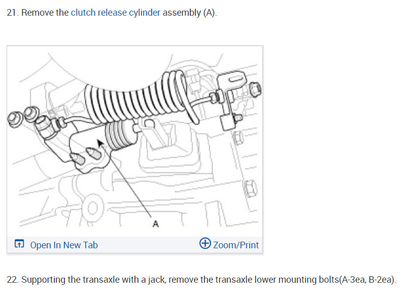

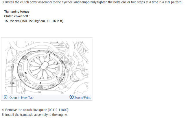

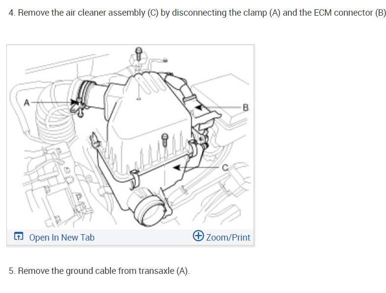

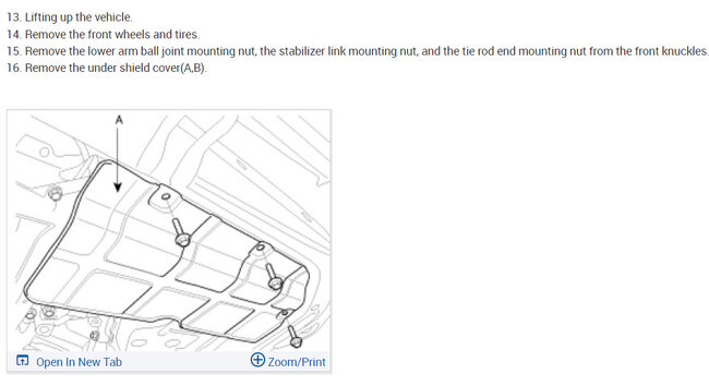

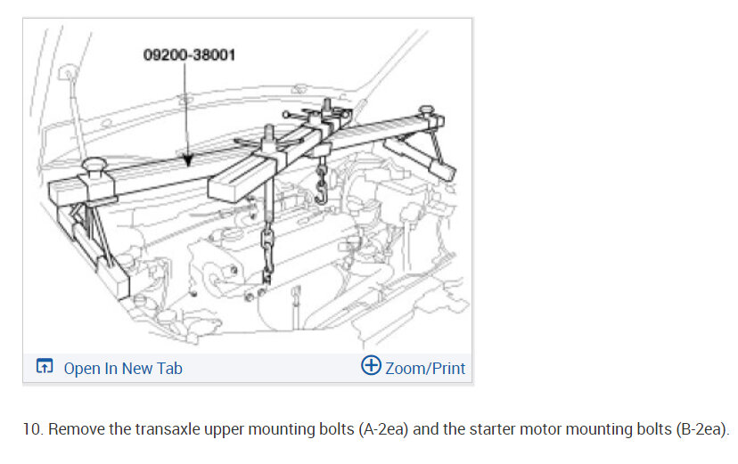

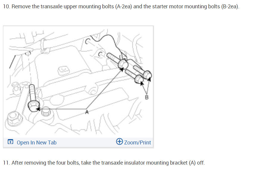

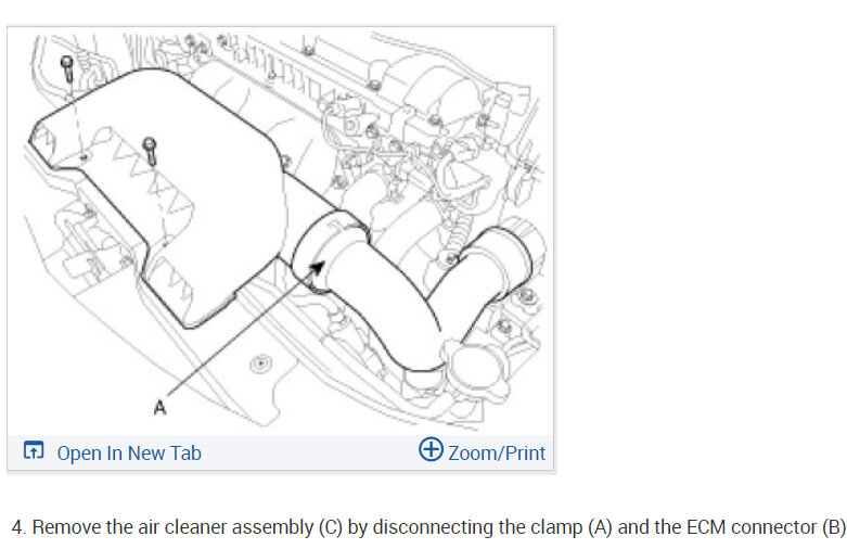

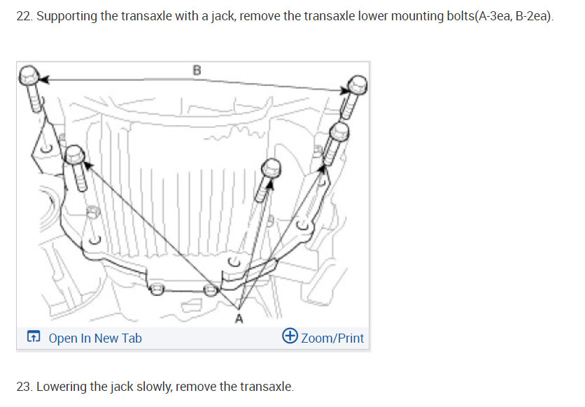

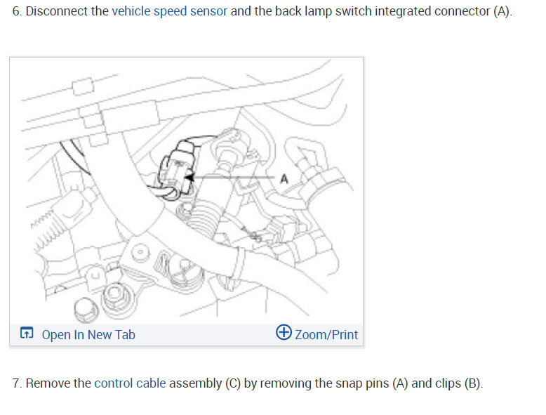

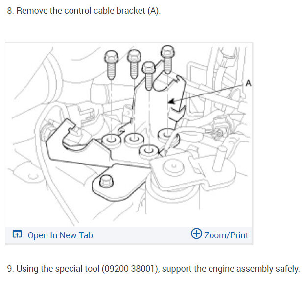

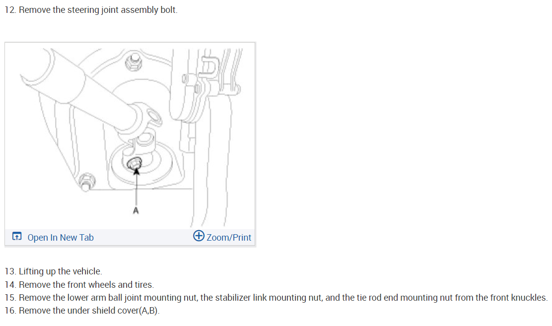

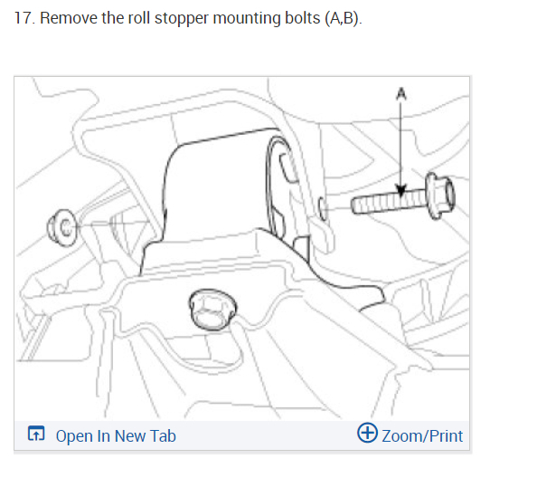

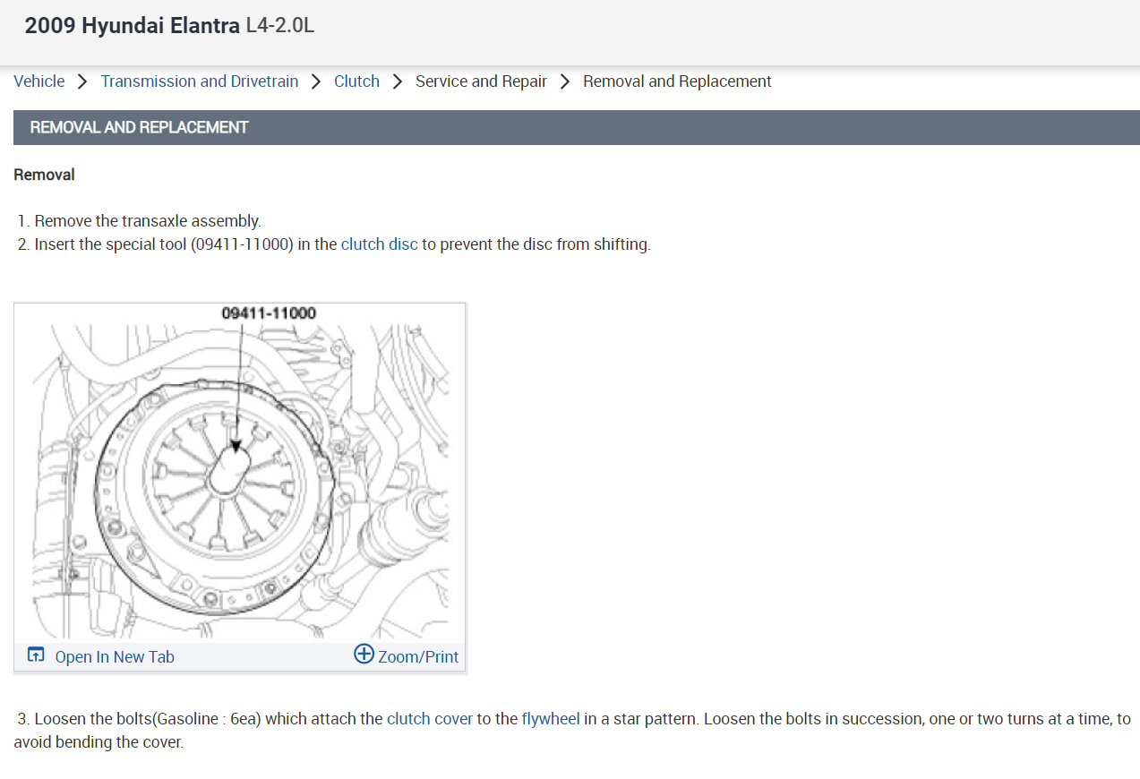

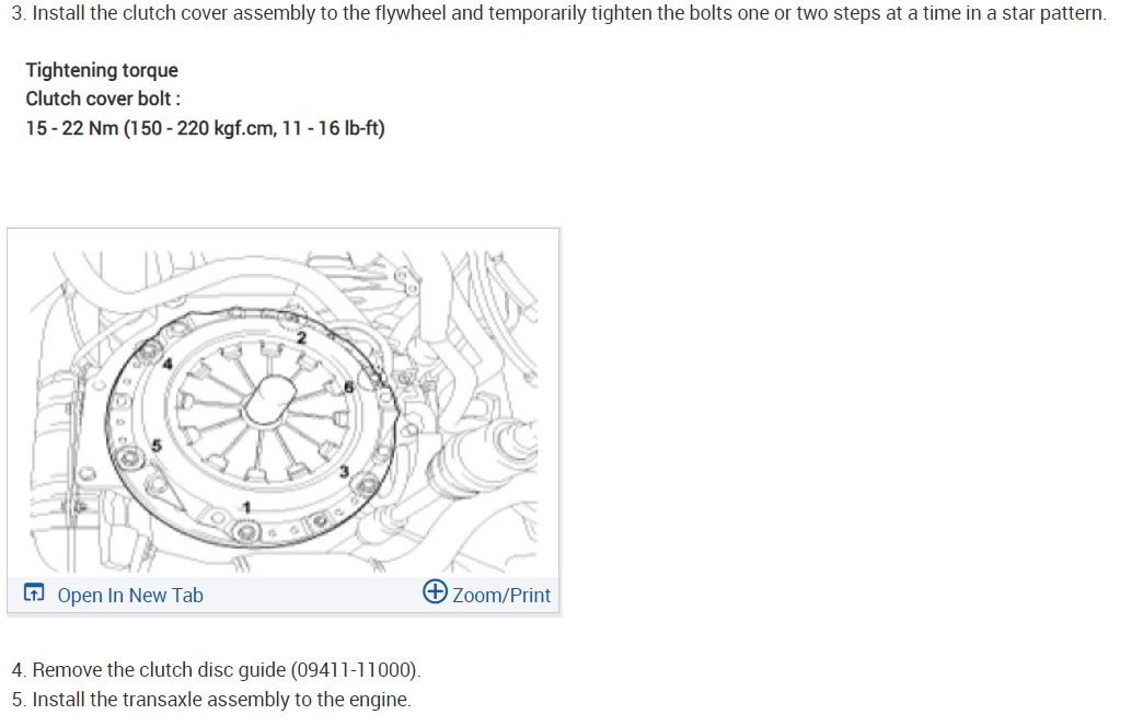

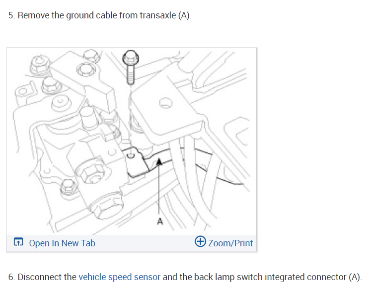

Okay, this is a big job and you will need an engine cradle hoist (top) and the lower subframe will need to be removed, I would start by disconnecting the battery, also please watch this video it is basically the same job and the car is very similar with the same steps.
https://youtu.be/6N6b5F2ChyE?si=HxGcuyd2PF4-0c3Z
Here are the steps for your car in the images below. Check out the images (below). Please upload pictures or videos in your response of any problems so we can see what to help you with.
