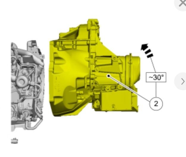

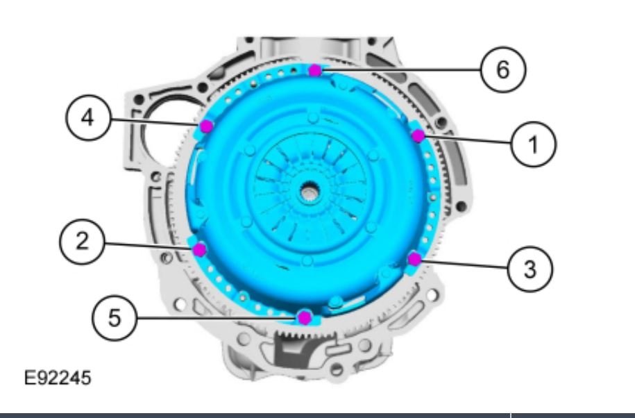

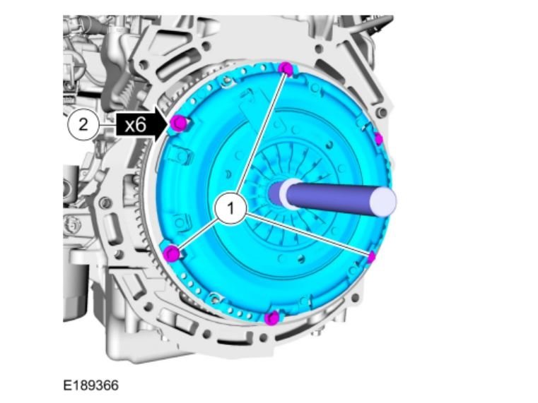

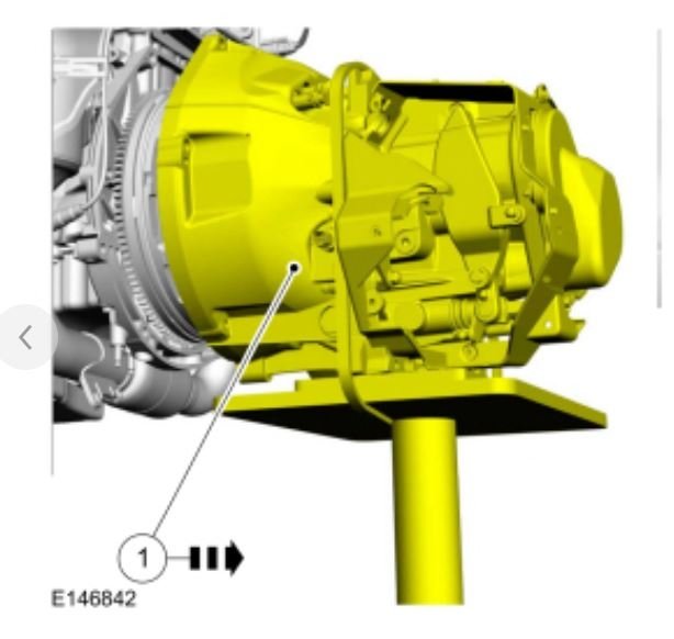

The clutch is worn out and is slipping. The clutch needs to be replaced. The transmission will have to be removed in order to access the clutch assembly itself.
I attached a YouTube video of the procedure for you to view.
https://www.youtube.com/watch?v=6N6b5F2ChyE&t=1814s
