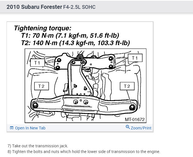

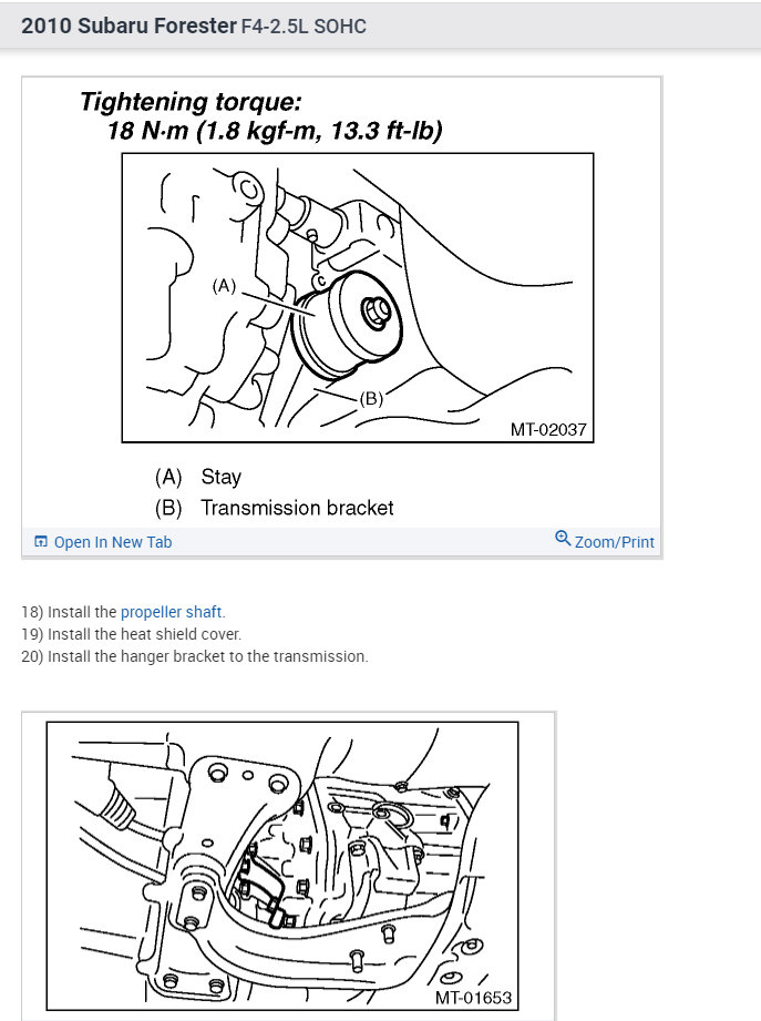

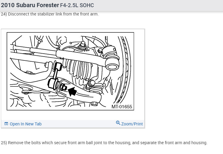

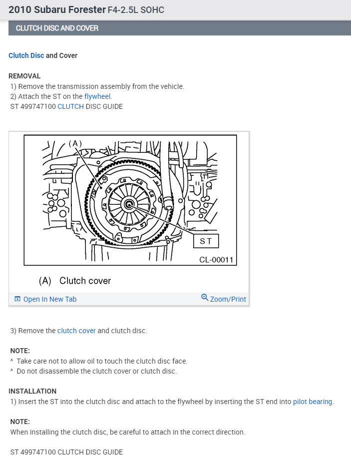

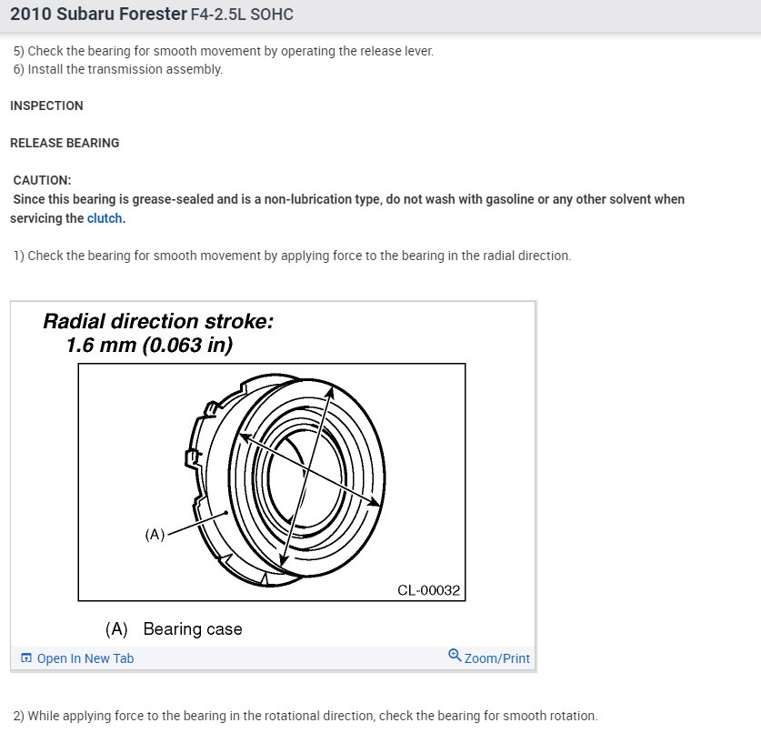

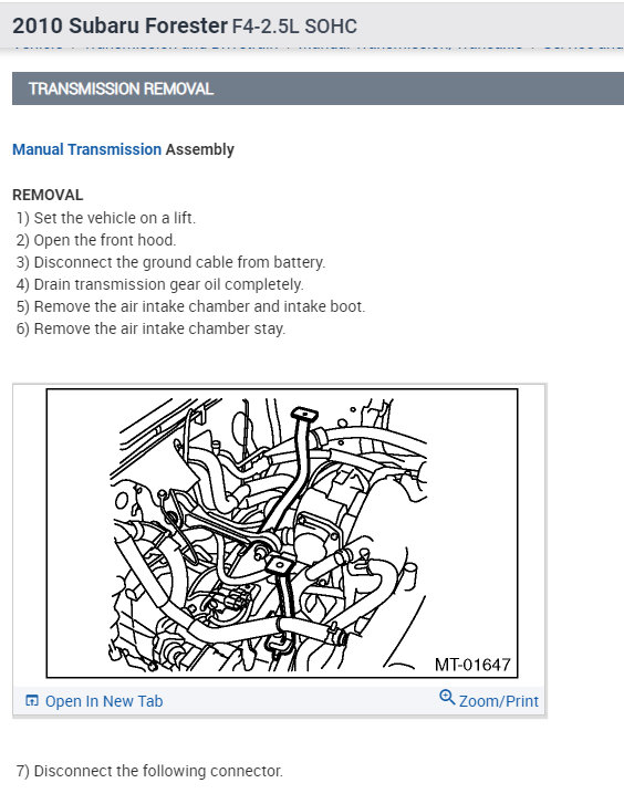

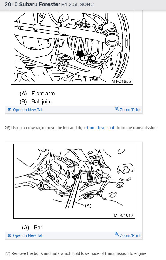

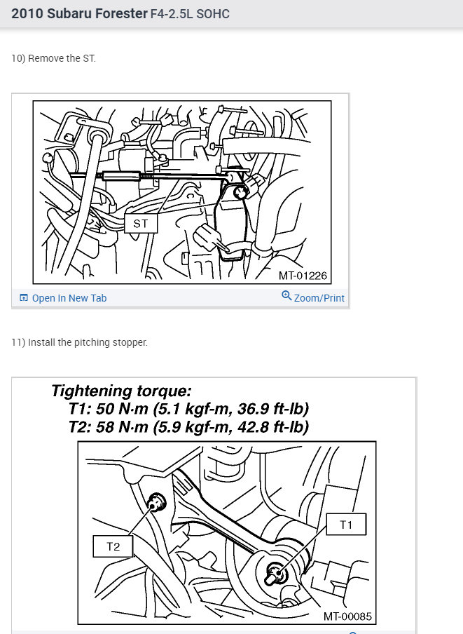

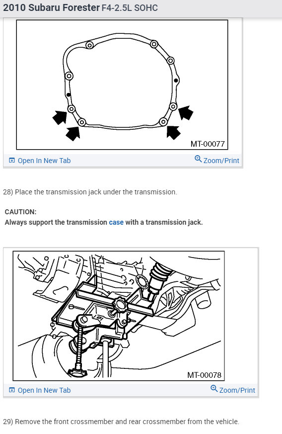

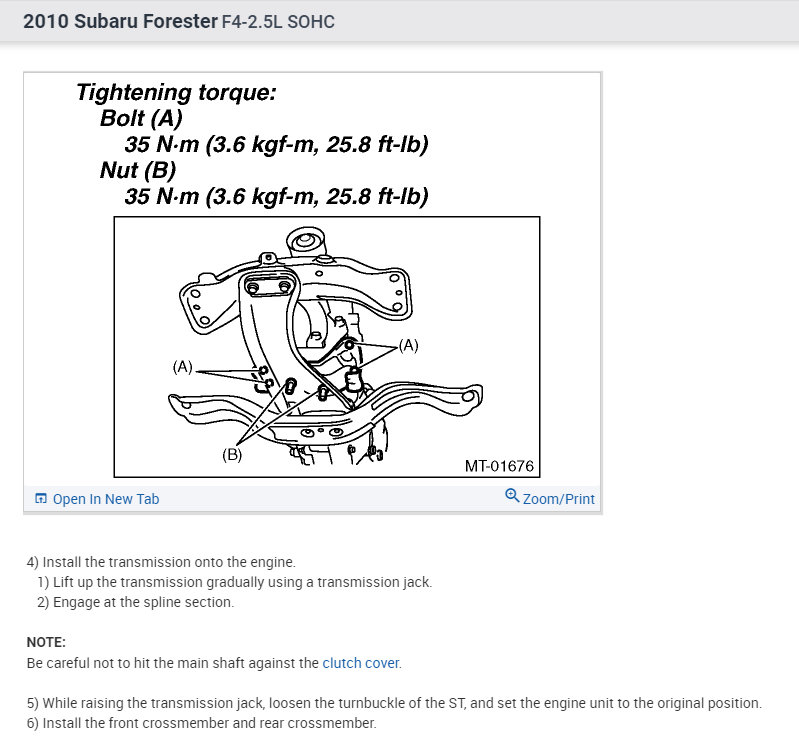

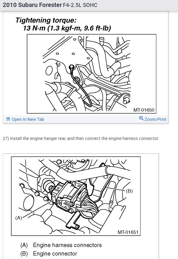

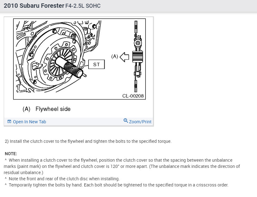

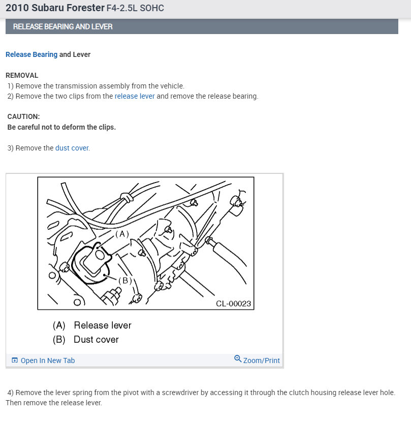

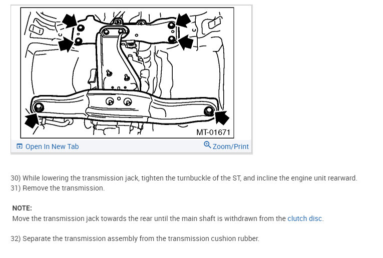

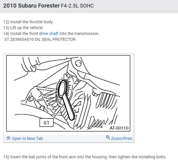

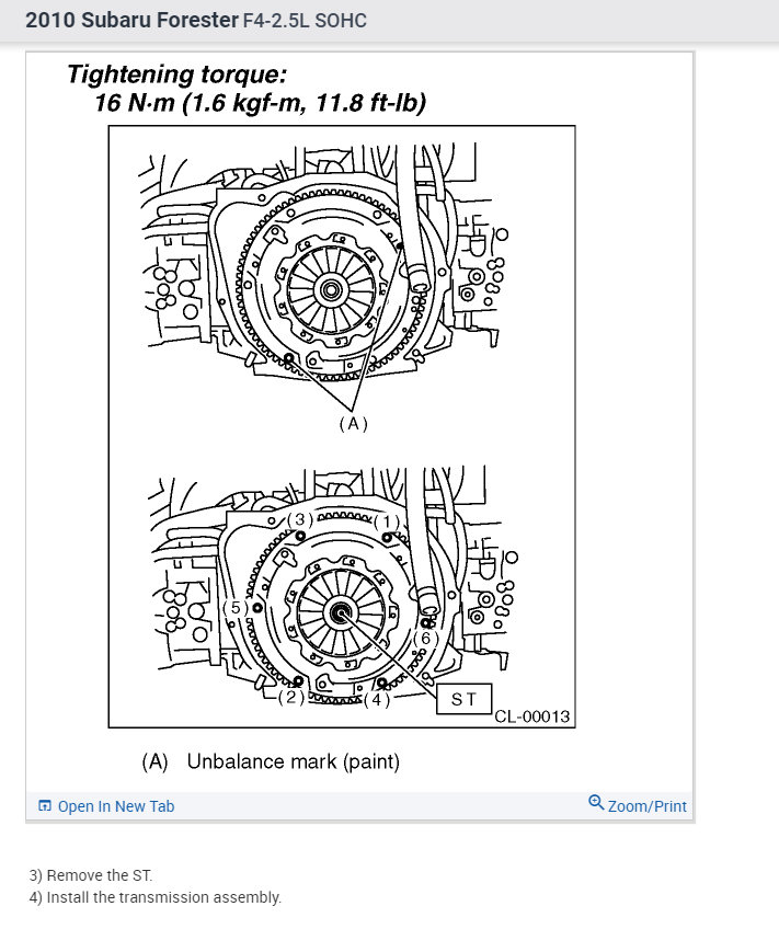

The fork is broken i am sure as it's very loose on the inside. I need to remove the transmission to change the clutch. any instructions would be great.
Jun 9, 2022 at 1:29 AM
SQM
  • 6,383 POSTS

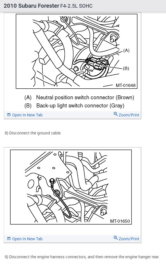

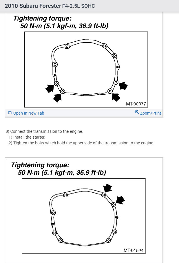

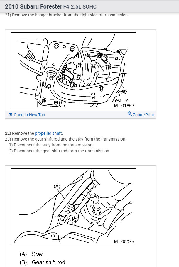

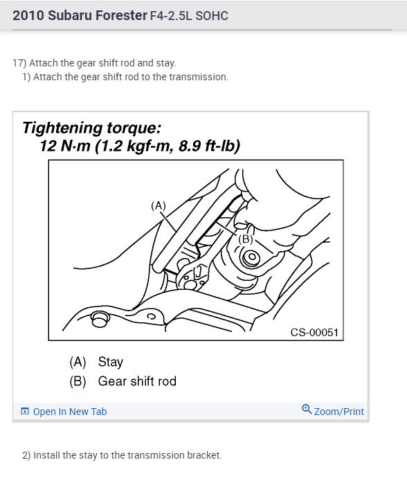

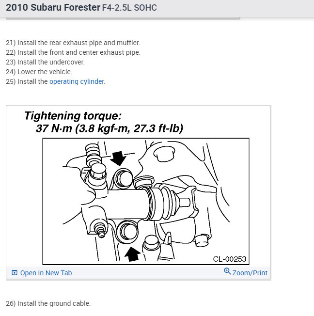

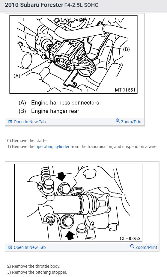

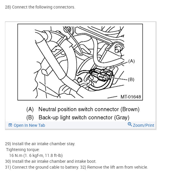

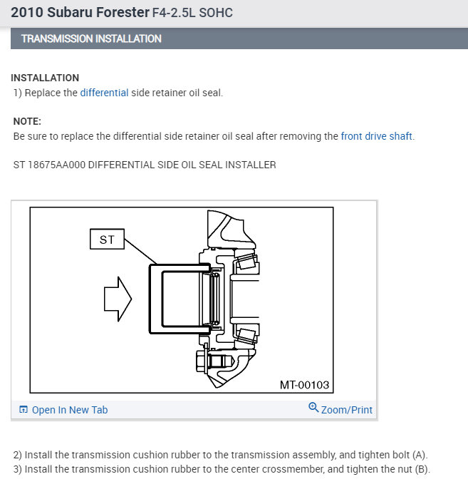

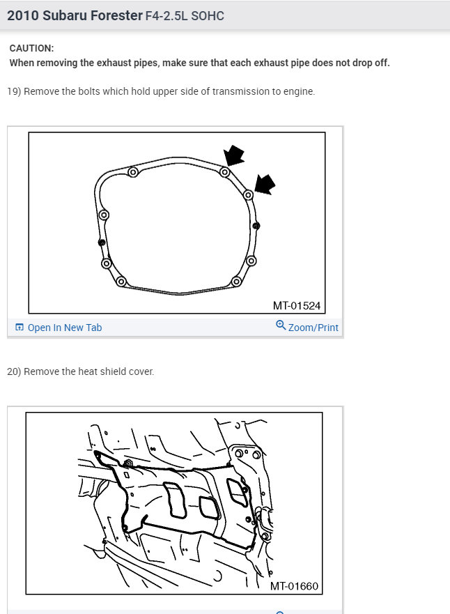

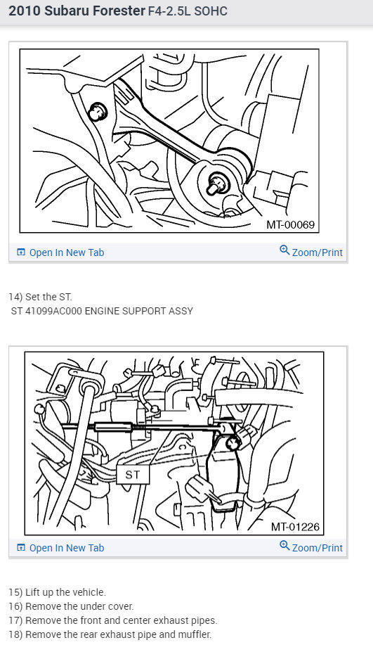

See below, I have attached the transmission removal and installation process as well as clutch and fork replacement procedures.
https://www.2carpros.com/articles/transmission-replacement-removal-manual
https://www.2carpros.com/articles/how-to-replace-a-clutch
Let me know of any questions.
Jun 9, 2022 at 1:56 AM

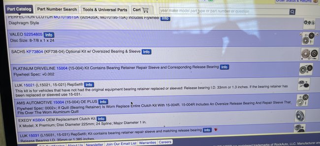

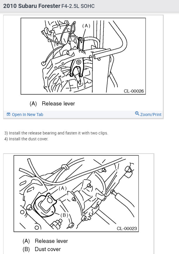

Do you know what they mean by this: about the retainer if worn replace with this clutch set which includes an oversized one or the chat about kit contains bearing retainer repair sleeve. All i know is the fork, pilot bearing, throw out bearing, clutch plates when it comes to a clutch.
Jun 9, 2022 at 11:15 PM
SQM
  • 6,383 POSTS
Not sure what they mean by the retainer. It could be the clutch fork retainer clip. Usually that comes with new component.

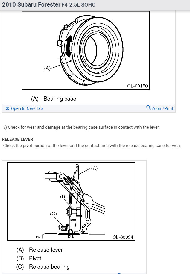

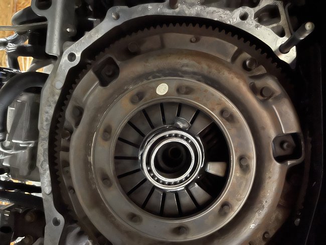

Just got it out, jeez, never seen a broken bearing stuck in the pressure plate like this before. Is there a rear seal behind the flywheel that i can change?
Jun 12, 2022 at 9:01 AM
BHAMDOC1973
  • 2,007 POSTS

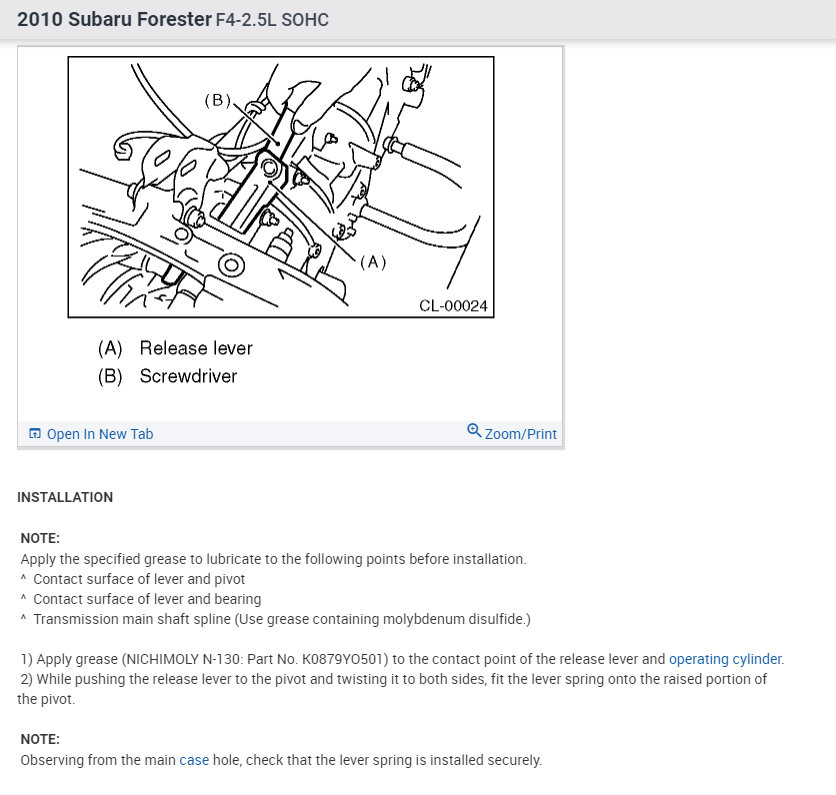

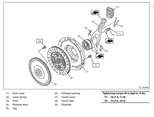

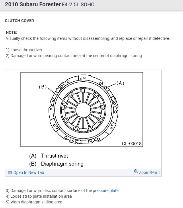

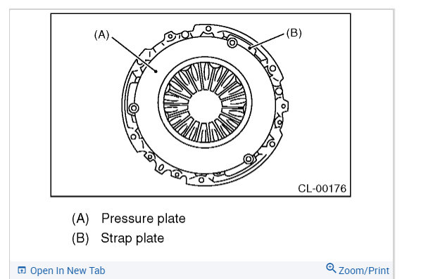

Can you find out if this car has a clutch release bearing clip (which i don't know what it does) or just a clutch spring?
Jun 12, 2022 at 9:15 AM
SQM
  • 6,383 POSTS

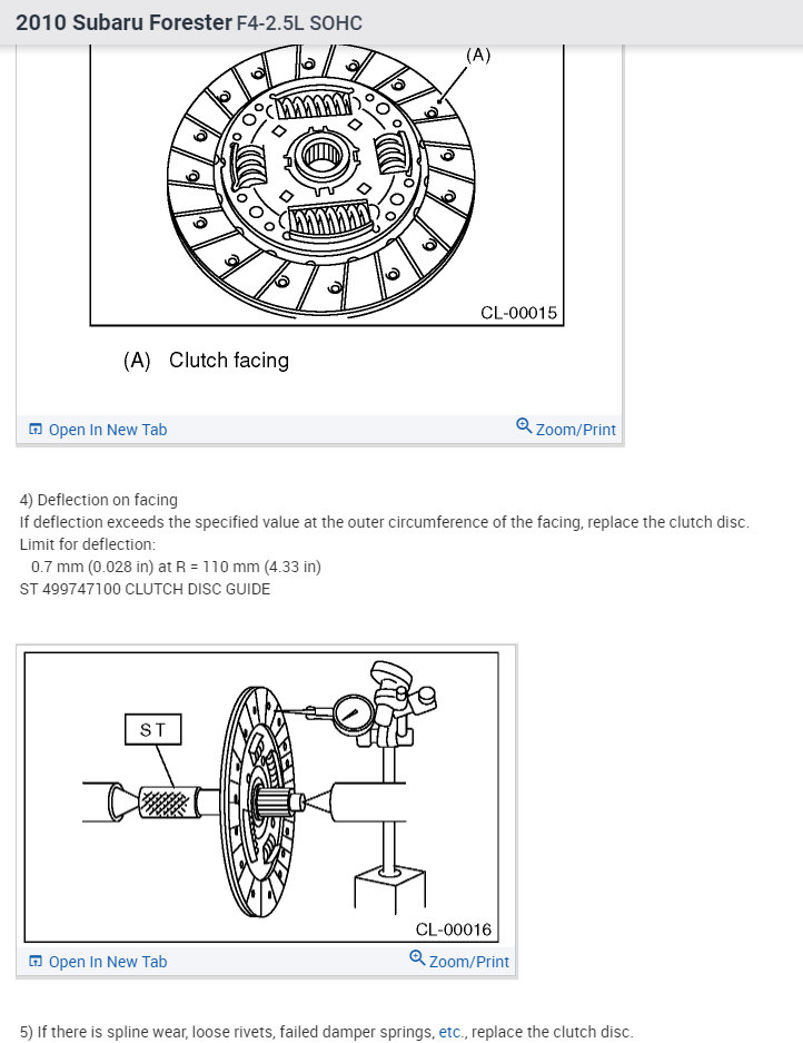

See attached. It shows the exploded view of the clutch.
Jun 12, 2022 at 3:46 PM

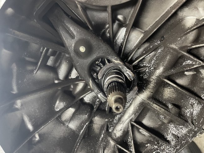

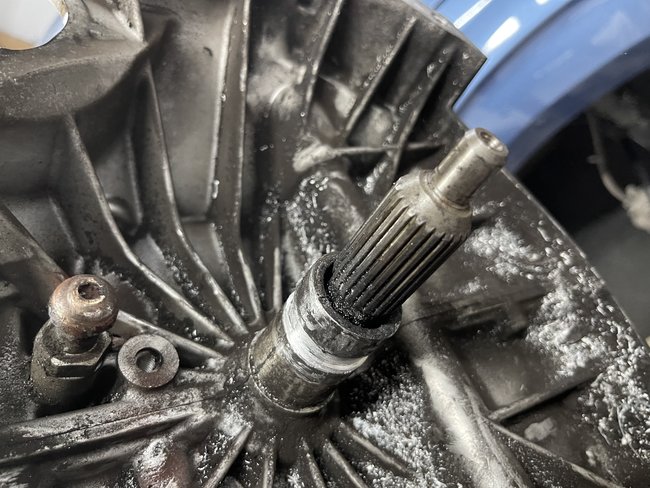

Do you think this will affect anything? There was rubbing on the shaft not sure if it is supposed to have that groove, but most of the shavings came from the bearing itself.
Jun 14, 2022 at 1:41 AM
SQM
  • 6,383 POSTS
This could be an issue, might create unnecessary movement or wiggle room. Which can create other problems.
Jun 14, 2022 at 8:33 AM

Have you tried to slide on the bearing and see if it has any free play?
Jun 14, 2022 at 1:34 PM

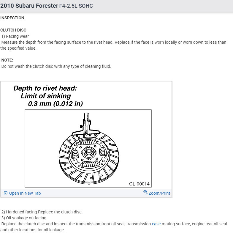

Got another transmission for it. Here is what the bearing did:
Jun 22, 2022 at 6:55 AM
SQM
  • 6,383 POSTS
Wow, the pressure plate is done as well.
Jun 22, 2022 at 7:49 AM
