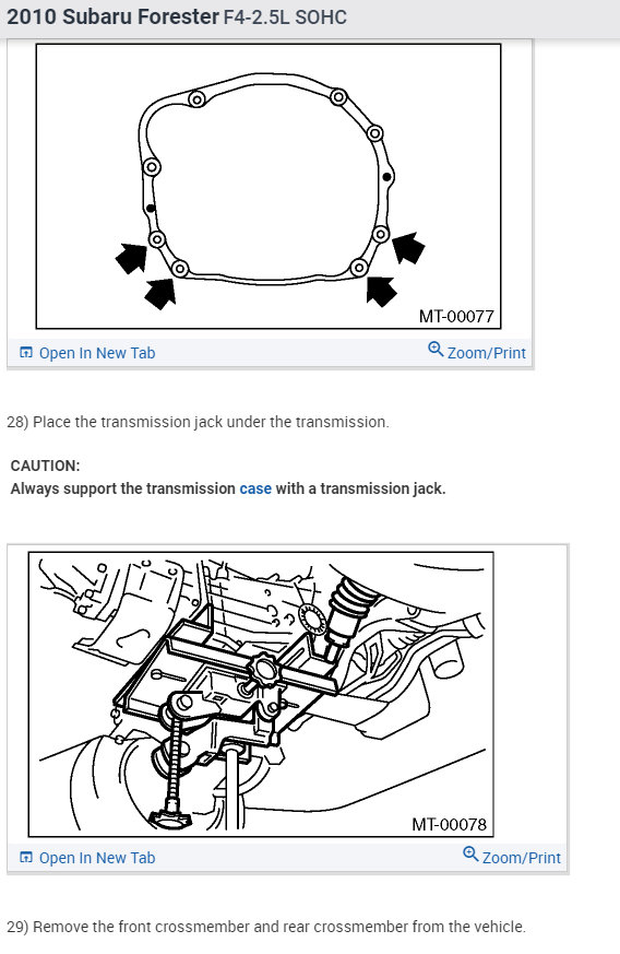

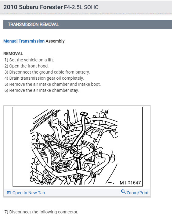

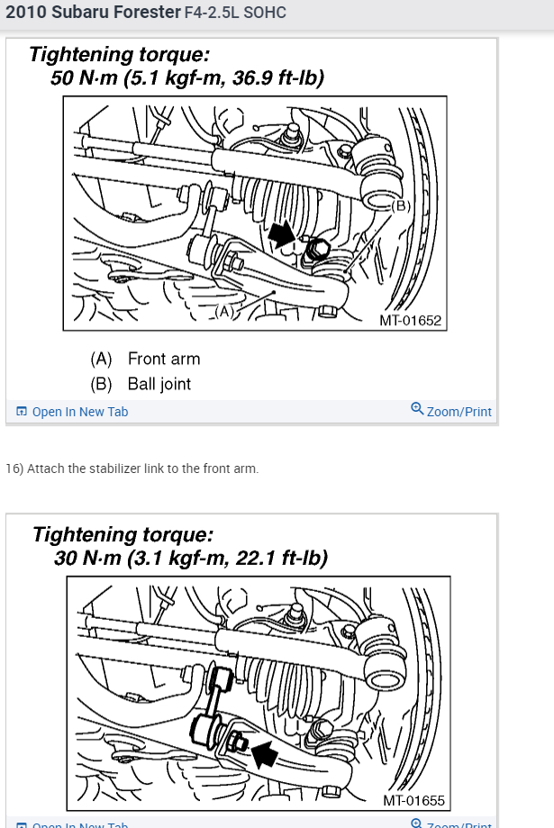

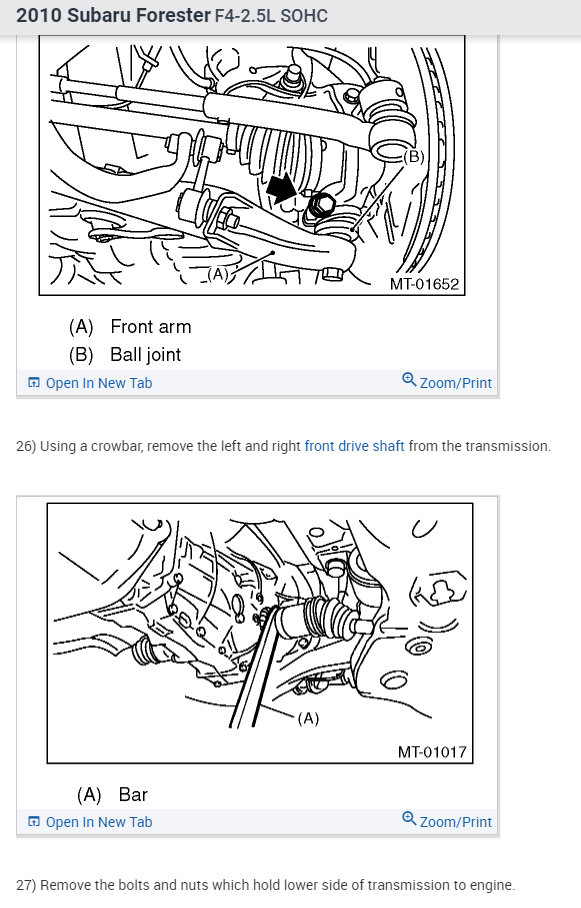

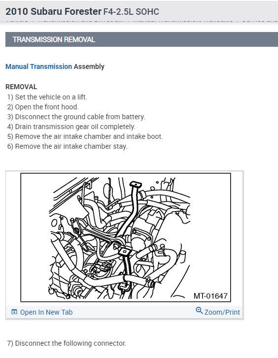

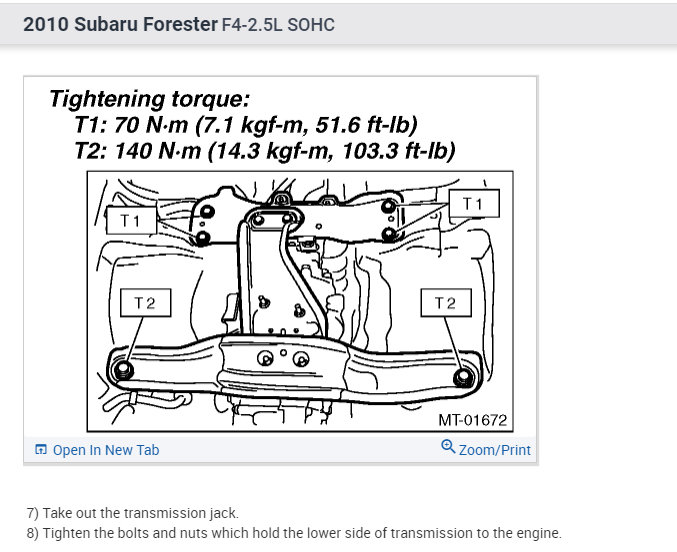

The fork is broken i am sure as it's very loose on the inside. I need to remove the transmission to change the clutch. any instructions would be great.
Jun 9, 2022 at 1:29 AM
SQM
  • 6,383 POSTS

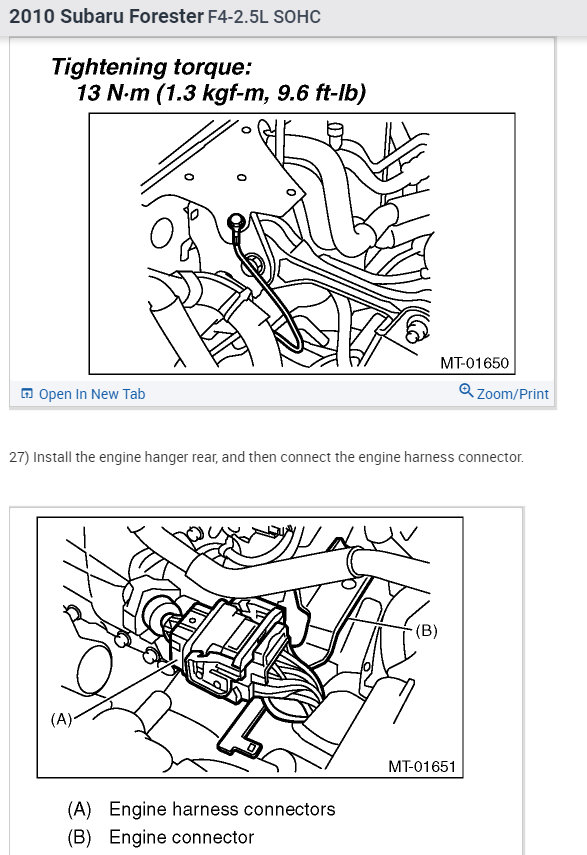

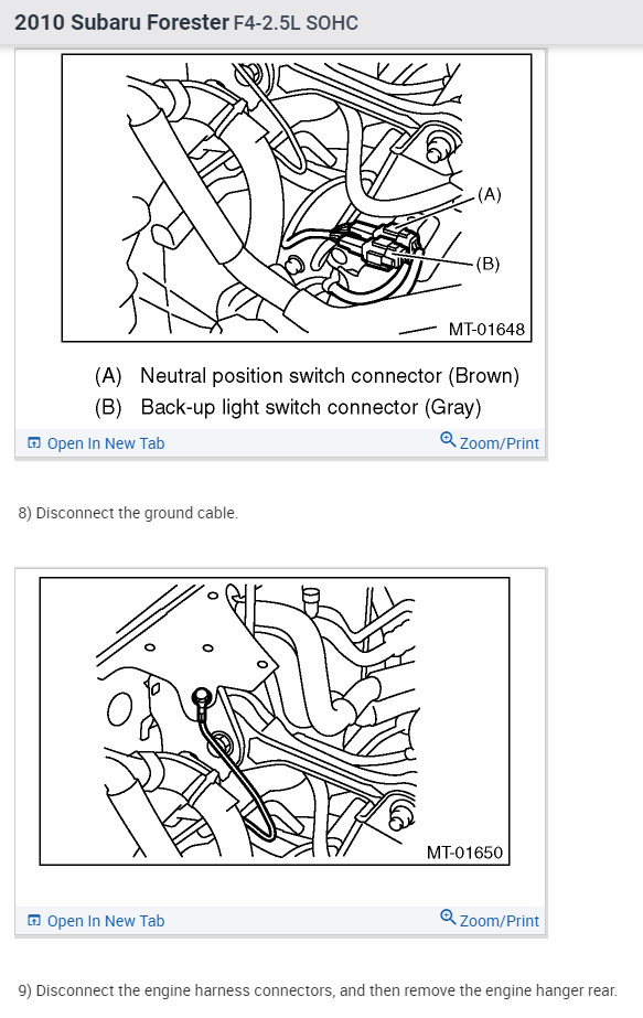

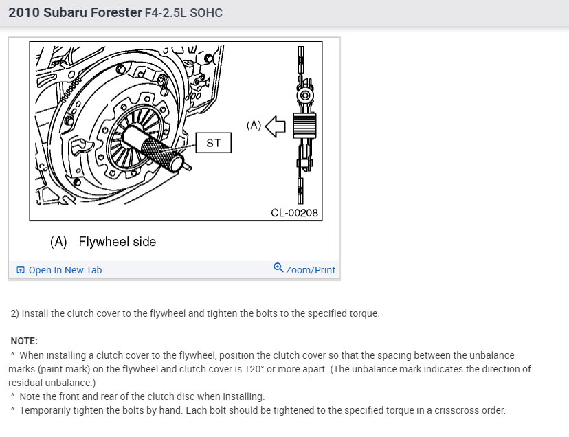

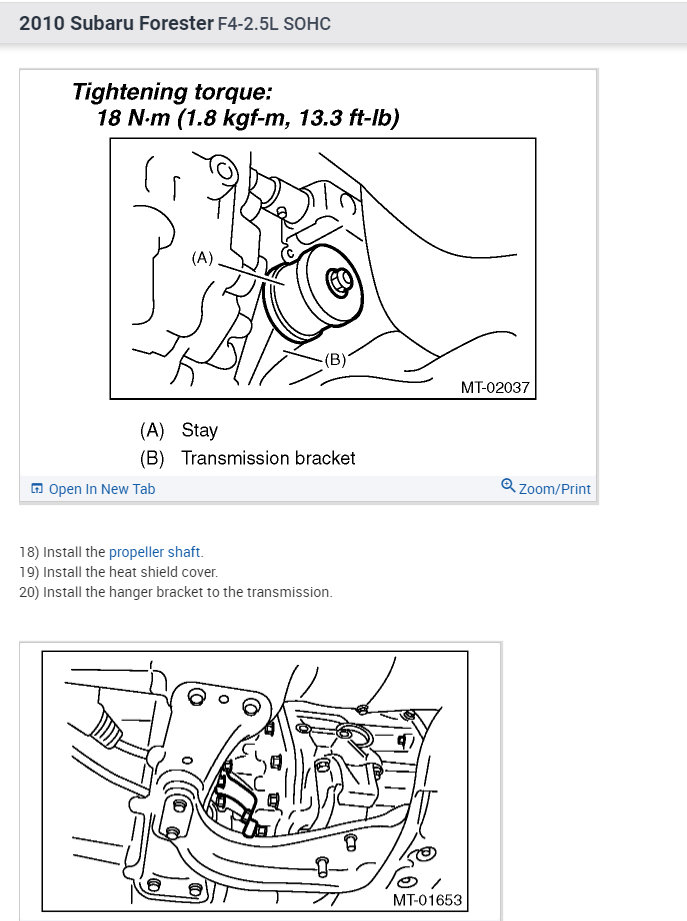

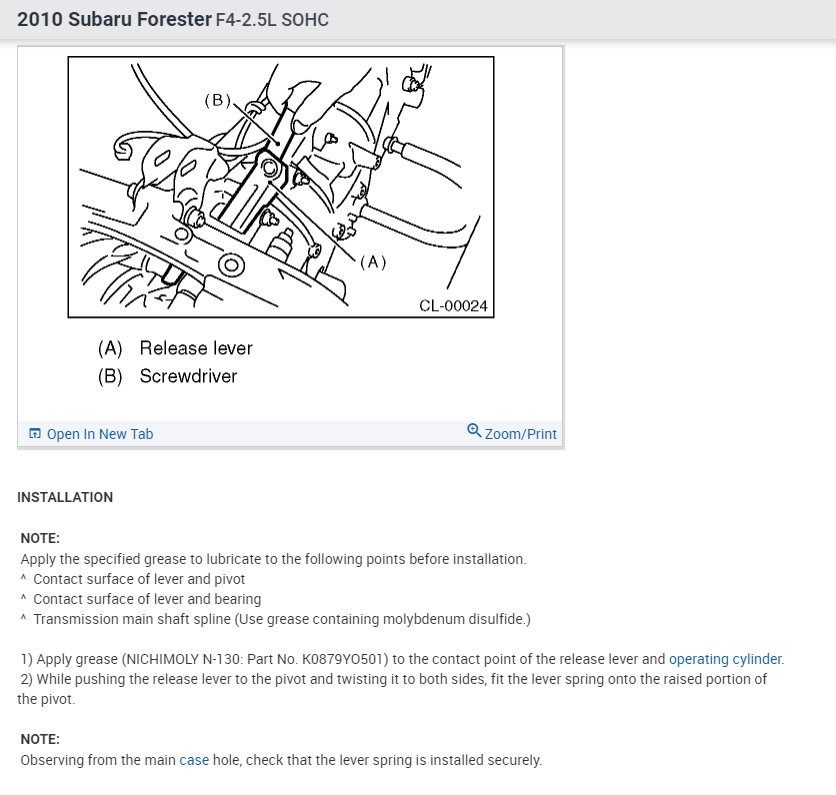

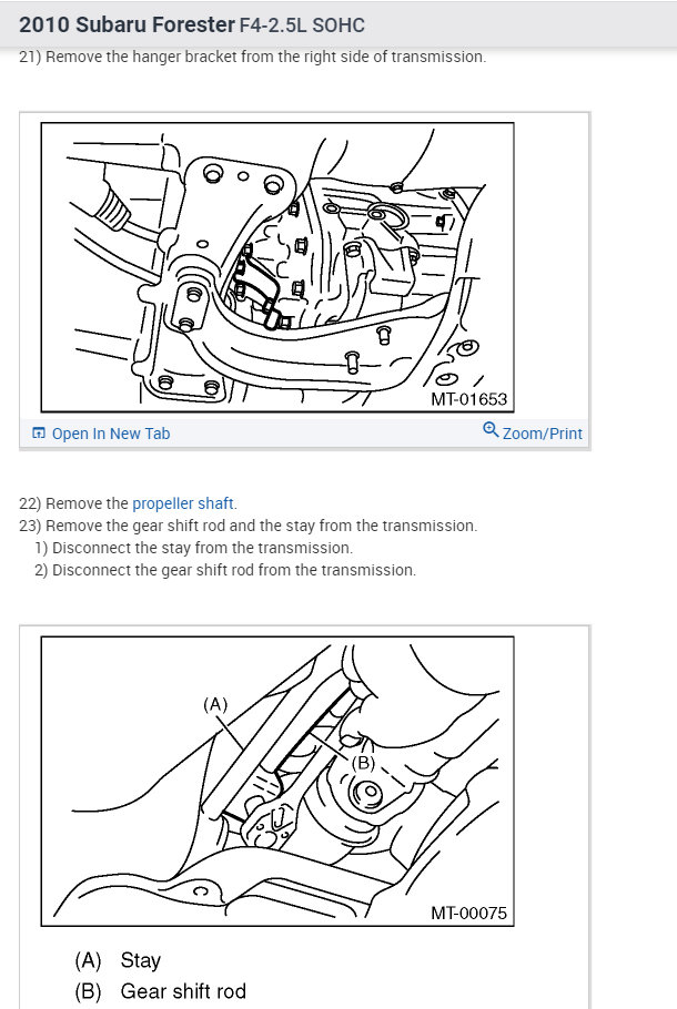

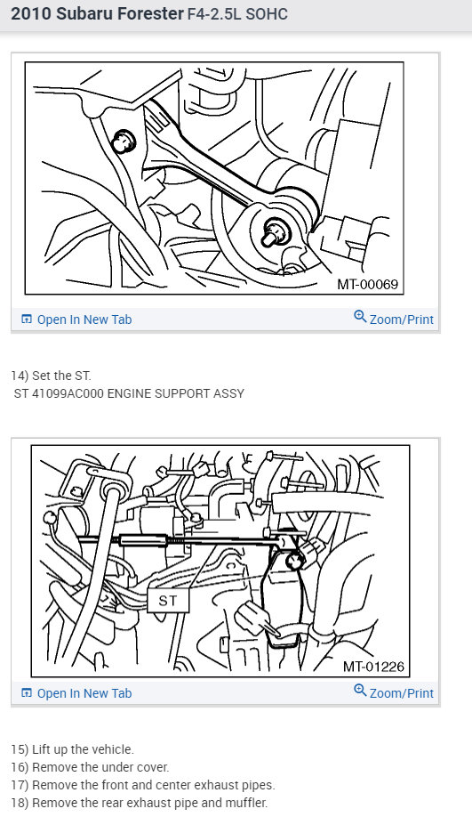

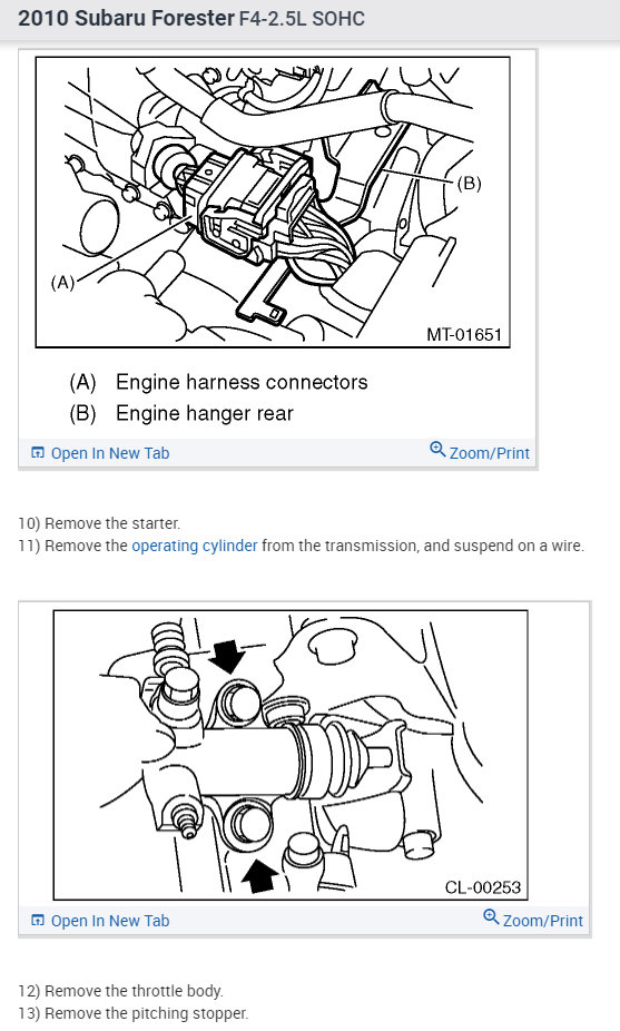

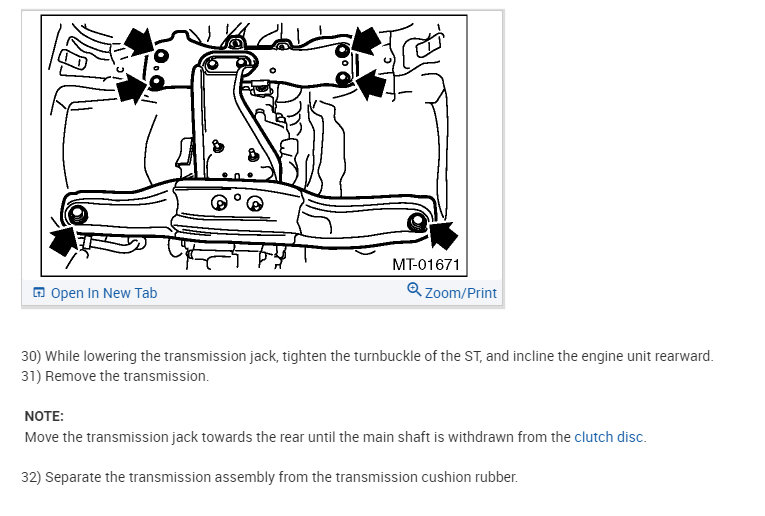

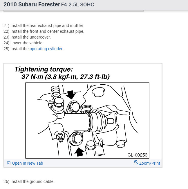

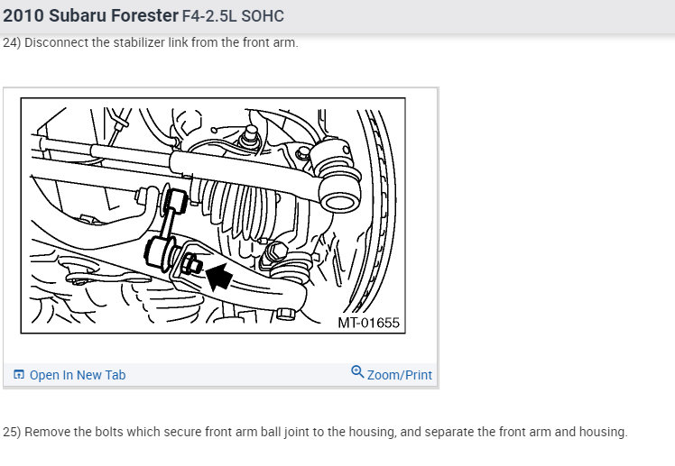

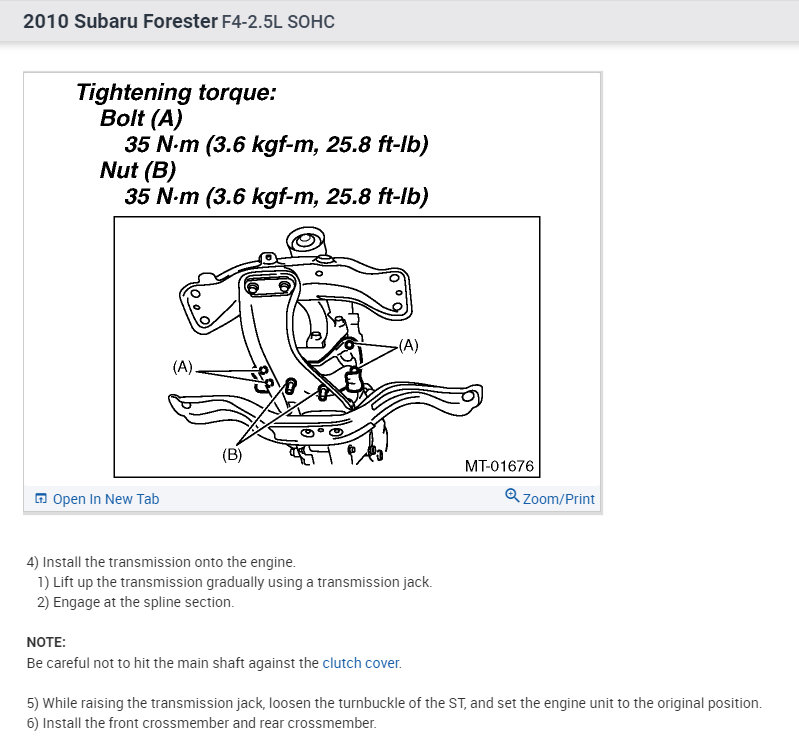

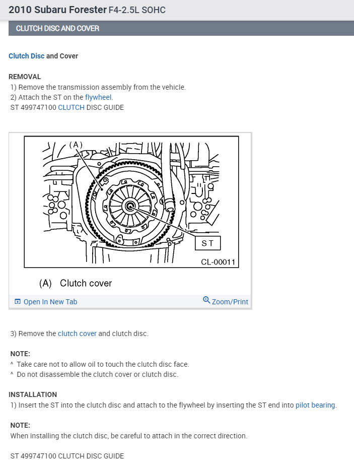

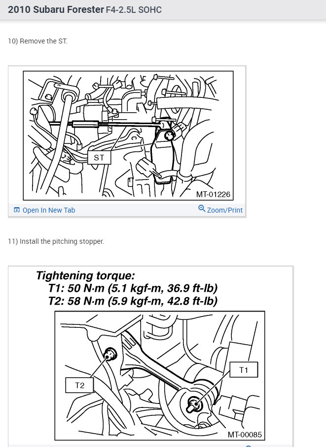

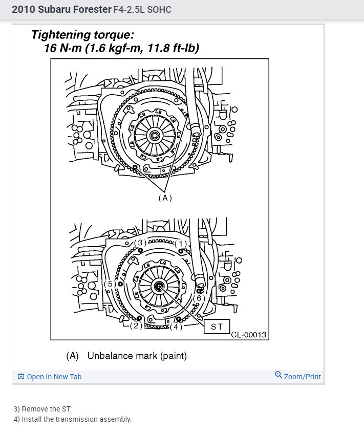

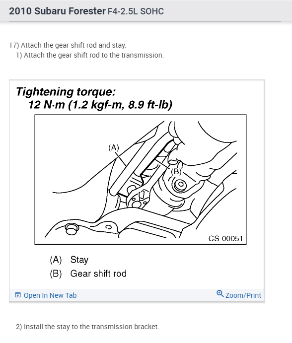

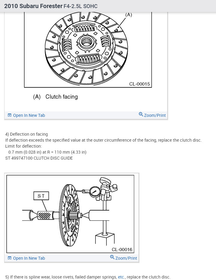

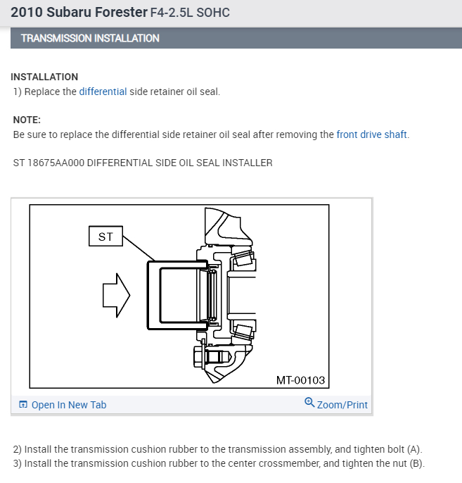

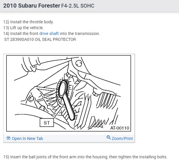

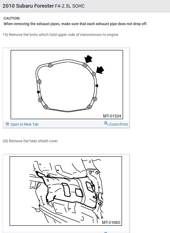

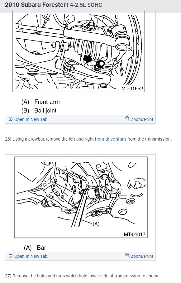

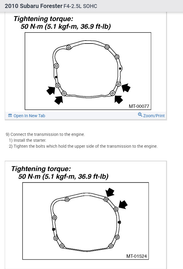

See below, I have attached the transmission removal and installation process as well as clutch and fork replacement procedures.
https://www.2carpros.com/articles/transmission-replacement-removal-manual
https://www.2carpros.com/articles/how-to-replace-a-clutch
Let me know of any questions.

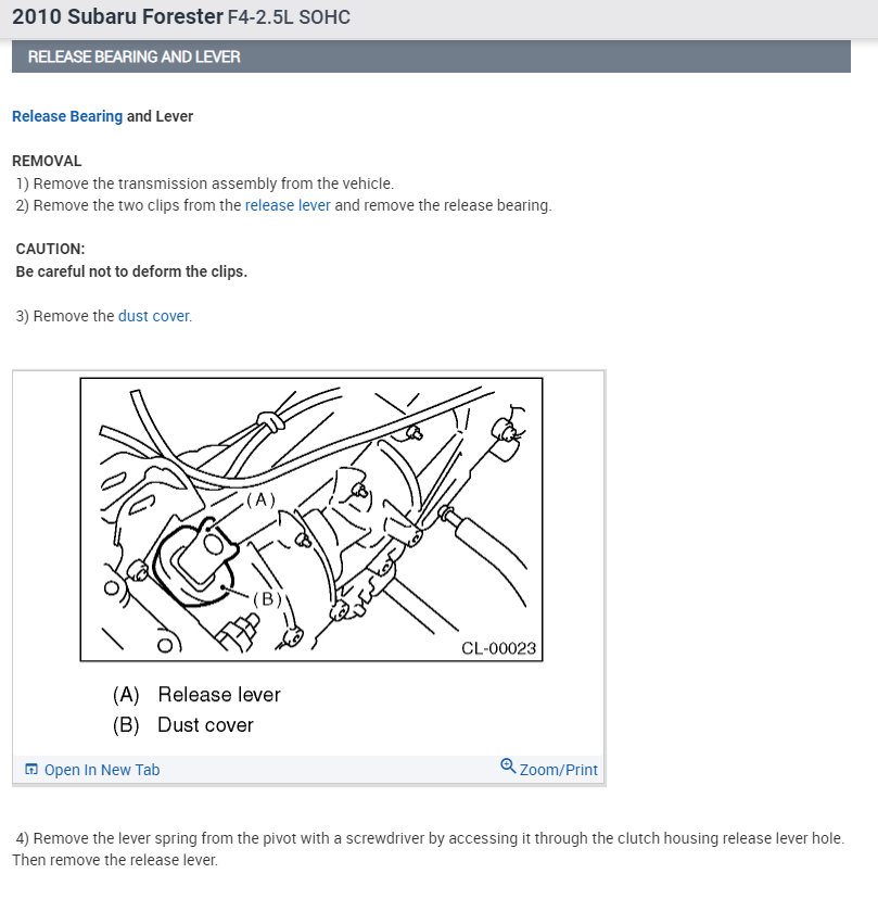

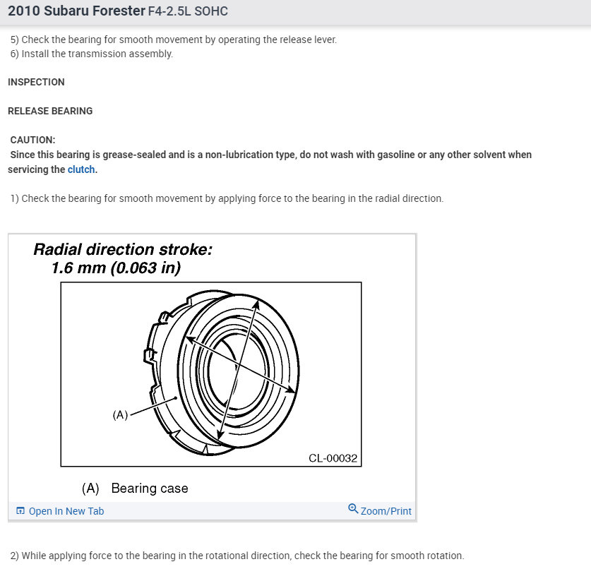

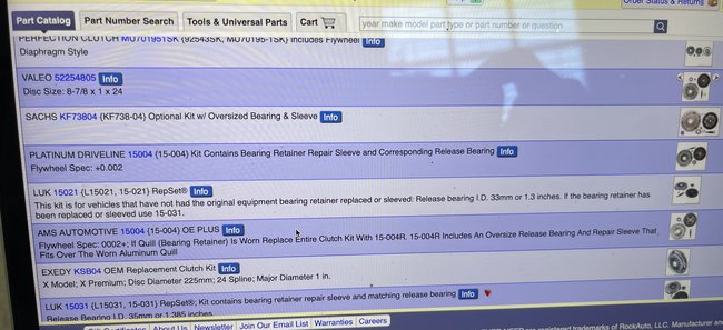

Do you know what they mean by this: about the retainer if worn replace with this clutch set which includes an oversized one or the chat about kit contains bearing retainer repair sleeve. All i know is the fork, pilot bearing, throw out bearing, clutch plates when it comes to a clutch.
Jun 9, 2022 at 11:15 PM
SQM
  • 6,383 POSTS
Not sure what they mean by the retainer. It could be the clutch fork retainer clip. Usually that comes with new component.

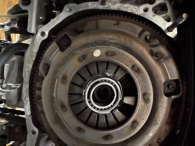

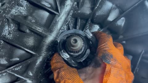

Just got it out, jeez, never seen a broken bearing stuck in the pressure plate like this before. Is there a rear seal behind the flywheel that i can change?
Jun 12, 2022 at 9:01 AM
BHAMDOC1973
  • 2,007 POSTS

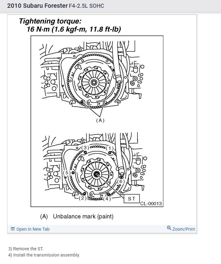

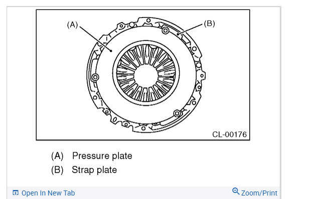

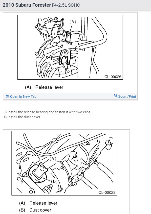

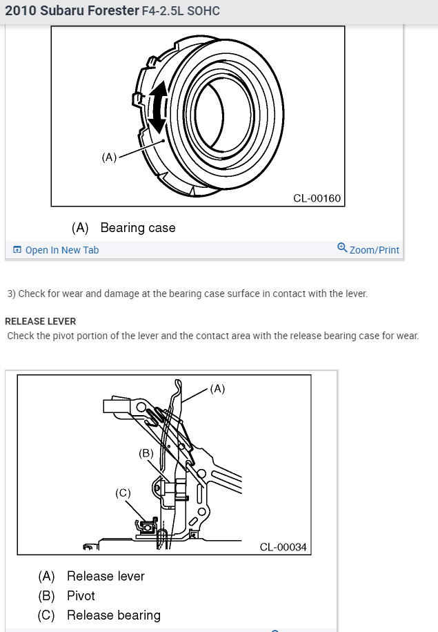

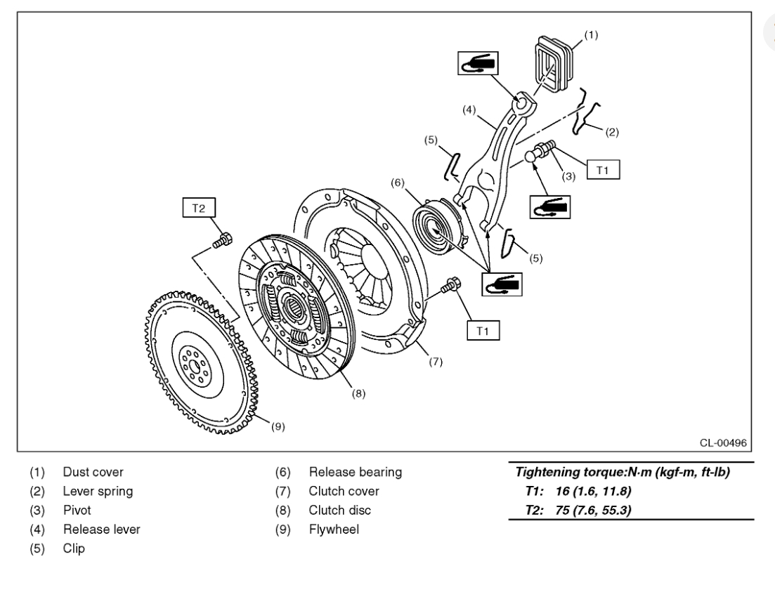

Can you find out if this car has a clutch release bearing clip (which i don't know what it does) or just a clutch spring?
Jun 12, 2022 at 9:15 AM
SQM
  • 6,383 POSTS

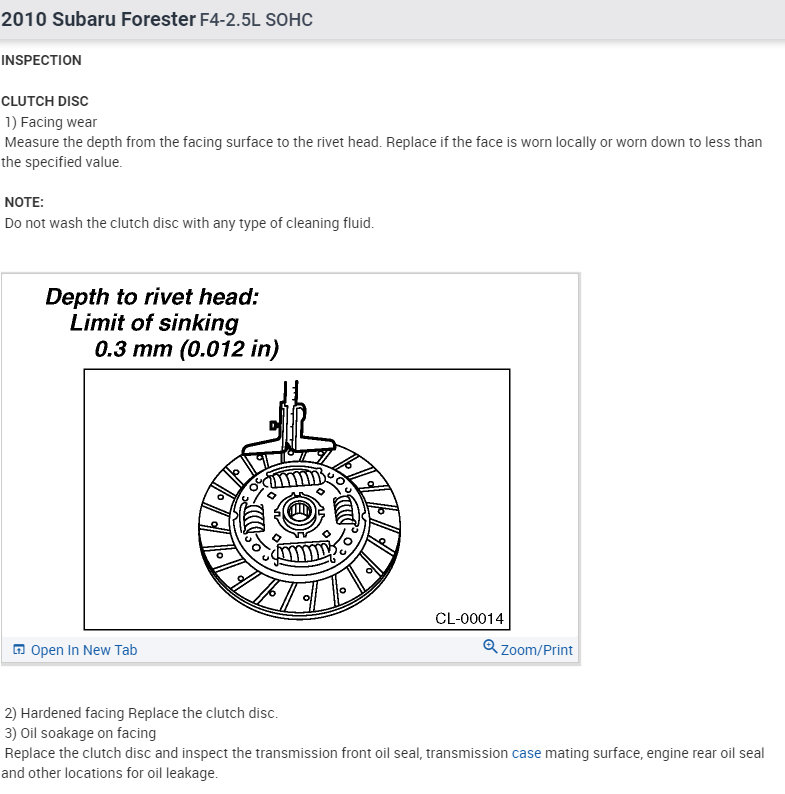

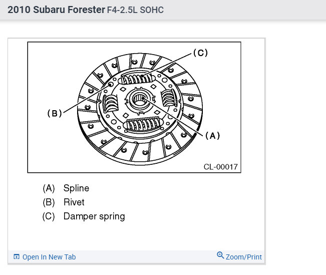

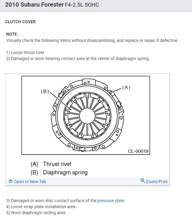

See attached. It shows the exploded view of the clutch.
Jun 12, 2022 at 3:46 PM

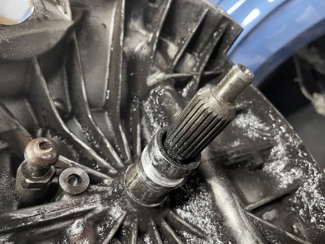

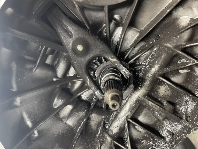

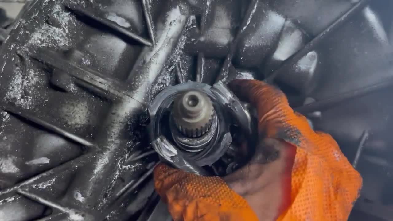

Do you think this will affect anything? There was rubbing on the shaft not sure if it is supposed to have that groove, but most of the shavings came from the bearing itself.
Jun 14, 2022 at 1:41 AM
SQM
  • 6,383 POSTS
This could be an issue, might create unnecessary movement or wiggle room. Which can create other problems.
Jun 14, 2022 at 8:33 AM

Got another transmission for it. Here is what the bearing did:
Jun 22, 2022 at 6:55 AM
SQM
  • 6,383 POSTS
Wow, the pressure plate is done as well.

Well, it's nothing but trouble, put the transmission and clutch in, all good for a bit drive it around the dead-end road by my home all good, next day went to do the same thing and then i lost everything, you can put the gear in all gears but i get nothing like it's in neutral, release foot of clutch and nothing happens or changes. I looked at the fork and it was in place. Pressing the clutch moves the slave cylinder pin and pushes on fork.
Jul 16, 2022 at 10:17 AM
SQM
  • 6,383 POSTS
So, if it just lost selection of any gears, I wonder if there is something that broke internally.
Did it make any noise before failing?
Jul 17, 2022 at 1:27 PM
