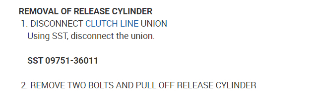

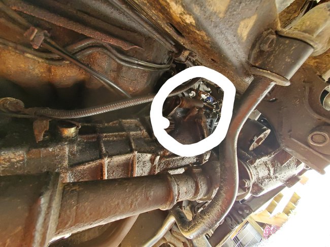

On removing the clutch release cylinder, I took the bolts out and tried to remove the clutch release cylinder. I could not get it to come loose from the lever sticking out of the transmission.
Do I need to take the two hydraulic lines off?
Do I need to drain the transition oil and transfer case or any other oils or fluids from transmission?

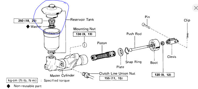

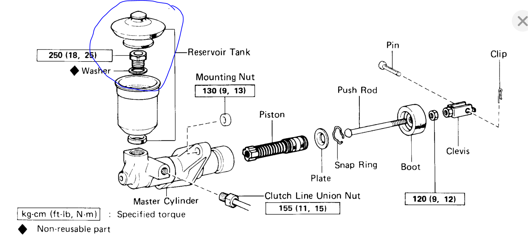

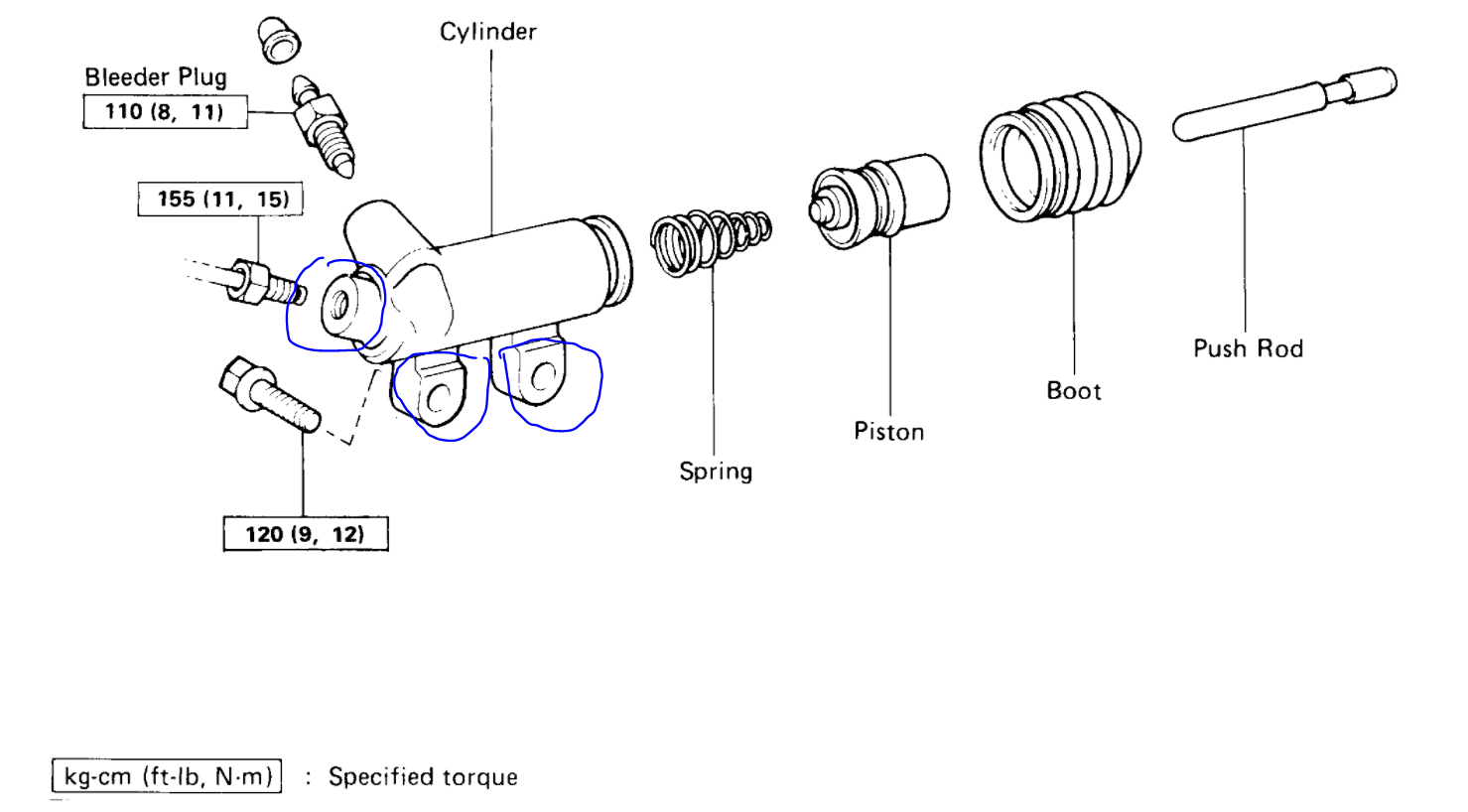

It sounds like it is stuck to the bell housing.
I attached a picture for you to view. You need to release the line from the clutch master cylinder and the 2 attaching bolts. Then it should come free of the bell housing and the rod will come free from the clutch fork.
https://www.2carpros.com/articles/throw-out-bearing-replacement
No, none of the oils have to be drained at all. The clutch fluid is brake fluid and is filled at the firewall.

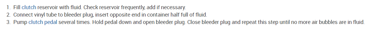

I also attached the bleeding process for bleeding the air from the system.
