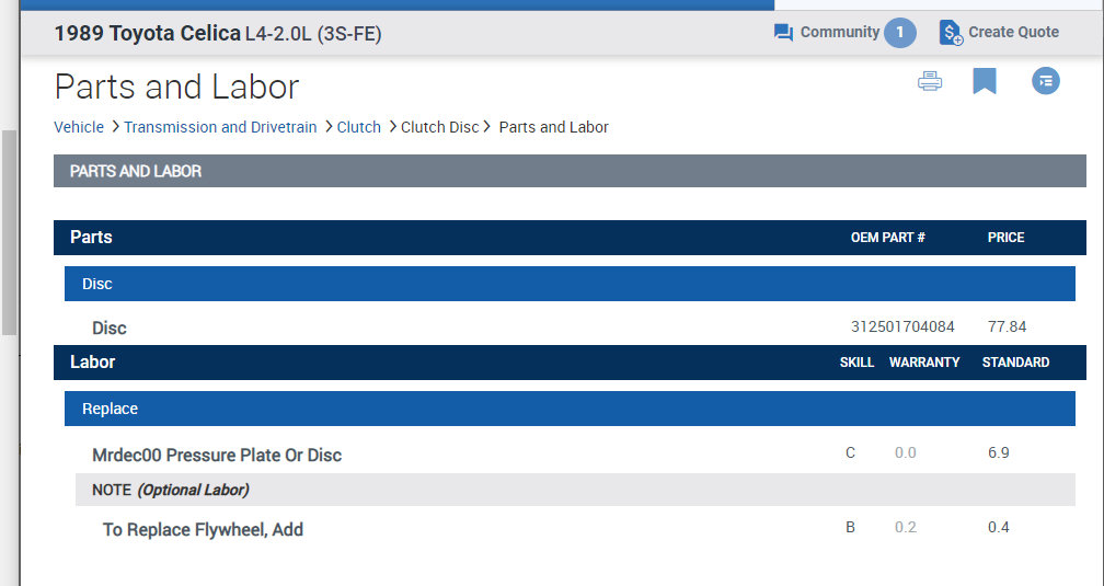

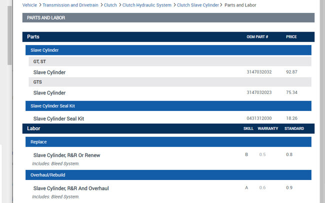

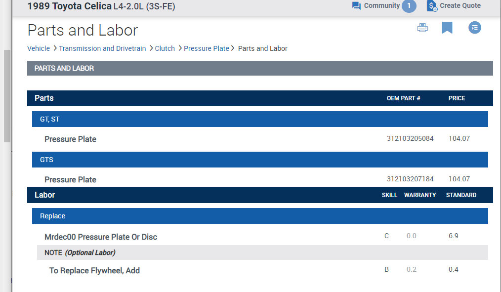

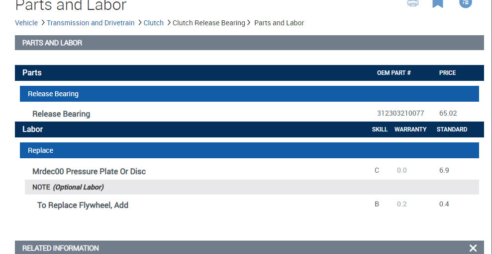

With car running in neutral can't put into gear. With car shut off I can put in gear, with clutch pedal depressed and I try to start it it wants to go clutch pedal isn't disengaging pressure plate.
Aug 4, 2021 at 5:45 AM

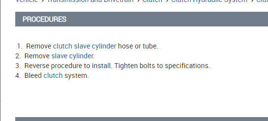

In short I think you nailed it with it needing a clutch as these are all clear signs that the clutch is not fully disengaging which means you slave cylinder/throw out bearing are not releasing the clutch.

We are going to have to rely on these guides and this video as the manual does not provide much detail at all on how to do this:

Please see below for this info and the part numbers for most of all you will need to replace.
