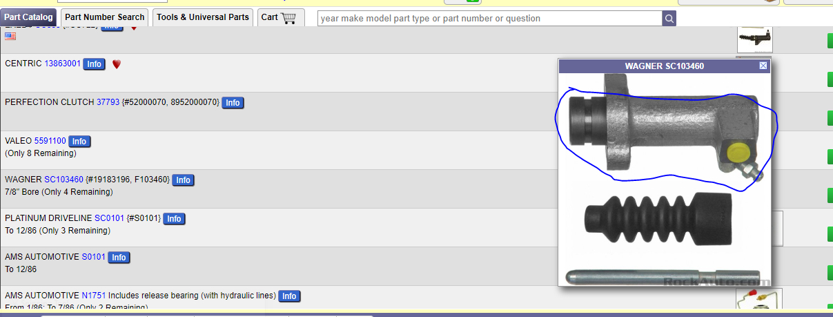

I would replace both the master and the slave together and add new fluid for bleeding.

Maybe a bad master or slave even though they are new?

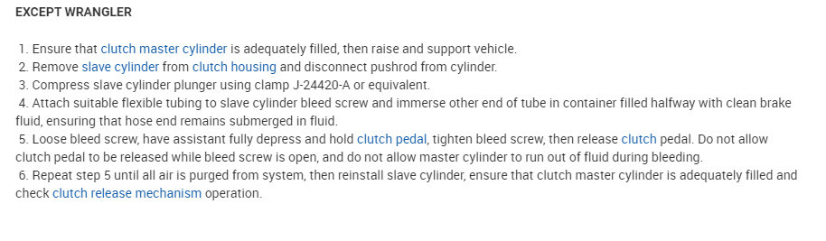

Try the bleeding procedure I posted for you. That is a little different.

On step 3. I don't know where to find clamp J-24420-A. I went to a few stores and can't find the right size tubing that fits. I'll keep looking.
Oct 27, 2019 at 3:23 PM
You could depress it with your fingers and then keep it depressed with wire ties for the test.

Roy, it was raining and cold last weekend so didn't get out to work on vehicle. This weekend it was nicer. I disconnected the slave cylinder from the transmission by unscrewing the two bolts. I pushed in the push rod all the way and held it in place. Placed clear tube on bleeder screw on one end and placed the other end of tube in clear water bottle filled half way with brake fluid. Had my son press the clutch pedal down and hold. I opened the bleeder screw then closed the bleeder screw while my son had the clutch pushed to the floor. My son said it was very hard to push down. I screwed the slave back to the transmission. Made sure the master reservoir was full.(had my daughter keeping it full). After we were done and I sat in driver seat it, the clutch was back to where it was before with little resistance. Do they make a clutch master and slave cylinder assembly where there is no bleeding involved because this is not working for me.
