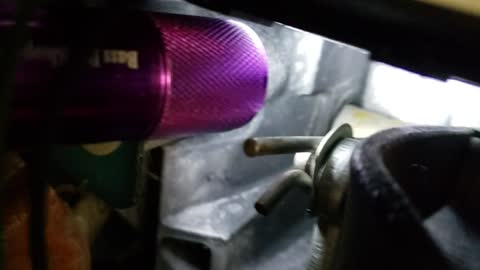

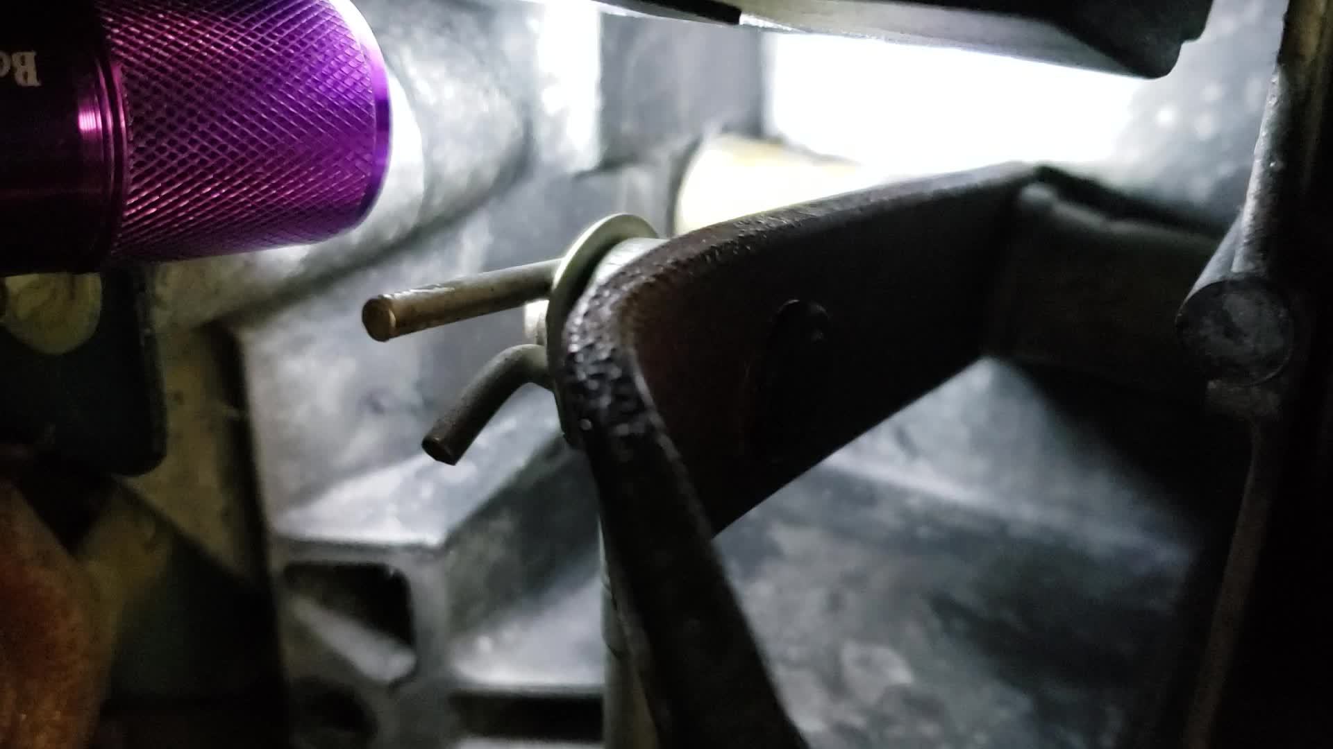

Bypassed switch to start engine. Now the bracket that holds clutch and brake pedals under dash that goes into the body is missing the bushing. The clutch pedals moves left and right. I have been to several parts stores, but they don't know what bushings goes there. What is this bushing called and how do you replace it?

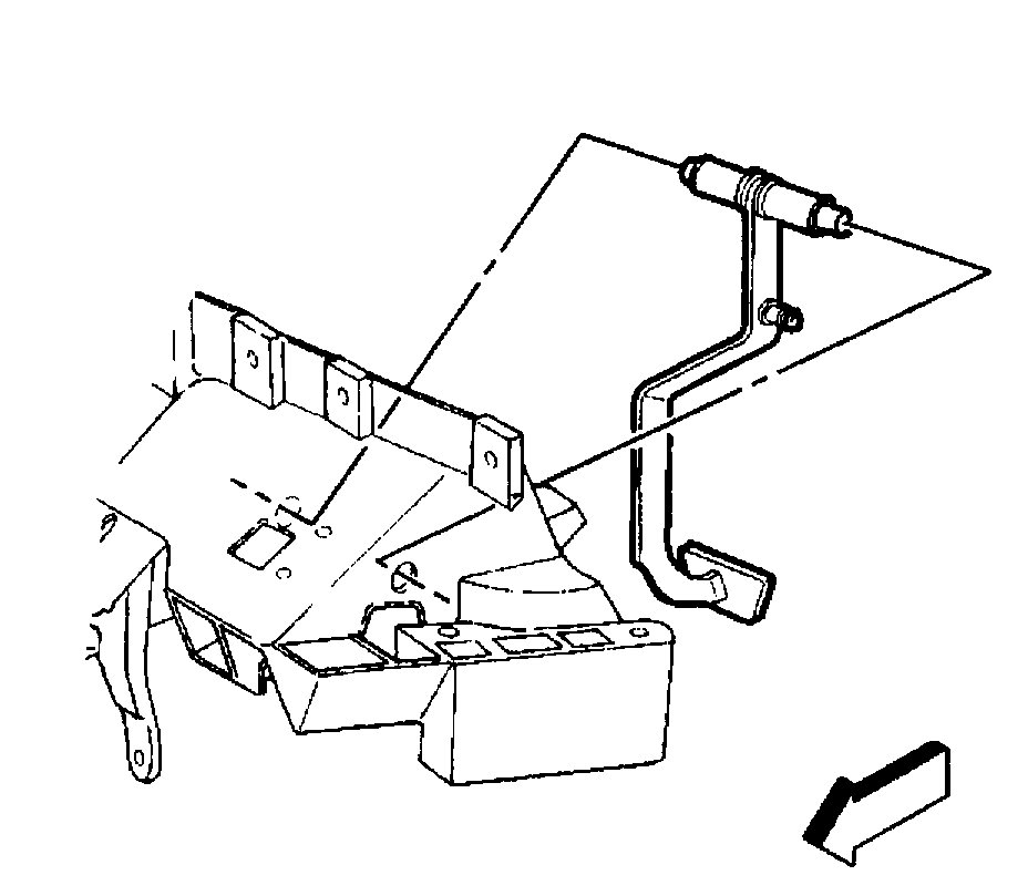

Here are the directions for removal and replacement of the clutch pedal. However, I'm not sure what bushing you are referring to. Take a look through these directions and the attached pics and let me know if you see the bushings you are referring to or where they are located. The only thing I can think of are support tabs that are on the mount that may be broken or bent.
1999 Chevy Truck S10/T10 P/U 2WD L4-2.2L VIN 4
Clutch Pedal Replacement
Vehicle Transmission and Drivetrain Clutch Clutch Pedal Assembly Service and Repair Procedures Clutch Pedal Replacement
CLUTCH PEDAL REPLACEMENT
Removal Procedure
pic 1
1. Remove the master cylinder rod from the clutch pedal.
pic 2

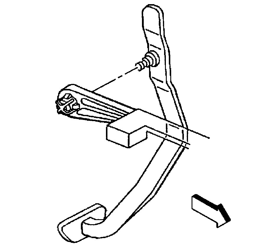

2. Remove the clutch pedal from the support by depressing the side tabs.
Installation Procedure
pic 3
1. Position the clutch pedal into the support.
pic 4
2. Secure the master cylinder rod to the clutch pedal.

I will take some pictures of what I am talking about. Hopefully this will give you an idea what I am talking about. I will send this soon. Thank you.
Jan 11, 2020 at 12:31 AM
  • 110,244 POSTS
Sounds like a plan. I will watch for your reply.
Jan 11, 2020 at 11:32 AM
RHW
I am sending video of my problem. You have received help from me on this. I am not able to send video to you email address. So I will try this.
