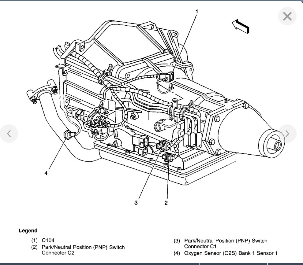

I want to know how to access and replace the park neutral switch on my 2002 S-10 pickup.
Aug 28, 2010 at 2:56 AM
The switch is located on the left side of the transmission. I am attaching the info from the manual below.

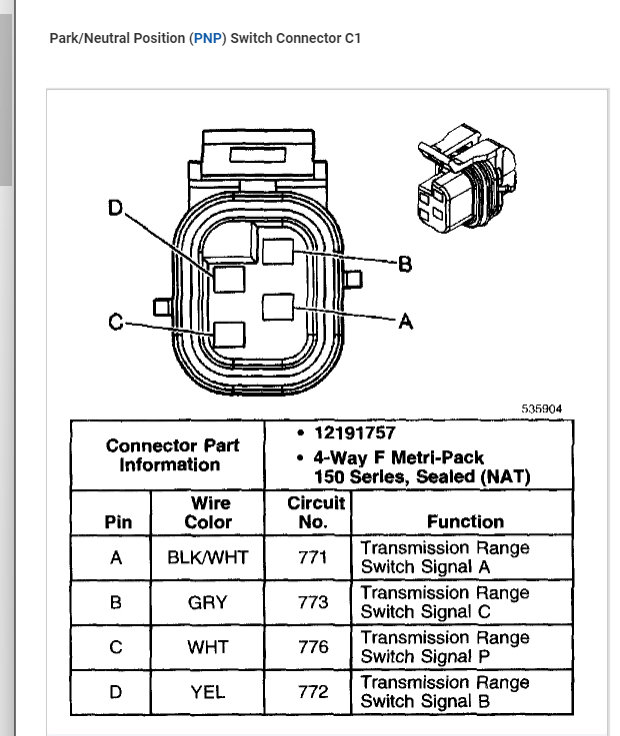

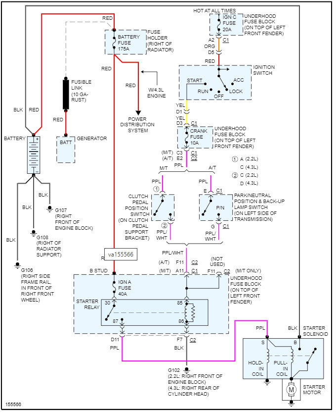

Here is a guide that will help with testing this in case you need this:
Please see the info attached below and let me know if you have questions on this.
