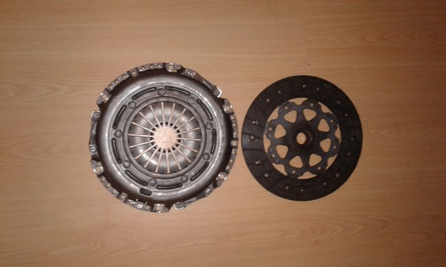

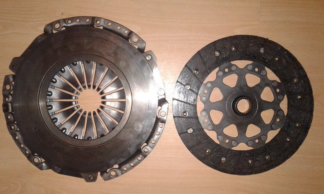

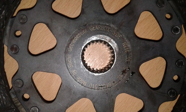

This is what the pressure plate looks like. it was not easy to take it off because its bend. the day I changed the flywheel and the clutch the guy who helped me used to rest the gearbox on the plate.

Yep, a bent flex plate will cause the clutch not to work. After you install the new flywheel and you are installing the transmission do not let the transmission "hang" once it is plugged into the clutch but not not quite bolted up yet.

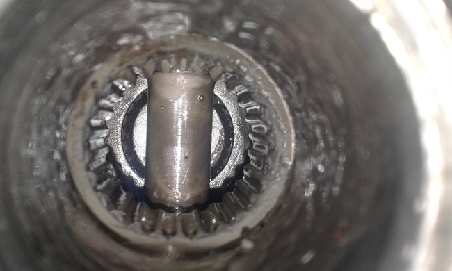

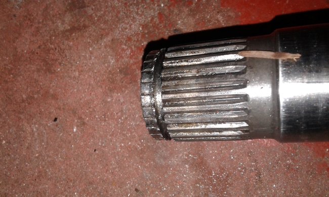

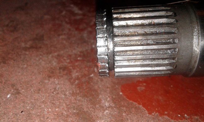

So after putting everything back together I noticed the driveshaft threads are worn out can this be actually the problem with my car.'

I took off the clip missing on the drive shaft end
Feb 26, 2018 at 12:15 PM
  • 55,746 POSTS
Yep that is your problem it looks like it may have slipped out during operation causing the problem.
