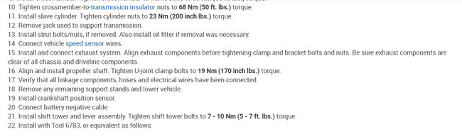

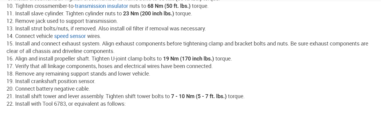

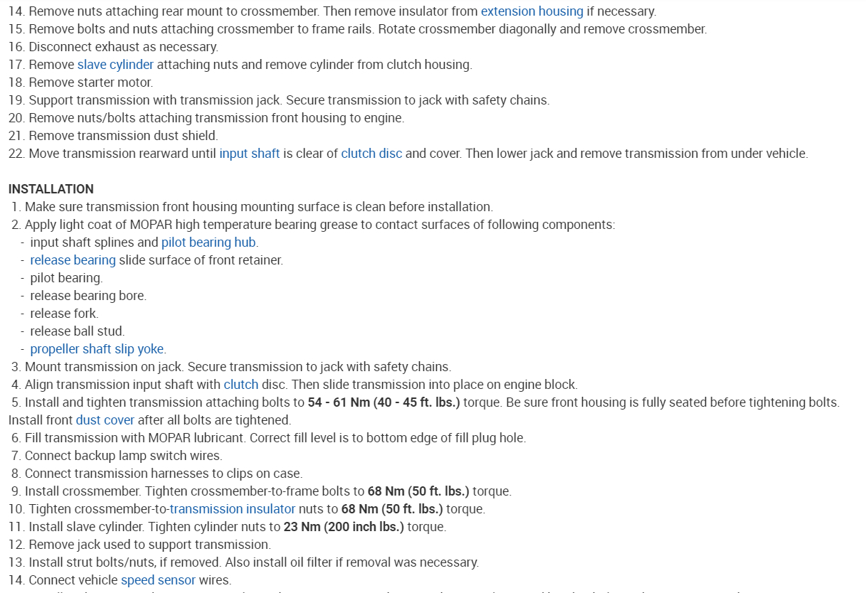

I was towing a car, and my motor shut off. My truck would not start i waited for a few and it started up but i could let the clutch out and it would hardly move i could smell something like burning smell. I just had a new clutch put in last year and haven't had any trouble with it until now.

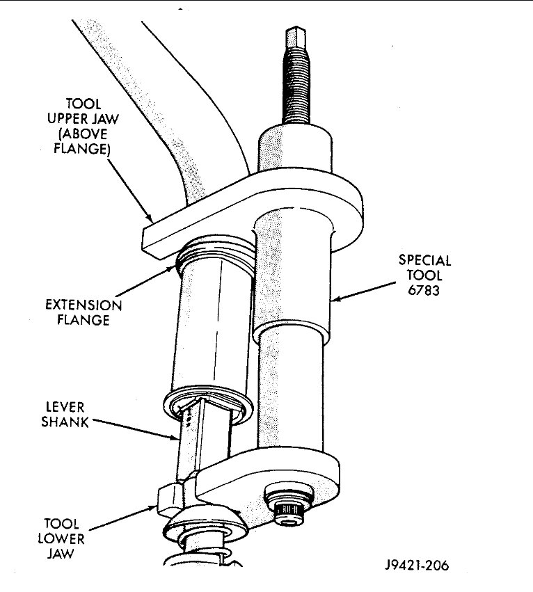

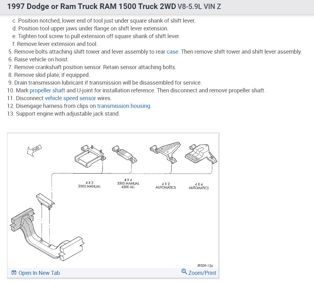

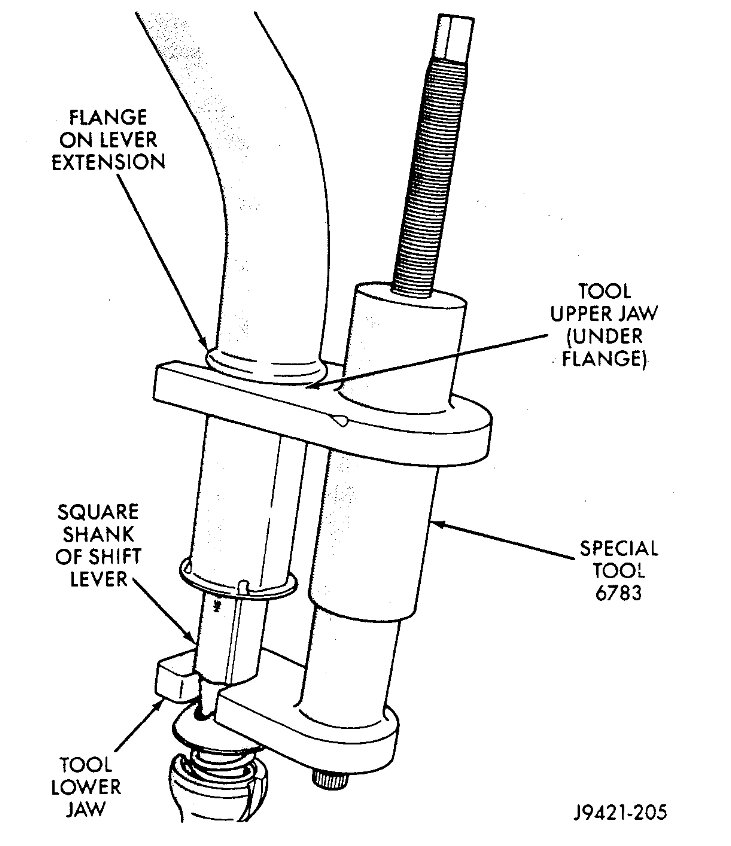

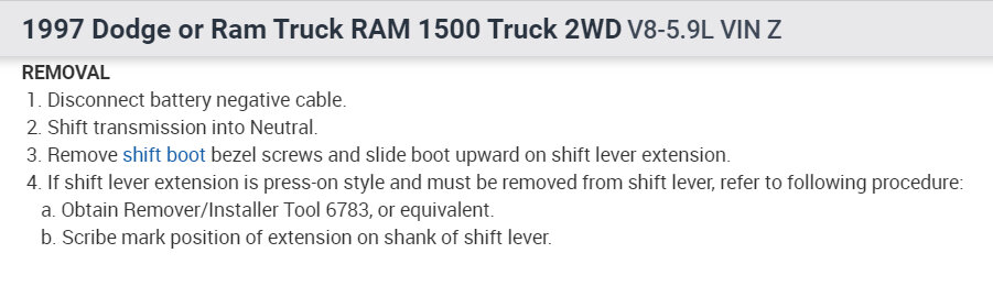

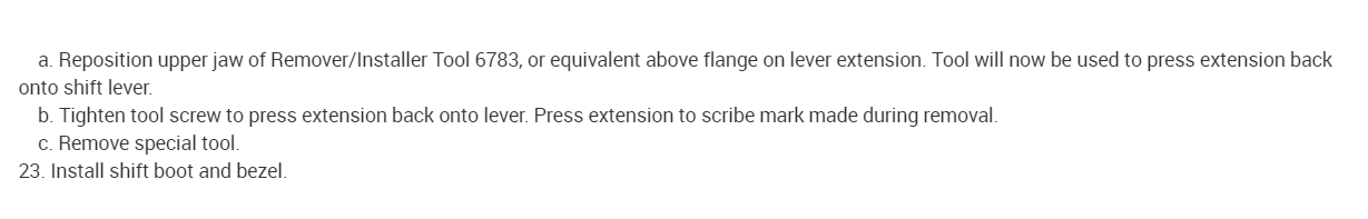

It sounds like you overheated the clutch, and the lining has come off of the clutch disc, which happens, but to be sure please go over this video and guide to confirm the failure:
https://youtu.be/EpBMj5ZY_bo
and
https://www.2carpros.com/articles/clutch-doesnt-work-sometimes-or-not-at-all
This video will give you an idea of what needs to be done and I have included instructions for your truck in the images below:
https://youtu.be/JpzefqEeVGE
