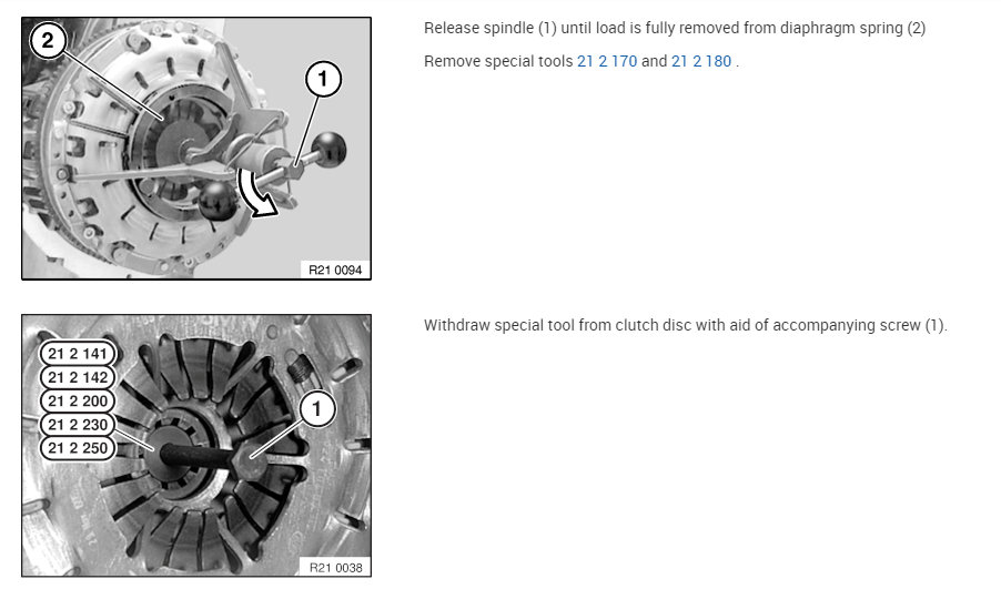

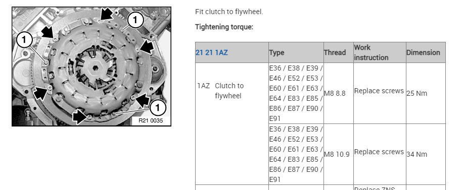

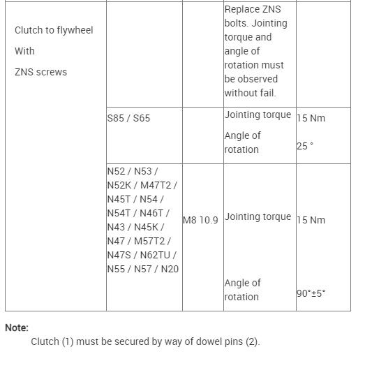

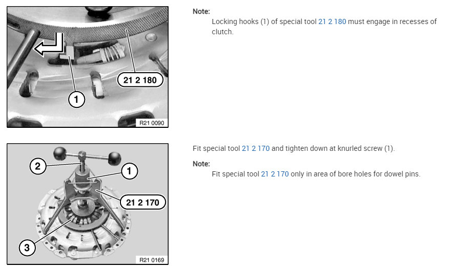

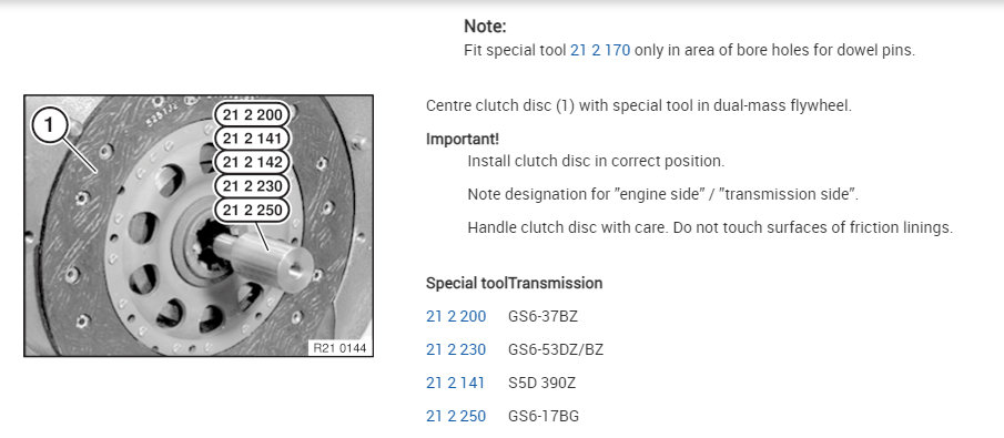

I'm reinstalling the clutch pressure plate and flywheel. I can't get the tratto slide into place. It's getting stopped about an inch from where it is supposed to. I am now taking transmission back down and going to remove clutch etc. To start over again.
Jul 17, 2022 at 7:33 AM
  • 110,194 POSTS

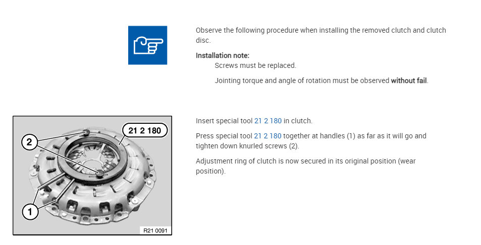

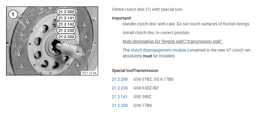

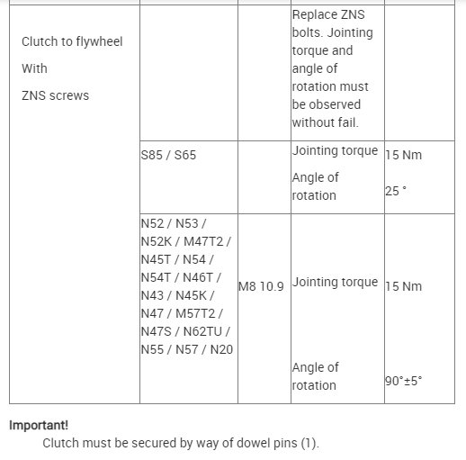

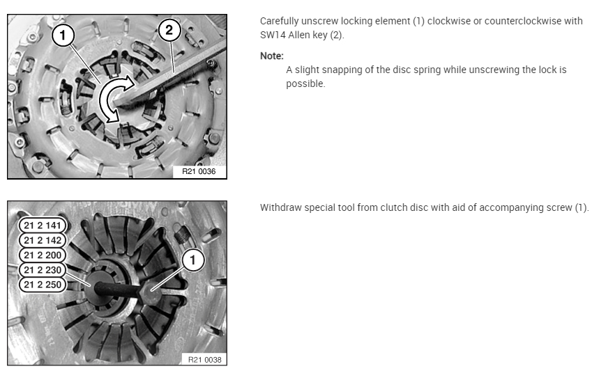

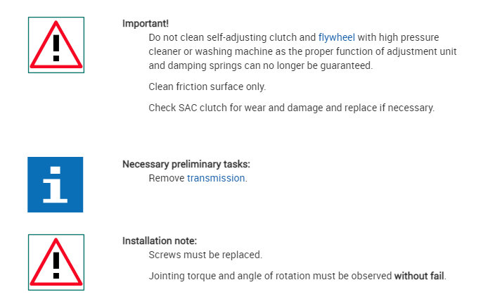

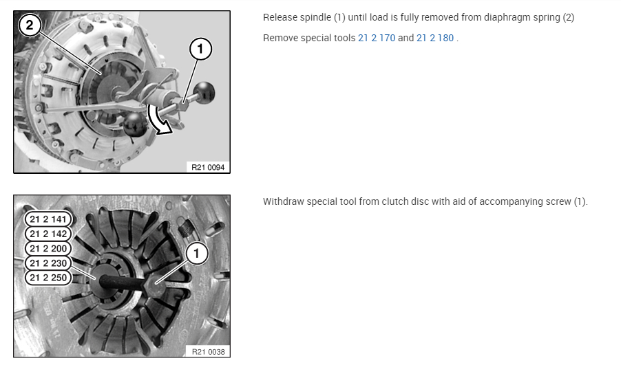

I believe there are dowel pins that the disc needs to be aligned with for the pressure plate to seat.

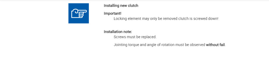

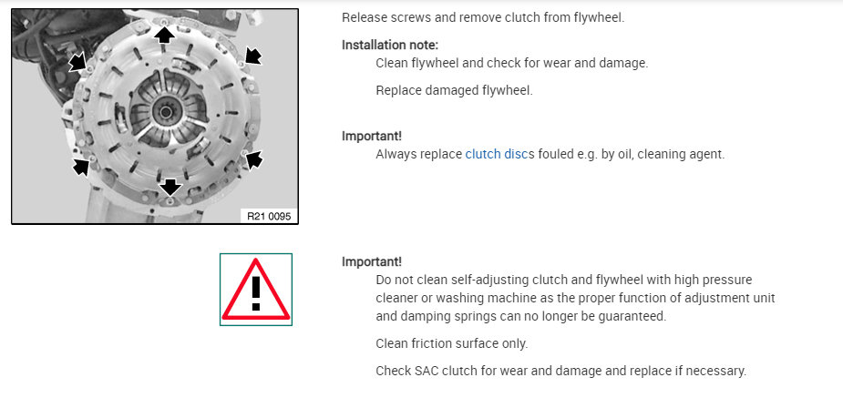

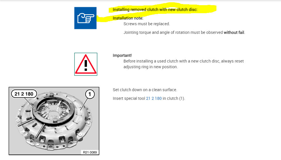

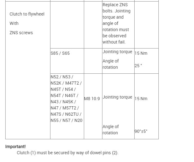

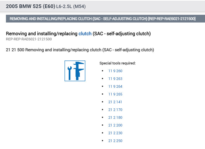

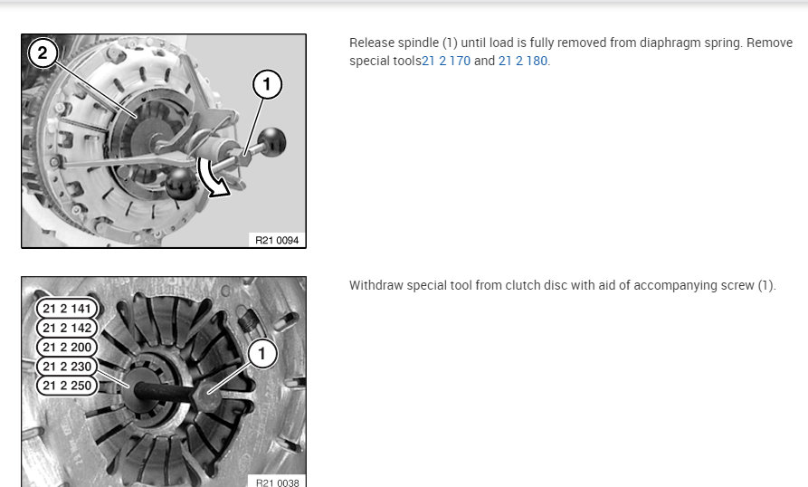

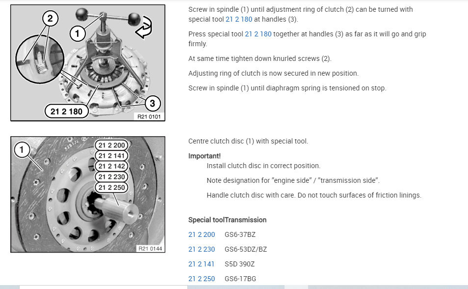

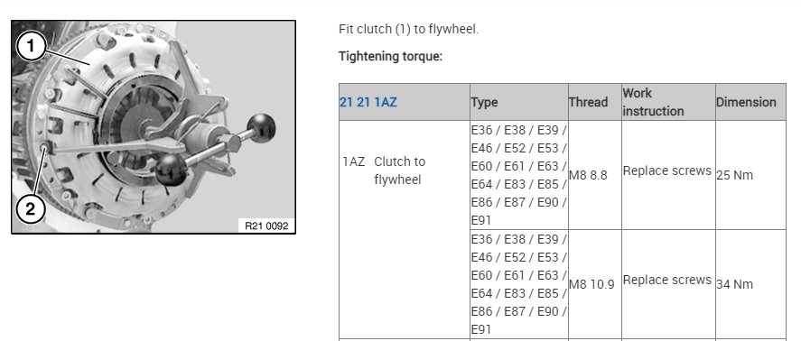

Do me a favor. I attached everything I have on clutch replacement below. Take a look through it and let me know if anything helps.
