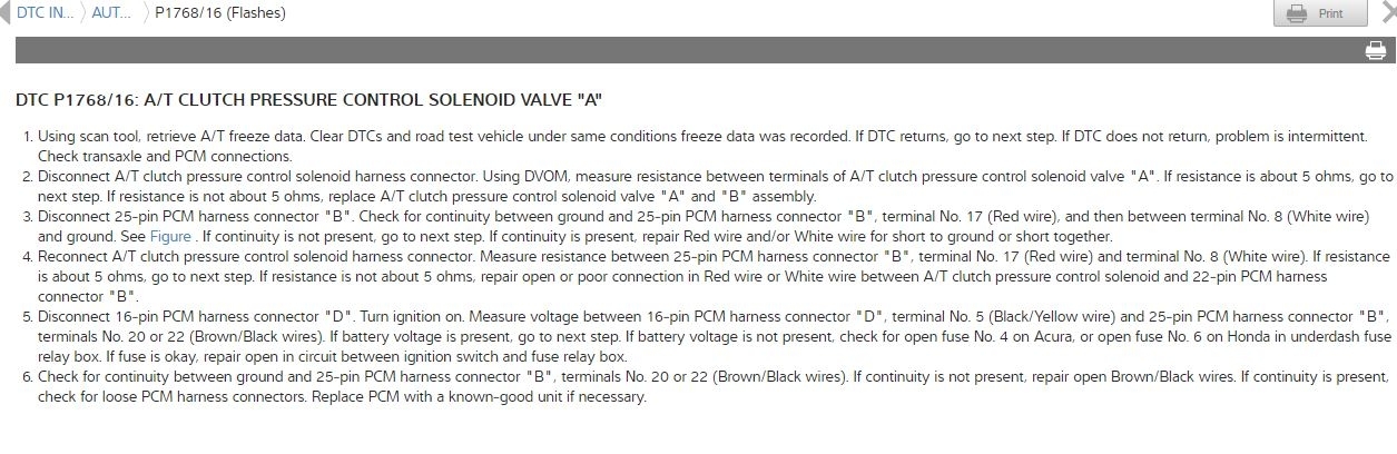

I have an engine code P1768 which I have purchased new clutch solenoids A and B as well have tested which both are working fine. I have tried a reset which did not clear the code. There is a very large clunk when shifting from park to reverse or drive and when in drive the rpm's are high but the vehicle moves very slow before eventually gaining speed.

This is an interesting one. What I have done is attach a picture with the test procedure from mitchel, Prodemand. Take a look through it and let me know if it helps. Sorry I had to put it in a picture. I had no choice.
