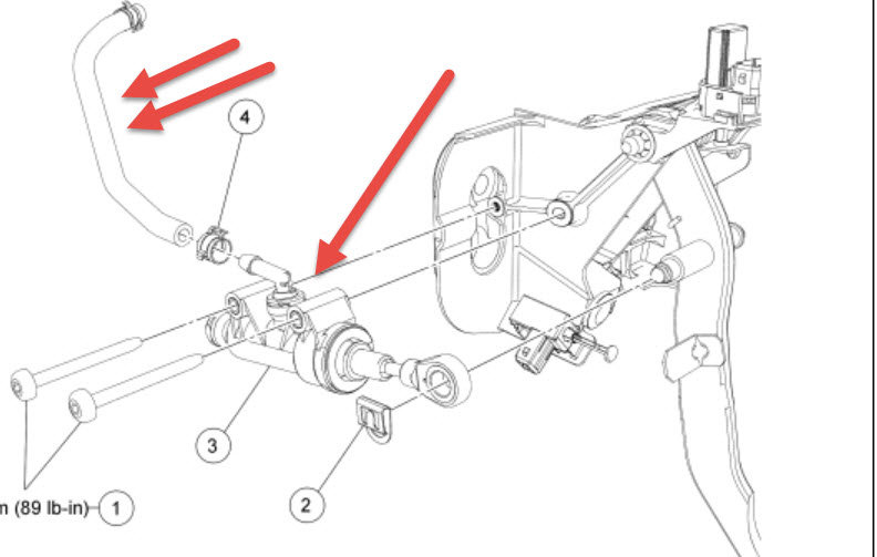

It seems like the clutch pedal travels further now before it starts to catch and move my car. Is there an adjustment to adjust less travel? I have never hot rodded it, so it is hard to believe it is the clutch.

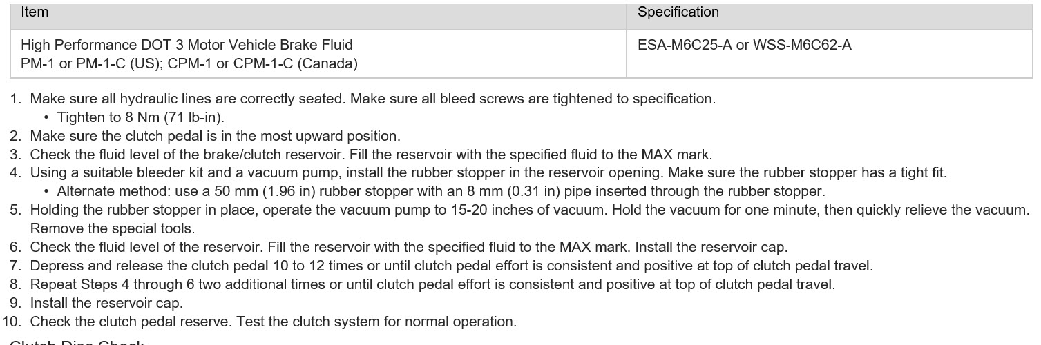

Check fluid in master cylinder for clutch it may be low or air in system if master is full bleed air from system. See picture.
Also here is a link to an article that shows you how to bleed the system:
www.2carpros.com/articles/how-to-bleed-or-flush-a-car-brake-system

Could you please send me another picture. It is not visible as it is.

Here is same picture, but not sure if you can make it larger or not...

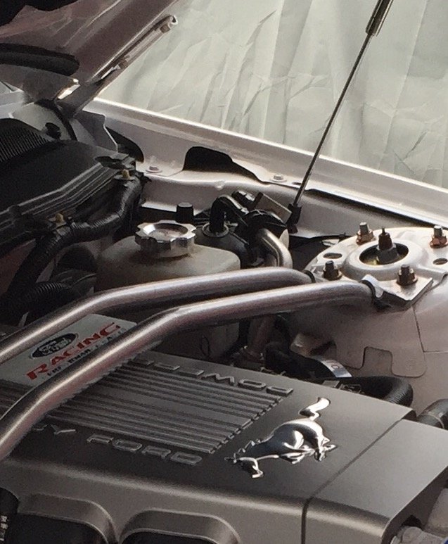

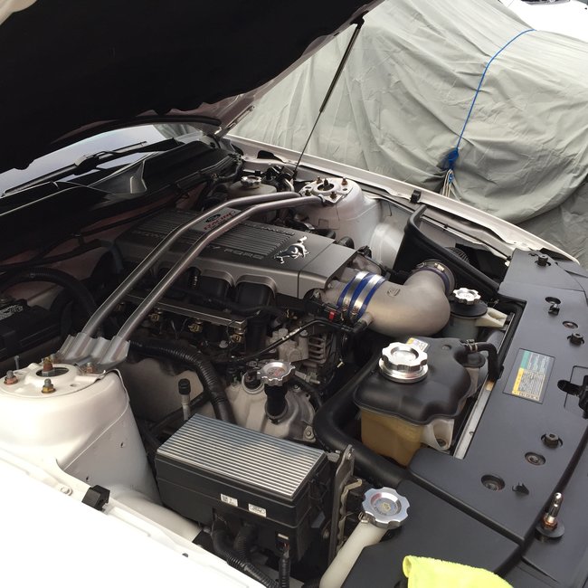

Are the brake reservoir and clutch reservoir two separate tanks?

yes I think yours is above the brake booster on drivers side. it will not be as large as the brake reservoir.

So is it in the engine bay or in the cabin?

My engine bay.

A better view. The brake/master clutch reservoir.

The picture is of your master cylinder which is attached to your clutch pedal, follow the double hose outside the firewall to your reservoir it should be on drivers side and in plain sight.

I really apologize but is it located in the engine bay or inside the cabin near the clutch pedal.

Engine bay look by master cylinder reservoir.
