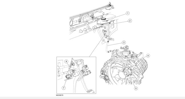

About a week ago I was driving normally and the clutch pedal went to the floor for around five seconds and then returned to normal. I have had no problems since. Is this something to be concerned about?

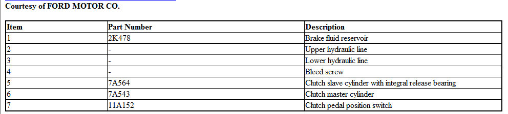

it seems clutch master cylinder and slave cylinder are going bad.
Run our guide.:
https://www.2carpros.com/articles/clutch-doesnt-work-sometimes-or-not-at-all
check picture 1 and 2 for clutch system components location.for the slave cylinder replacement manual gearbox must be removed because the part is integrated inside it.
let us know if more help is needed.
