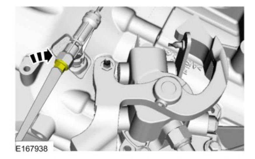

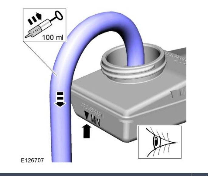

I was wondering if someone could help me/give me some advice with an issue I am having with my car listed above eco boost 6 gear car? The clutch pedal recently went to the floor and wouldn’t come back up. I took it to a garage that have changed the master cylinder, the flywheel, put a new clutch in, checked everything to do with the clutch like the spring, blown the pipe and that holds its pressure. They have replaced 4 slave cylinders but everytime they try to add the hydraulic fluid again the Slave cylinder blows. They are at a loss to what it could be. Please if anyone could help I am desperate I need a car for my sons hospital appointments.

Good evening,
You have air trapped in the lines and it must be bled correctly.
I attached the procedure below for you.
Clutch System Bleeding - 6-Speed Manual Transmission - MMT6
Special Tool(s)/ General Equipment
Materials
Bleeding

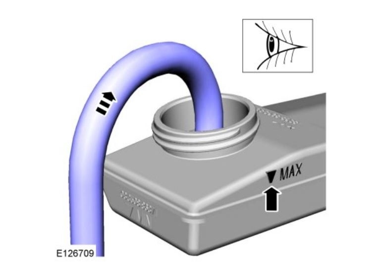

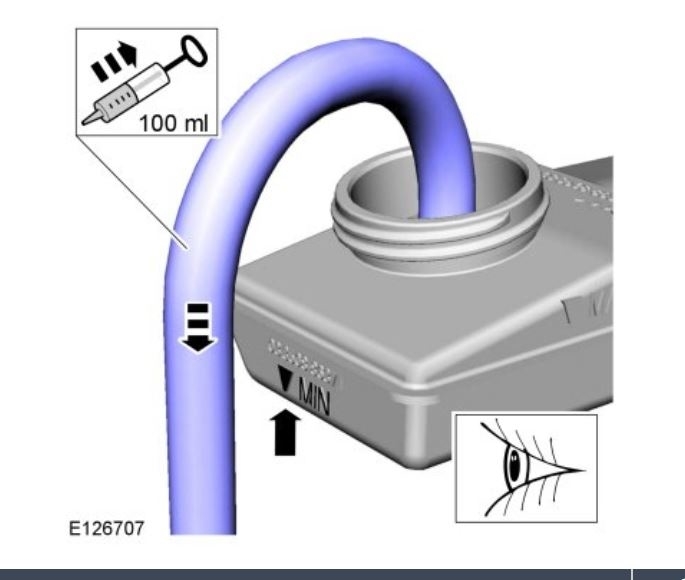

1. NOTE: Make sure that the brake fluid level does not drop below the MIN mark.
Using a suction gun, drain the brake fluid reservoir to the MIN mark.
Use the General Equipment: Fluid Suction Gun

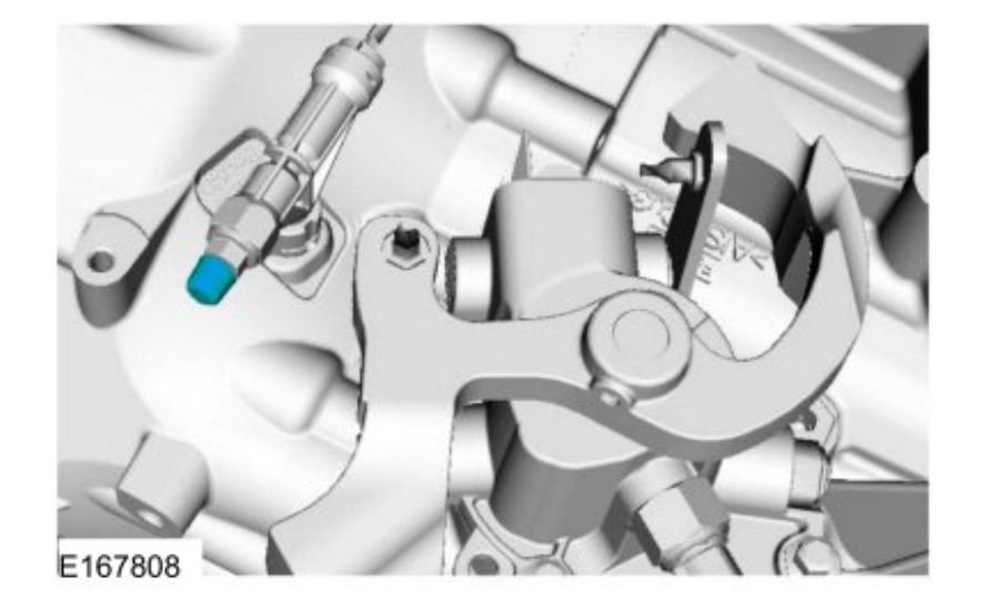

2. Remove the bleeder cap.

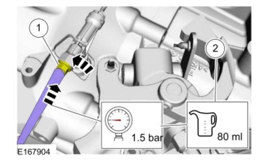

3. Install the following items:
Install a brake bleeder and fill the tool reservoir with brake fluid.
Use the General Equipment: Brake/Clutch System Pressure Bleeder/Filler
Material : Motorcraft(R) DOT 4 LV High Performance Motor Vehicle Brake Fluid / PM-20 (WSS-M6C65-A2)

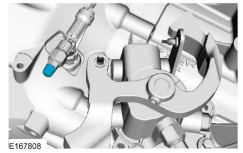

4.
1. Loosen the bleeder screw 3 turns.
2. Pump brake fluid into the hydraulic system using the brake bleeder.
5. Close the clutch bleeder.
6. If equipped.

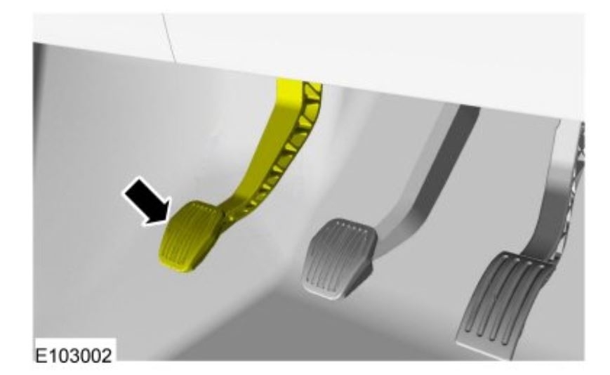

7. Pump the clutch pedal 5 times, using the full clutch pedal travel to remove any trapped air from the hydraulic system.
8. NOTICE: Make sure that fluid level is to the MAX mark.
Fill the reservoir.
9. Start the engine.

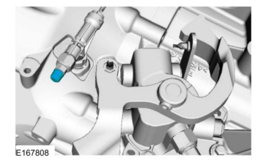

10. Start the engine and check the operation of the clutch. If reverse gear engagement is excessively noisy, operate the clutch pedal 5 times, using the full clutch pedal travel.
11. After waiting approx. 30 sec., check the operation of the clutch again. If reverse gear engagement is still excessively noisy, repeat the bleeding procedure.

If they did not follow that procedure, it will not work.
Please explain what you mean by the slave cylinder blows?
If they did then either the new slave or master is no good.
It can only be those 2 things causing this issue. My bet is on the air in the system.
