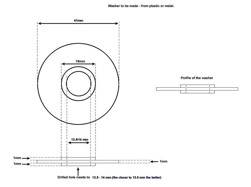

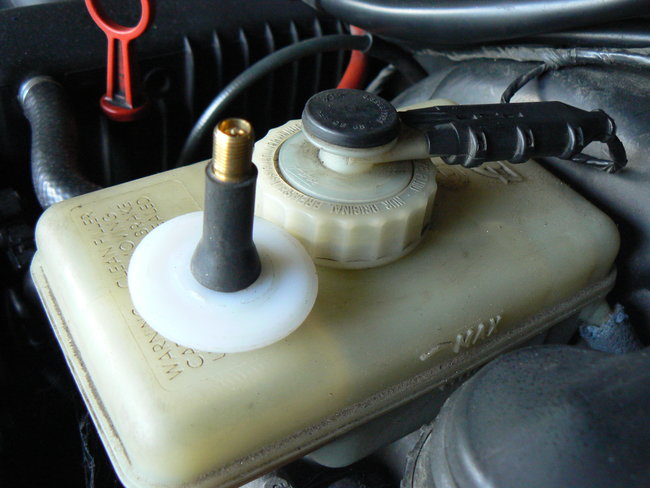

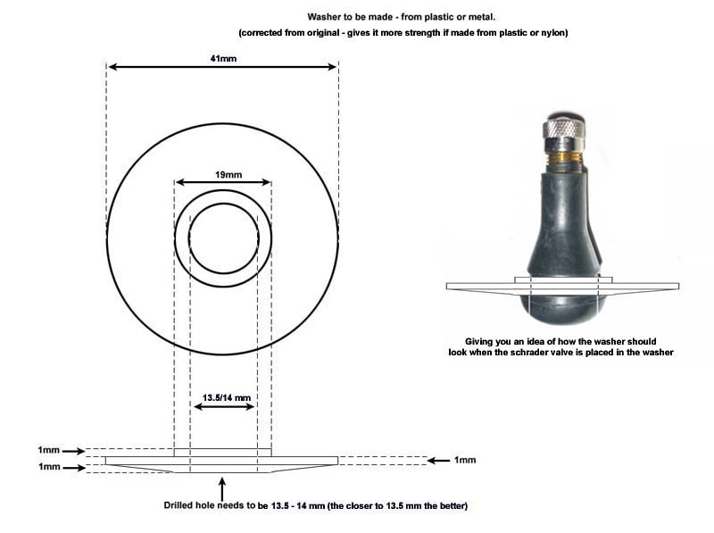

To get the master brake fluid cylinder put under pressure (without buying expensive equipment) I made up a washer (see image) with a schrader valve (obtained for free from a place where they put new car tires onto your car) in the middle thinking that I could use a bicycle pump and put it under pressure that way. The image shows what the washer looks like beside the cap to the master brake fluid reservoir. I also put epoxy around the underside of the valve so that there would be no leaks at the point where the schrader valve goes through the washer.
The cap is removed, the central part is unplugged and removed from the cap and the washer with the valve put in place of the central bit. The washer was a snug fit and used the rubber washer under the original piece in the cap as a means of sealing the unit.
I filled the reservoir with brake fluid to about 0.75 below the valve stem's underside and used a bicycle pump to put the system under pressure.
When bleeding the new slave clutch cylinder only about two inches of fluid came through the tube before the pressure ran out. But I was able to see that there were no bubbles and I did loosen the clutch rod as stated in the instructions. I also saw that the fluid level inside the reservoir was a lot lower - around the level it should be which was about an inch lower than when I started (the MAX line on the outside of the reservoir).
It could be that I have to bleed it for much more than what I did. If so I will have to rethink how to put the reservoir under pressure.

1. I attached my made up schrader valve washer and put the system under pressure with a bicycle pump that had a pressure gauge attached which I had purchased for about $15. The pressure was pumped to 29lbs psi. This schrader valve washer worked very well.

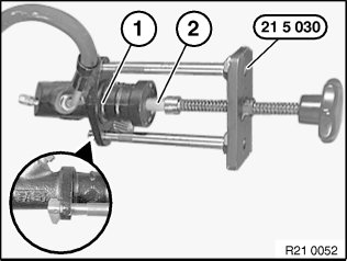

9. I removed the slave cylinder from the transmission housing and attached a home made press that is similar to the one in the image below (I made this up at the same friend's house where I made the schrader valve washer). I started to push the slave cylinder rod back into the slave cylinder housing using this press and when there was a bit of resistance I opened up the bleed valve (while the slave cylinder bleed valve was at the highest point as much as possible and the rod pointing down) and was rewarded with lots and lots of bubble being expelled. I continued pushing the rod in by screwing the center post further into the cylinder until it could go no further. I waited until clear fluid without any bubbles came out of the bleed valve. At this point I closed the bleed valve.
10. I slowly unscrewed the center post of the home-made press tool to allow the rod to extend back out from the slave cylinder until I was able to take off the press tool.

This job can be done by one person if using the schrader valve washer system I created. One also needs to buy a hand pump with a pressure gauge. These items are quite cheap and can be purchased for less than $20. The schrader valve can be obtained for free from any tire shop. Making up the washer could be difficult depending on whether one has access to a lathe or not.

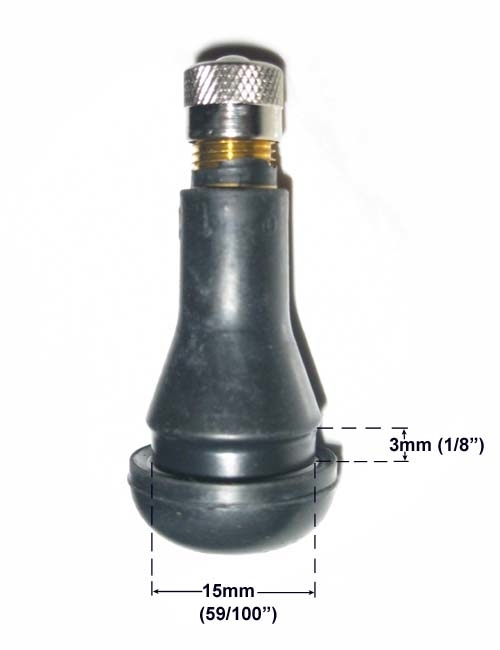

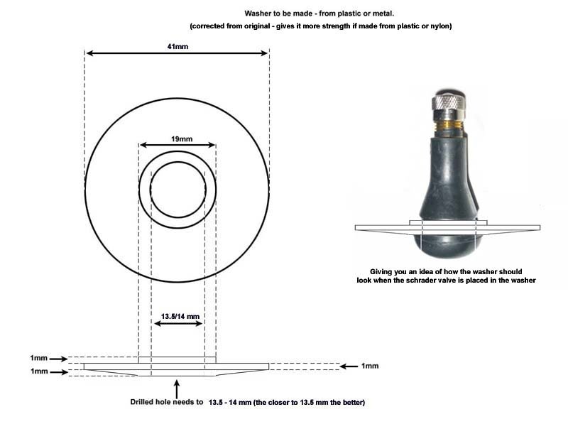

The dimensions of the washer are as follows:
Center hole - 13.5 - 14 mm in diameter (schrader valve stem is 15mm at the point where it slots in)
Height of 'collar' around hole above is 3mm.
Collar width - 19mm
Washer diameter - BMW E36 Specific - 41mm
Washer thickness for middle - 1mm
See image below for schematic.
Use epoxy resin on the under side of the washer around the valve seat to make an air tight seal. When using the washer tighten the cap as much as possible.

By the way, I have corrected the schematic of the schrader valve washer as that is the shape I actually ended up with due to the washer being distorted by the cutting tool on the lathe (even though I started out trying to cut the washer to the original shape). It turned out that this configuration was needed as the air pressure was causing the middle of the washer to bulge out slightly.
Yes, that is the conclusion I came to too (worn/corroded wheel bearings). I do find it quite interesting that things deteriorate more when they are not used!
Anyway, I find this site extremely helpful and its great that everyone involved at your end do not charge anything for the help provided by yourselves to others. That is why I give back in the way I do. This site encourages me to.
P.S. I am having trouble deleting the image on the left. I saw that there were errors in it and redid it then tried uploading the new one after deleting the old one and now the old one won't go away.

Don't worry about the picture. Your directions took care of that. I've studied a lot about England and hope someday to visit. In addition to being a state certified mechanic, I teach literature in a high school. LOL Odd right?
