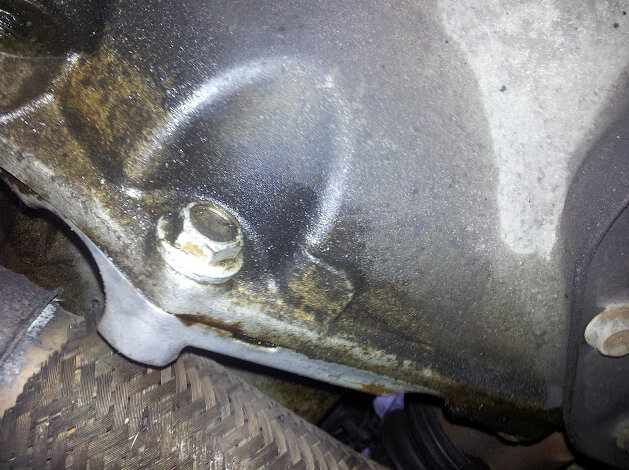

A common failure is the clutch slave cylinder failing. This can result in a lazy clutch pedal/ not returning fully to top and could cause a slipping clutch (burning smell).
See image below of a failed clutch slave cylinder.

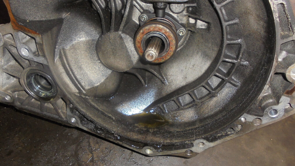

Often you can see an oil leak at the bottom of the transmission bell housing, you will need to look under the vehicle. see image 2.

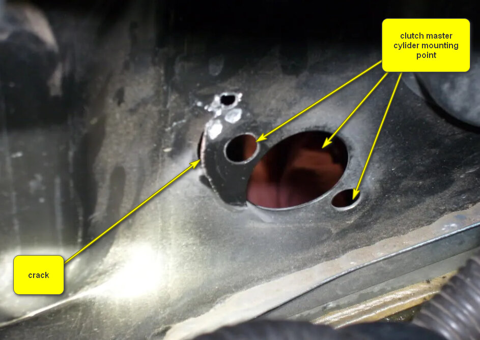

Your type of vehicle is not known to suffer from any issues relating to the bulkhead breaking. See example in image below.
It can affect some vehicles, and this could cause a soft/vague clutch pedal to feel as if the clutch master cylinder or clutch cable is mounted to the bulkhead. When pressing the clutch pedal this can then flex and not activate the clutch fully.

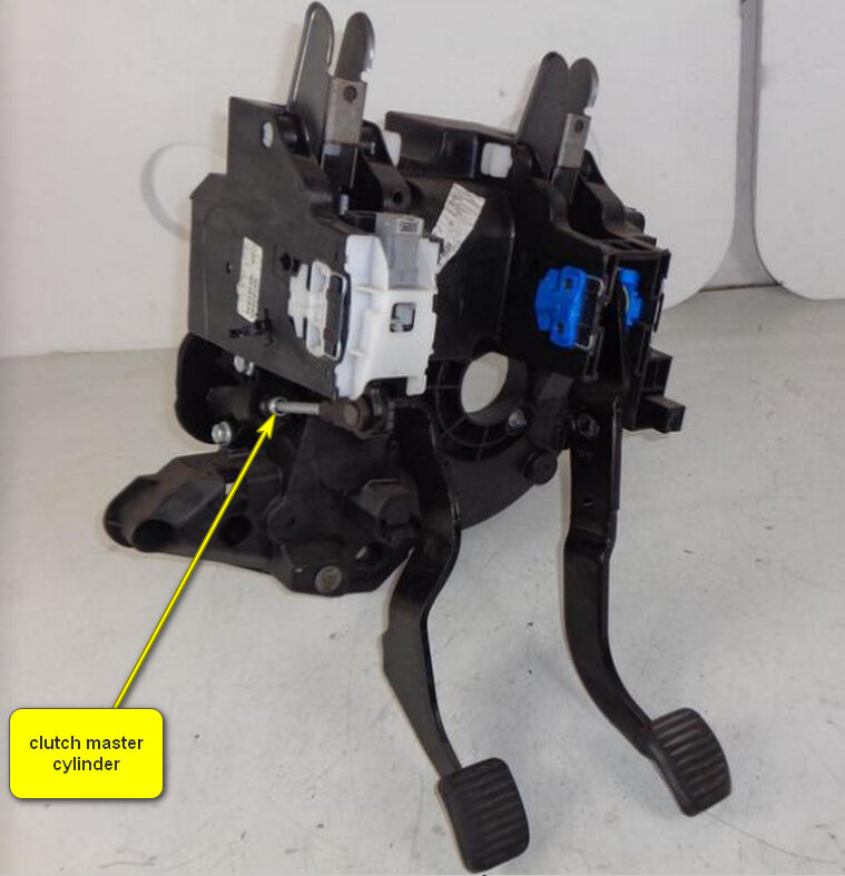

The clutch master cylinder on your vehicle is mounted directly to the clutch pedal assembly, see image 2 below.
